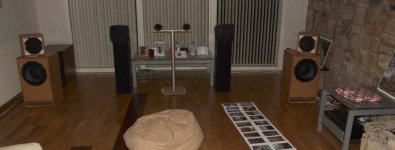

here is a picture of an early setup: the first one with the extra tweeters. Now the basses, seen here under the mids, are at +/-90 degrees against the walls, and the mids are on tall stands, farther apart than shown (the "amp rack" is now behind the right mid). The upper mids are also on stands (not old speakers as here) and the tweeter holder has been improved (they are now height-matched with the upper mids and mids). The listening-half of the room has more damping (sofas, bean-bags etc.), and the listening position = camera position, is far from the rear wall.
The main tapped horn subwoofer is off to the left and cannot be seen, the one in the left corner fills in some response holes. The basses are now at ear height, and overlap with the subs a bit, to even out modes. Everything is precisely time aligned.
I can't get a good picture of the final setup in 300kB, nor will I post one elsewhere.

While working on the cosmetics of the tweeter mount, I thought I'd try a 5 band OSD setup (I had an extra two channels of amp around, so only two cheapish vifa tweeters were needed to complete the system). It turns out that, as might have been expected, the difference from 4 band (details above) to 5 band is subtle.
I also re-optimised for 6m listening distance, and the angles etc. given here are for that new distance. (Mids and basses are closer, but delayed to give correct arrival times to within a couple of cm, and their amplitudes are reduced appropriately.) The longer distance gives a bigger sweet spot. The speakers are mostly close to walls (but with some care taken about reflections), so most of the room is free for other purposes.

The 4 tweeters are mounted on a baffle-board which is 135cm long by 12.5 cm high, supported on aluminium columns at its ends, the other speakers are on stands (or on the floor in the case of the subs).
