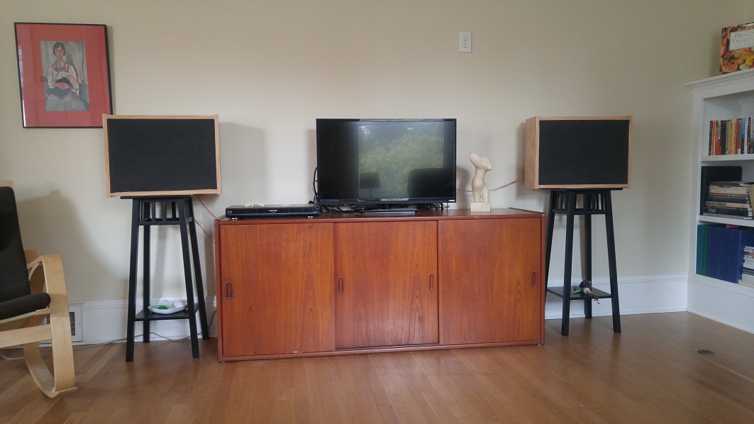

wesayso has done a LOT more on this than I have, I hadn't read about his experiences till now. My experiments have been very limited here and were only recently done, so count me as a rank beginner on ambience add-ons. I should try different bandwidths and spectral balances (though the little drivers I have aren't able do well very low.
My thinking on 2k-20k was that (at about 5db down) was what was needed to better balance out the in-room power response to the on-axis response. I'm still not sure that that makes physical/psychoacoustic sense -- does a significantly delayed (15msec) contribution to power response work similarly to one that isn't so delayed? Since you mostly hear the power response energy as delayed reflection or ambience, it would seem ok that way, but having only part of the spectrum so delayed seems maybe harder to justify.... And, as seems obvious to me at least, the direction that sound comes from is at least as significant as its spectral balance.
I also should set up some mixing so I can do L-R and R-L stuff to try, for now I just send Left to Left and Right to Right, though both are radiating in all directions across the front wall and ceiling. I have FIR in the DSP box, but haven't done any reverb stuff with it yet either. The question come up about what time-diffusion would be right to use, right now it still sounds like the same room, only deeper and livelier, but I don't what everything to sound like its in the same concert hall.
From my listening so far, I'm still very positive on the effects, particularly for this difficult little listening room. My friend (also named Bill) who came over yesterday also liked the sound in here better with the ambience speakers playing, though overall he preferred the downstairs system (with the larger 3D-printed synergy horns and diffusers). He said he'd like to hear the basement system with ambience tweeters added also (he liked the treble upstairs better, but the more full midrange downstairs better).
In the interest of keeping the footprint of the upstairs system minimal, I put together a little ICEpower stereo amplifier for the ambience speakers, small enough to hide behind the small 32inch flat TV in there. I'll post some pics on that (a 3D-printed case for it of course!) over on the Solid State forum. Funny, I have a stupid number of power amps here, just none that could be discretely hidden in here! Some wire dress still needed, but the overall visual impact of the ambient-enhanced system remains nice and understated --

I'm a bit surprised about the levels you use. If I recall correctly I'm down 10 to 12 dB from the mains. I've tried them a little louder but it gave me a 'wet' sound, of course my bandpass is completely different. As is the direction it comes from.
The level was first chosen because it was what was need to about square up the power response (which I'm still not sure makes sense). I think I like it that high, but it might seem a little wet (in this room, that seems like a good thing).
The level, btw, has to be measured with NO windowing since the ambient HF contribution comes well after the direct response and consists of a lot of energy in the room later than that. It's closer to about 10dB down (see Ambience tweeters using small BMR drivers) if measured only for the first 25msec....

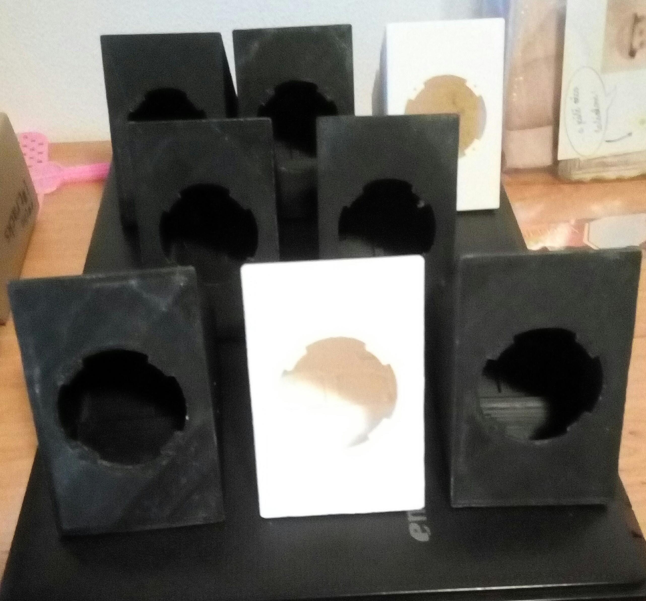

I printed up a set of enclosures for 8 BMR drivers to try downstairs but haven't gotten around to installing them yet. Maybe a project for this week (I'm a temporary bachelor while the wife is out of town visiting family and friends).
It is interesting how much reflections, even synthesized ones can open up the music, rather than muddy it. Wesayso has found that with his kickers.

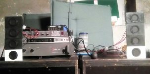

Have you made any changes to these? Are they still 5db down from the main signal? Might give this a try tonight with some spare drivers
I have the old non-HD minidsp 2x4 with a limit of 7.5msec (if I recall correctly) however I can run the ambient drivers several metres behind and above my couch. Hopefully that will do the trick. Will also play with the bandpass limits on both ends of the spectrum
I've got the delay up to about 25msec now (I think it was). Haven't measured the level in a while, set it by ear most recently. But probably still at about 5dB down I'd guess. When you measure the ambient level, you have to use a long window since the ambient arrivals will be spread out more in time than when you use the usual ~4msec window usually used in-room.
Well I didn’t have great success with this and probably due to the 7.5ms limit of the minidsp. I did try the haffler wiriing with a 200-3000hz bandpass filter and that has been the most successful ambience experiment so far. Amazingly effective!
I’ve ordered a minidsp HD and will try again with a 25msec delay
Cheers
Cheers
Sorry it didn't work for you frangus. Are you reflecting the NBR driver off the wall and ceiling too?
Bill, my testing was crude, using tiny speakers instead of BMR drivers. This and the fact that my minidsp is limited to 7.5ms is the issue I believe. I’ll do further testing once my new minidsp arrives and get back to you
Not really, the guy who printed them for me went out of material🙂 And the black is more like dark green, the phone camera is not the best.
When seeing the boxes in real life, I really appreciate the easy mounting. While stacking the boxes on top of another, I got a crazy idea of building a line array with these BMRs - and use 3D printed front baffle.
