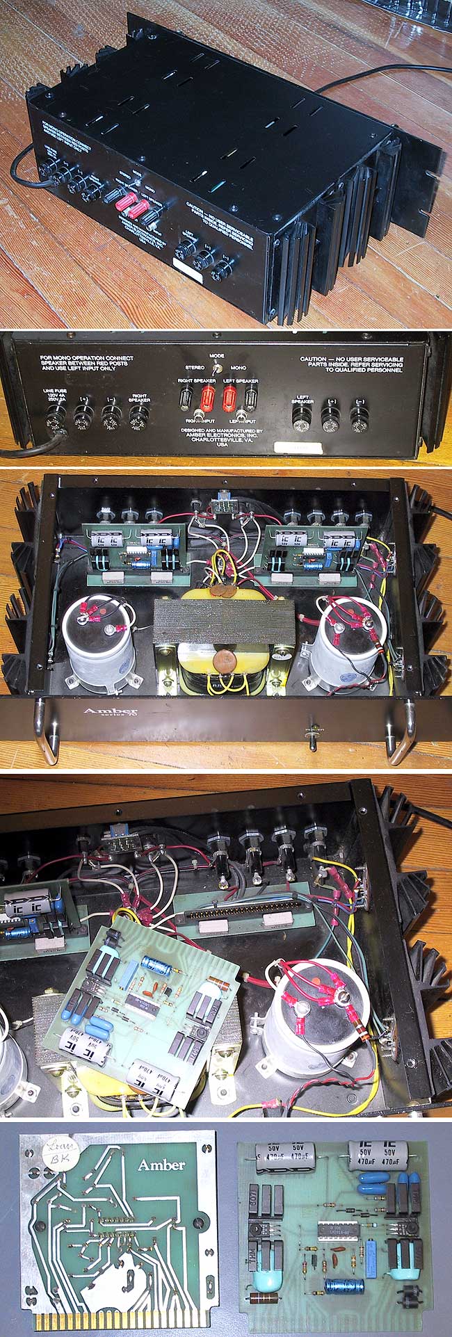

I happened to own one Stereo 70 with blown outputs and defective lm391n-100. had order ed 391n-100 on online store as well as the 2n5886 and 5884. I want to upgrade it since these one still don't have the zener reg for the chip. it was directly fed from the rails. Do you have the latest version of the schematics?
I do have the schematics and fortunately Amber never changed the reference designators on their circuit boards; as they had several iterations. Consequently, they never had to change their schematics much. Drop me a private note and I will send them to you along with a bias procedure. BTW, a lot of amps went out with 150 mA bias, as they were trying to run Class A over most of the output but it turned out the emitter resistors are a bit too small for that level of current. It is best to keep the bias current around 40 to 50 mA.
Yes, that is one of the intermediate boards - not the earliest and not the latest. The circuit however did not change. The changes were for manufacturing issues rather than sound quality. The four small silver capacitors should be replaced with newer polypropylene devices of the same value and the same or higher voltage. That black, 47 uFd non polar capacitor should be bypassed with a 5 uFd polypropylene device. All of the semiconductors should be replaced, including the output devices, and adjust the bias for 50 mA. This amplifier should operate again while sounding better than the original.

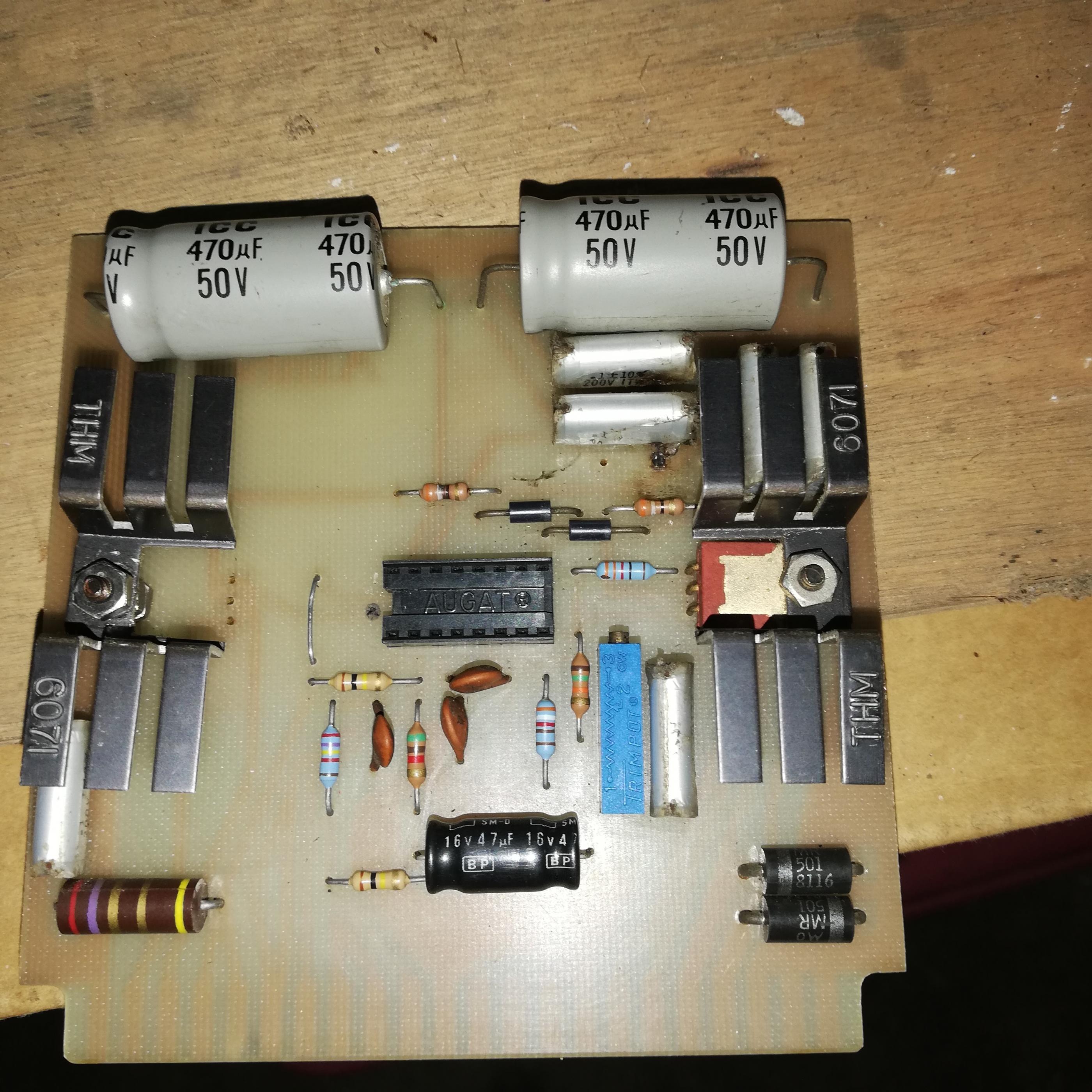

Yes I will try replace those caps even the electrolytics. The output transistor will still be the same but i have old MJ802/Mj4502 or 2N3773/2N6609 pairs to try.
Like the attached pic from net is what I have but different color. Grayish.
You won't need to replace the electrolytics, unless they are bad. The bipolar one could be replaced with a plastic one but the physical size makes this very impractical. Be very careful when swapping out driver transistors or output devices with other part numbers. It is easy to compromise the stability of the amplifier and there is no point in burning something up while trying to save a couple of dollars.
I had secured the original output trannies but the drivers I can't find here. I may try TIP41/42 instead or any TO-220 pair with close specs with the original.

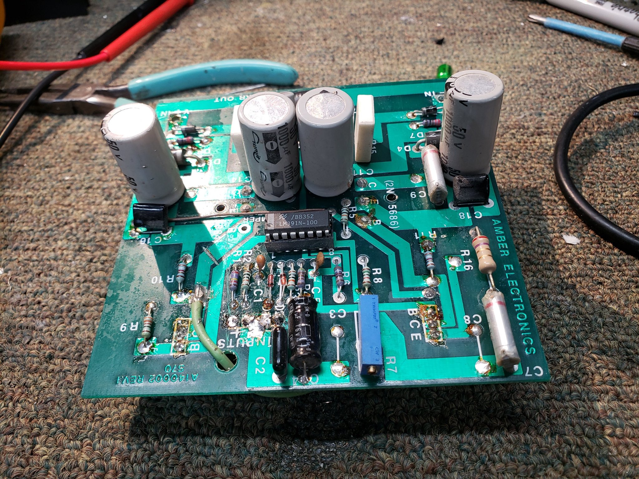

My Amber 70 was purchased new in Summit NJ in 1980/1 when I was at Bell Labs. It's been a champ, but now the right channel fuse is blowing. I can start replacing suspect parts (LM319 is a good candidate?), but further advice would sure help. I don't seem to have the level of privilege needed to privately message @SpatialKing - how to get in touch? I'm scnorth on gmail.
Hi last time i had conversation with him was thru email (March 2021). PM me i can give you his used last email address. he might help you.My Amber 70 was purchased new in Summit NJ in 1980/1 when I was at Bell Labs. It's been a champ, but now the right channel fuse is blowing. I can start replacing suspect parts (LM319 is a good candidate?), but further advice would sure help. I don't seem to have the level of privilege needed to privately message @SpatialKing - how to get in touch? I'm scnorth on gmail.
Now im in the process of rebuilding my AMBER series 70 with some mod by him. hopefully i can finished it this month. Busted output and missing Chip. Puchased chips and replaced . initial test was dc offset and it was very low. next is putting the output trannies and see if it will work.
This is not proper repair procedure. Replacing parts without evidence just injects more possible bad solder joints.. It's been a champ, but now the right channel fuse is blowing. I can start replacing suspect parts (LM319 is a good candidate?), but further advice would sure help.

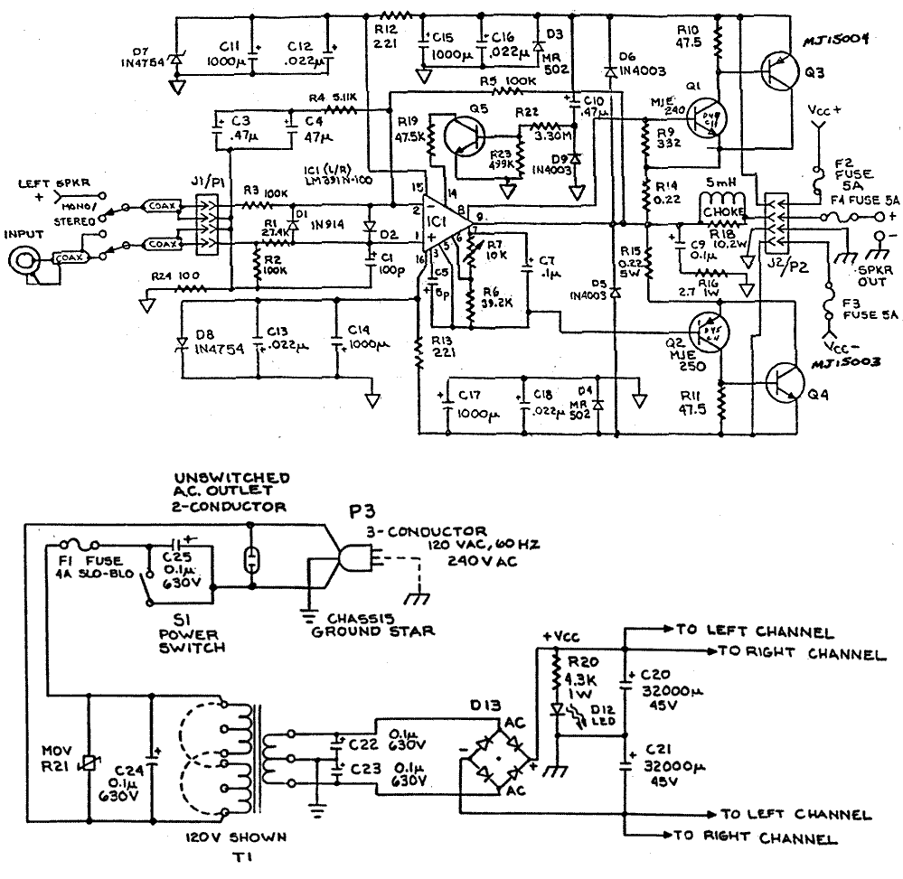

First one puts a 60 W incandescent light bulb series the AC input to the amp. Mine is in a grounded steel housing with power cord, NEMA 20a socket, input circuit breaker(mine is 5A), holes to see the bulb light up. Enclosure keeps you or worktable from being burned by flying mains wires. Lamp sockets are for solid 14 or 12 ga wire, and instrument wiring is stranded.
Then replace the fuse, Power up. If lamp stays on, fault is cause . Then you can take voltages to point out where the problem is. Connect the DVM meter black probe to the black speaker return socket on the bad channel with alligator clip lead. Do not use two hands to take voltage measurements, >24 volts from one hand to the other can stop the heart. Wear no jewelry on hands wrists or neck, 1 v at high amps through a ring can burn flesh to charcoal. Wear safety glasses or reading glasses, parts can explode and solder splashes.
On bad channel I'd start by looking at Emitter to .22 ohm resistor on drivers Q1 Q2, versus center (speaker ground) voltage. Taking base voltages too, you can subtract B & E voltages to make sure they are 0.6 and -0.6 .
I disrespect previous advice to leave electrolytic caps alone, and replace the transistors without testing. I find 50 year old transistors to be pretty reliable unless overheated by dirty heat sink or abuse or speaker wire has been shorted. I find rubber sealed electrolytic caps at 50 years to be mostly trash. WIth only 4 or 10 e-caps it is not worth investing in a $120 ESR meter to test them. Besides ESR test is at 6 v and caps can leak a lot worse at 30 or 50 volts than they do at 6 volts.
I disrespect previous poster who replaced MJ240/250 with TIP41c/42c. MJ240/250 are (probably) 30-40 mhz FT parts. I replaced 50 mhz FT 2n5020/22 with TIP41c/42c and sound was dull and lifeless. Bad highs. If one can't find mj240/250 and they are defective, use MJE340/350.
