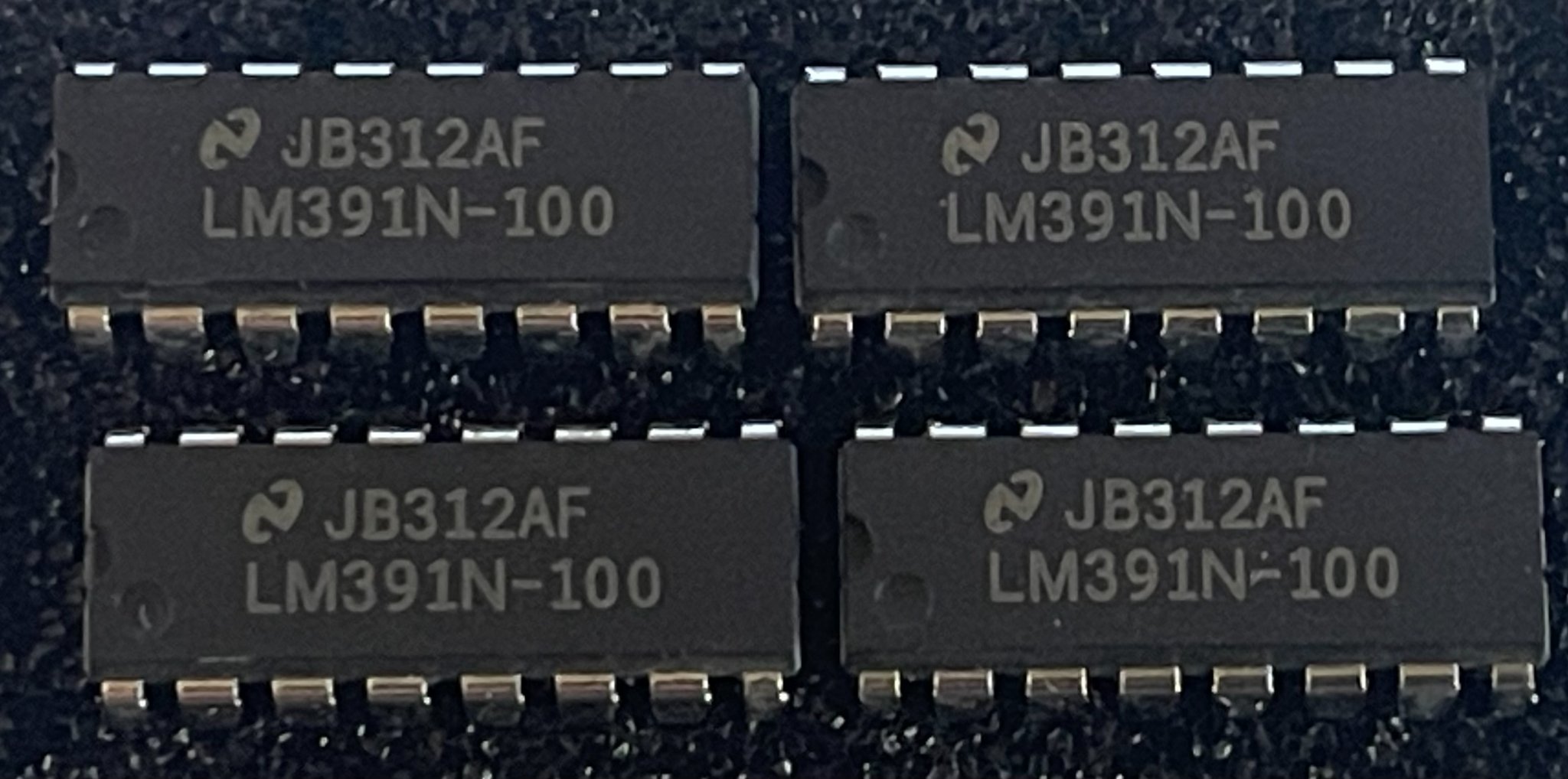

I've been lurking for a while and haven't posted here. I have two early Amber stereo 70s (black with rack mount handles) that are great. I'd like to use them in mono configuration with my Acoustat Spectra 44s, but one only works in stereo. From what I've read it could be as simple a fix as using deoxit on the stereo/ mono switch, which I'll do. The Spectra 44s are a difficult load and I don't want to stress the amps.

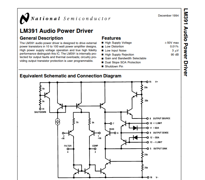

So...I'm looking for good LM391-100 or 391-90 drivers and an actual manual (Hifi Engine show that there is one, but it's not actually there). The schematic seems to be available. Does anyone out there have experience with Chinese made 391s? I'm a bit dubious.

They are all just voltage grades. You might get lucky and have a -60 that will take 100 volts. Or not. The -90 was never offered by NS originally. Only 60 and 80 initially, and then later the 100. Any -90 would have been from some second source. Or a re-marked -80. NTE has never been trustworthy….
The circuit is relatively simple and can be duplicated with discretes. But to get close to original performance, several pairs need to be well matched. Monolithic dies do this for you, which is why these chips work so well.

High impedances never hurt anything. Low ones do, and bridging is effectively a low impedance. The danger of low impedances is that output transistor failure can take part of the driver circuit with it. If that’s an LM391, you’re in a pickle.
