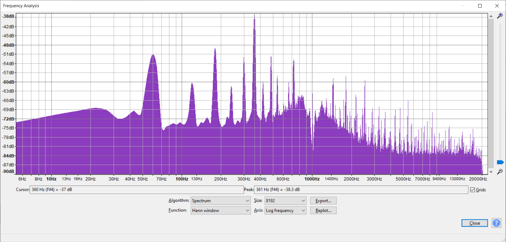

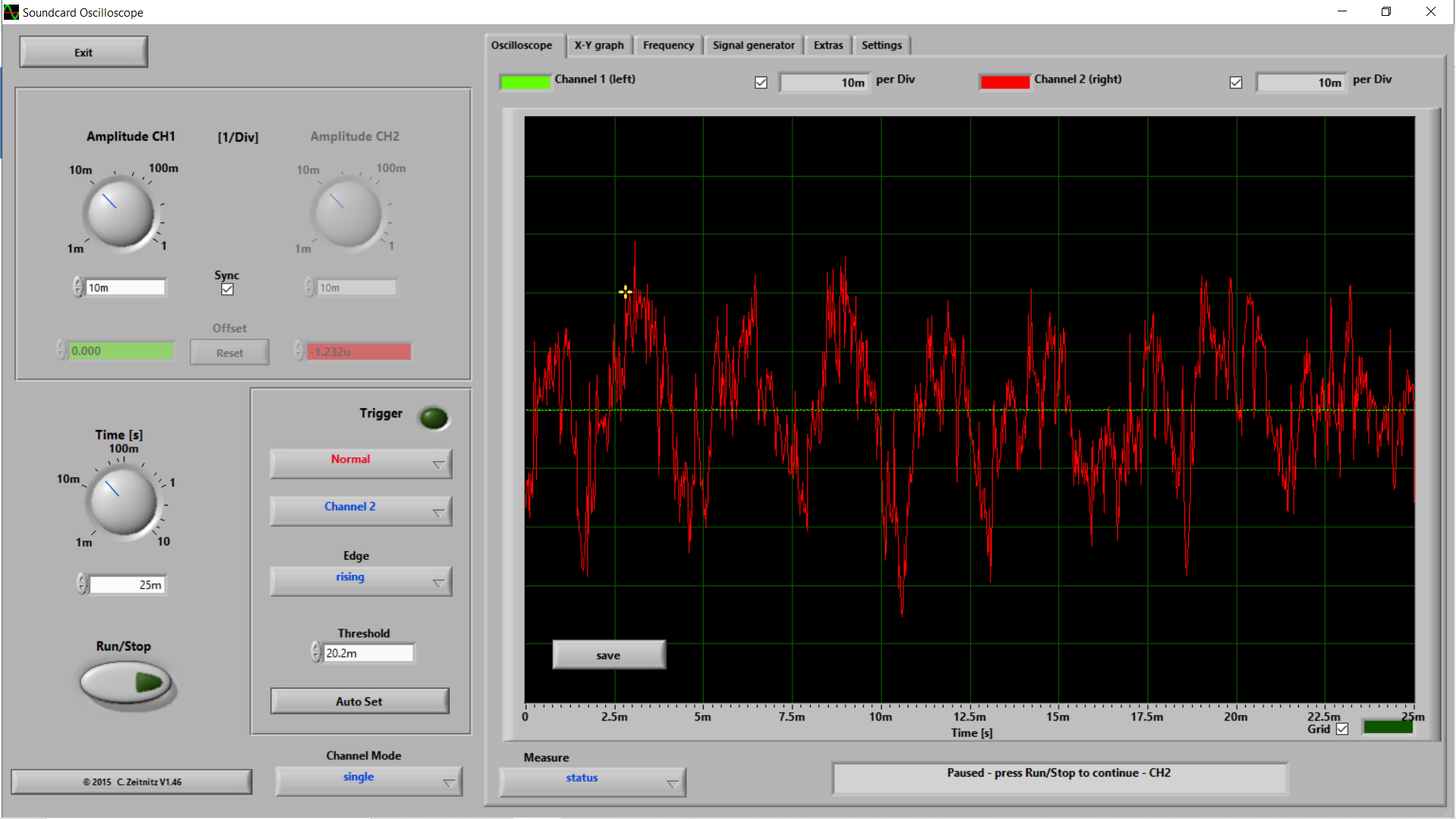

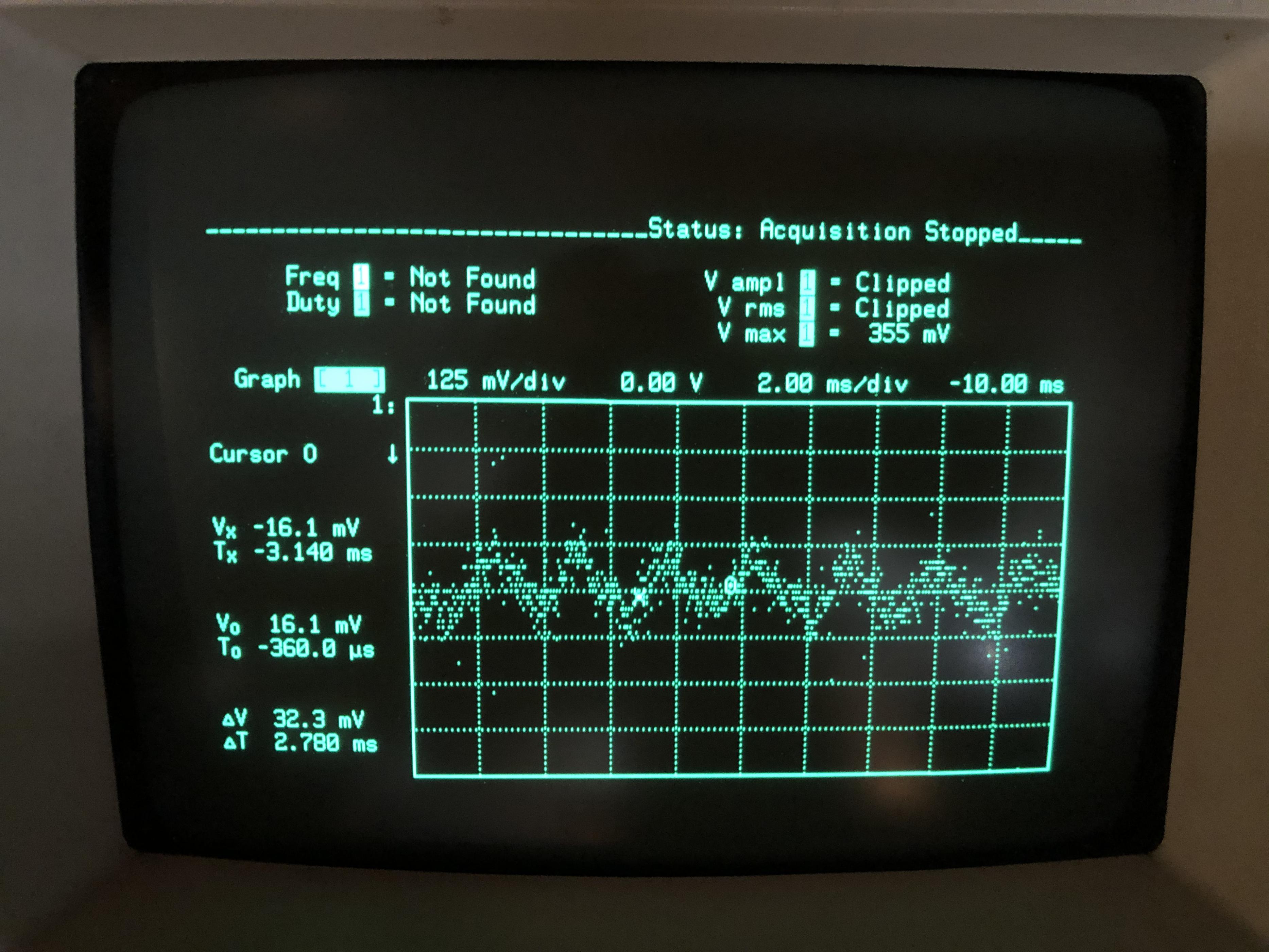

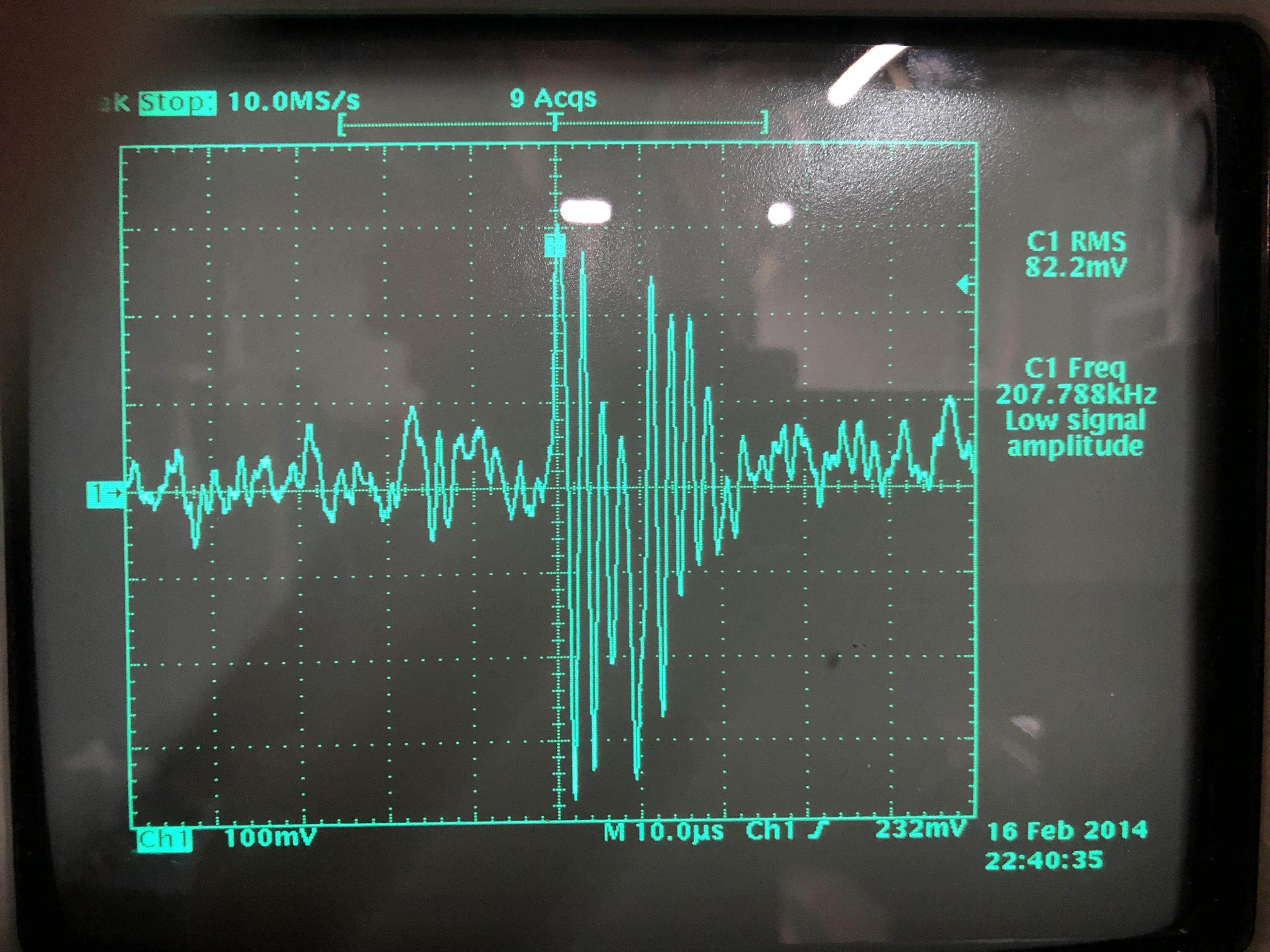

Thanks for the help. This is a 1v signal at 1Khz with the monitor output fed into my HP 54200A scope which has been getting a bit flakey lately so I'm not putting a lot of faith into it. It looks like some spurious HF noise riding but again its not to be trusted. Next up I fed the monitor into a USB sound card and found an oscilloscope program. Lastly I recorded a few seconds with Audacity and did an FFT on the sample. It looks like the noise peaks at 360Hz? Generating a signal with the sound card reads a steady 0.04% on the Amber so it looks like only the really low readings are fluctuating.

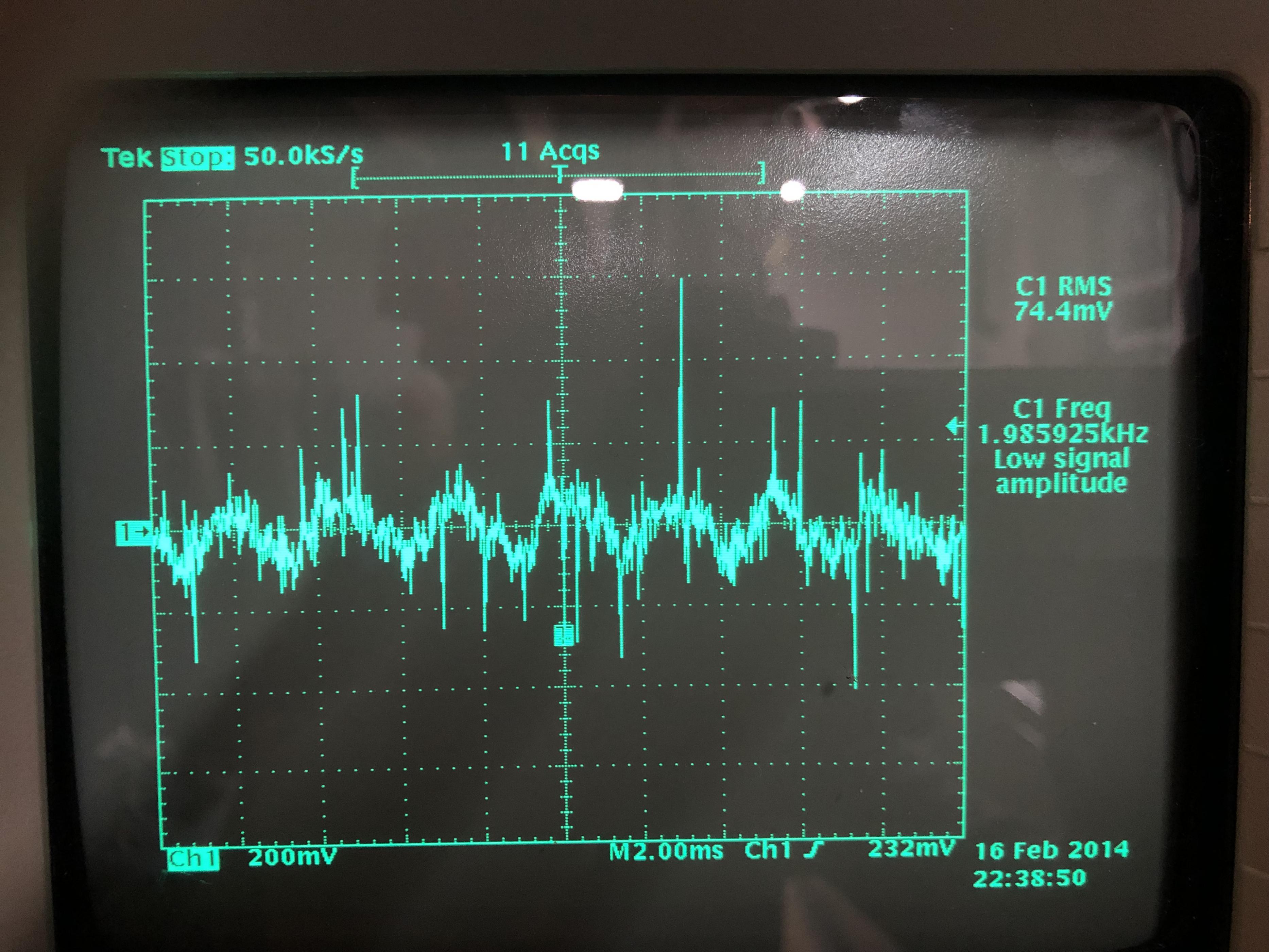

My old scope developed issues and a friend was nice enough to gift me an upgrade so here is the monitor out when looking at a 1Khz signal. The second pic is zoomed in on the spikes riding on the residual, which reads 360-400Hz. Perhaps the compensation on an opamp has gone wrong?

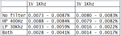

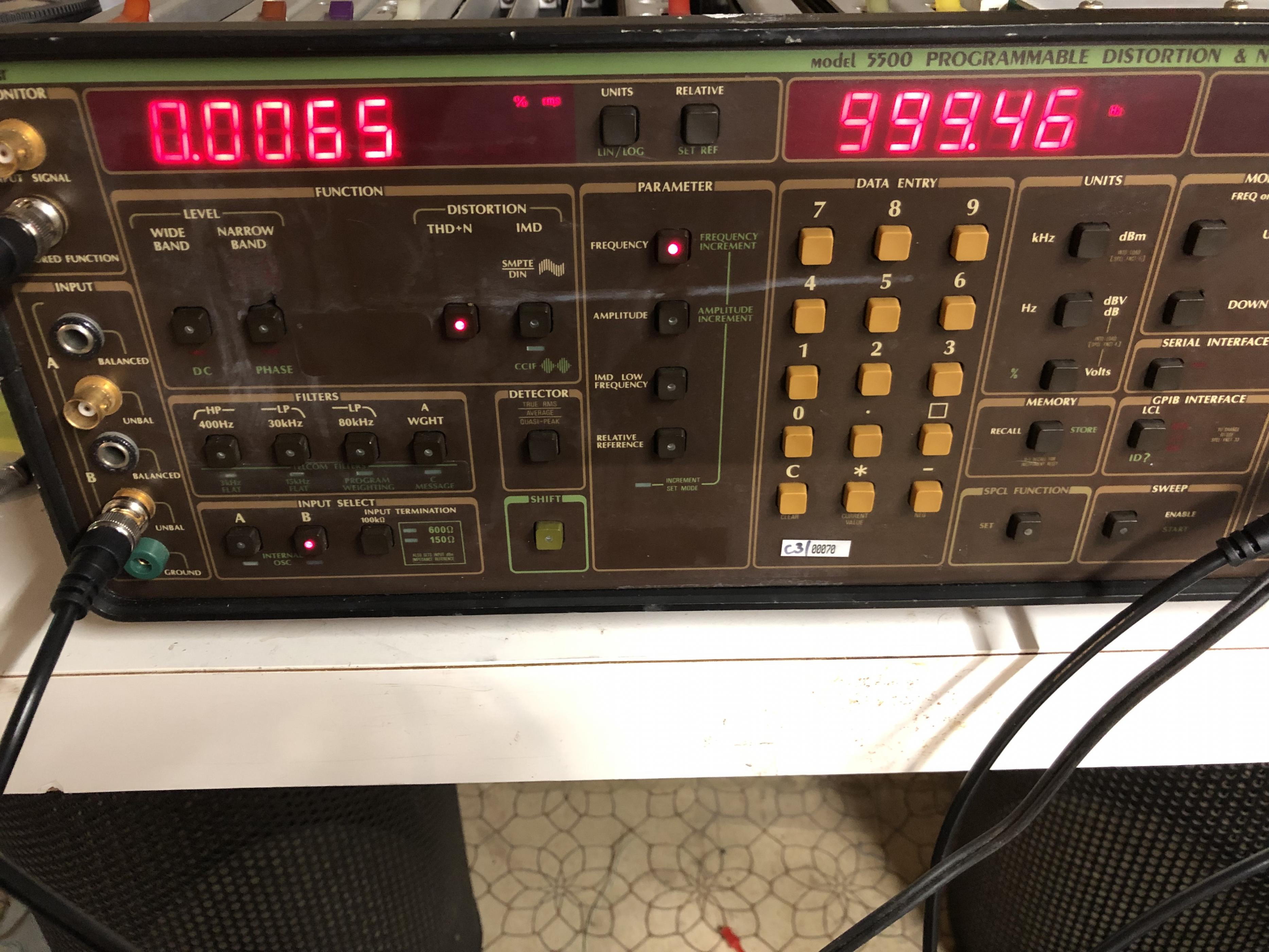

Alright a half hour warm up and SPCL 24 calibration reveals the following numbers. They always fluctuate a bit so here are the typical ranges. Thanks for mentioning the filters. I never played with them much and they do quiet down the fluctuations. Is that typical or should they be steady?
Model 5500-14000 which means it has the high voltage output option and telecom filters. All the readings were taken single ended.

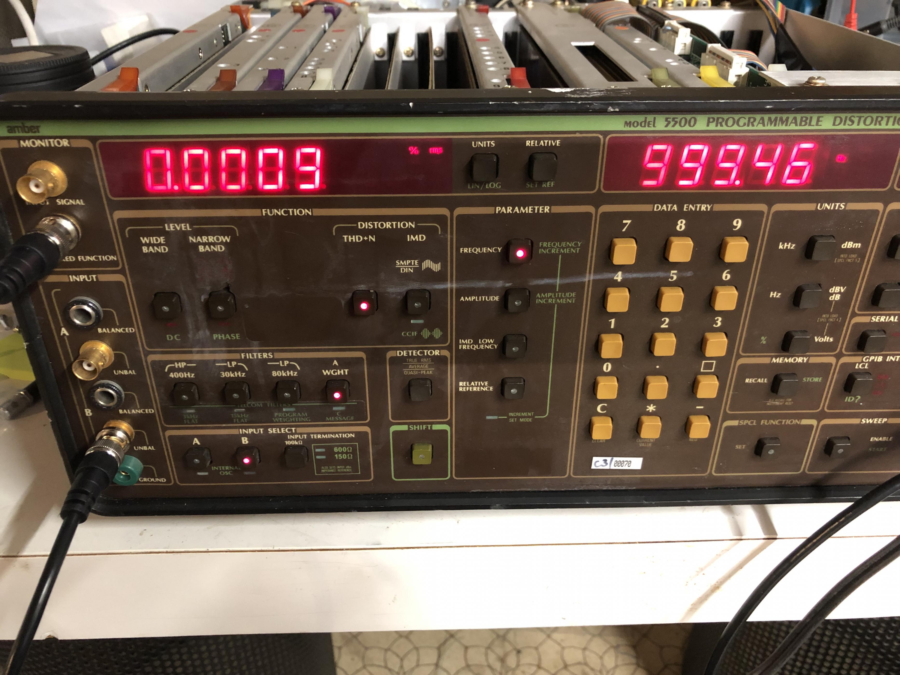

First pic is unbalanced and no filters. Second is with the A weighting filter enabled.
Side note, if you press Shift + A or Shift + B you put the instrument input in an internal loop with the generator. You won’t need a cable to connect the input with the output, the loop is in balanced mode, the best of all worlds for estimating the 5500 intrinsic performance.
I dusted mine, re-adjusted and got 0.0009% @1KHz @3V in 30KHz BW, 0.0012% in 80KHz BW and 0.0006% in A weighted. But I replaced long time ago (where possible) a bunch of NE5532’s inside with LM49710’s.
