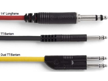

Also this unit has an oddball 1/4" connector set up for Western electric plugs with a small diameter tip and the normal plugs don't fit. I think a Neutrik connector would fit the PCB but have not tried.

IIRC the balanced plugs are bantams, I have used regular 1/4" mono iirc they worked okay.

The 1/4" stereo works fine on the input jack but does not connect at all on the output (PC mount) jack. I have not seen the bantam name in many years which is why I did not remember it. The 3501 is a really nice small unit and can give exceptional performance. this one doesn't quite make it to .001% and it has a "match" where the H2 of the generator syncs perfectly with the H2 of the analyzer. However both are wrong. It would be fun to dig deeper but I have another Shibasoku coming and just don't need another project. . .

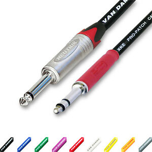

There's 1/4" telco plugs and a smaller size for dense jackfields. I think "bantam" is less than 1/4".
The true telco 1/4 has different tip profile than Switchcraft low-price 1/4", but they often inter-plug OK.

This unit has a connector by ADC that is specific to the "longframe" in the picture. The last step in the molding is smaller as are the leaf setup. There is no way a normal connector would fit. I'm waiting for a connector to help retrofit a battery and when that arrives I'll open it all up and attempt replacing the connector if I have an alternative that will fit.
The particular jack in this Amber was made by ADC and they don't seem to make them anymore. The last step is molded to the smaller size. I got some new jacks but they have a different footprint entirely and will not fit.
