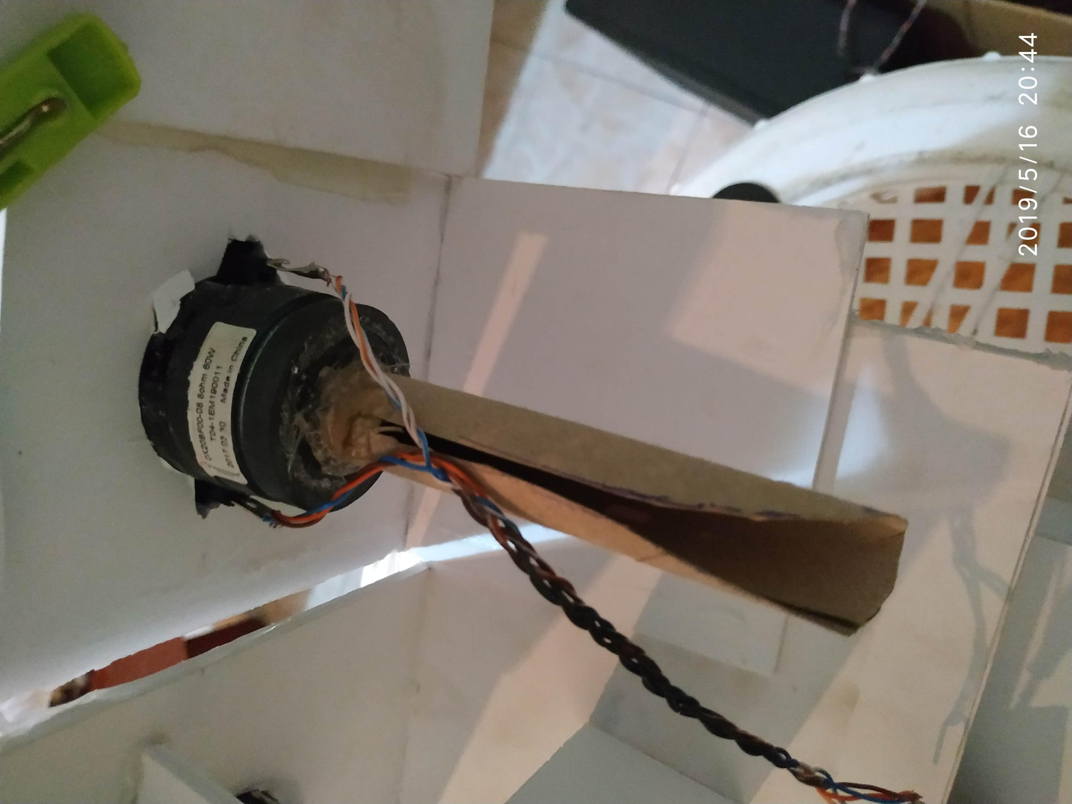

Then I wondered if I could turn my dome tweeter into a dipole so I got out my box cutter and pried of the back of my tweeter. I took out some acoustic foam and was left with a nice round hole. I hooked it up to the amp and was pleasantly surprised. After some listening I decided I didn't really like the sound that came out of the back so I got another idea.
I made a small slotted Karlson pipe and stuck it in the back of the tweeter with some hot glue. This made it sound a lot more balanced. When I A/B test the original and the modified tweeter in small test baffles the sound quality is really day and night. It sounds like a way more expensive tweeter! It has air, detail, realism, depth....
I am a happy camper. I turned my cheap Peerless DX20BF tweeters into something that sounds like it belongs in another league. I acan't wait to to try it with a peerless ring radiator tweeter.....
I don't know if the mod is that easy with other tweeters. But with this Peerless the back comes off in just a few second. Super easy mod and reversible I you don't like the result.

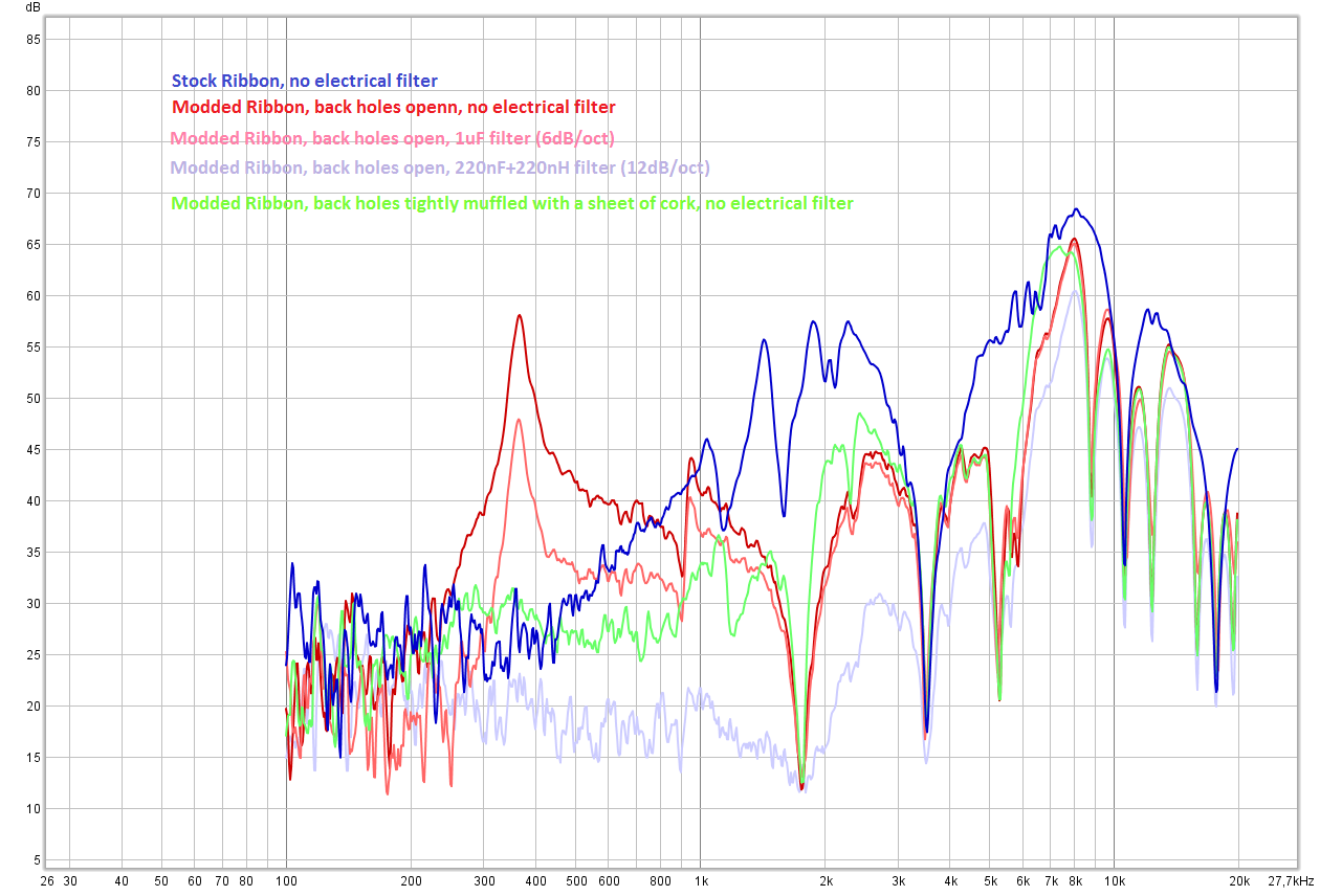

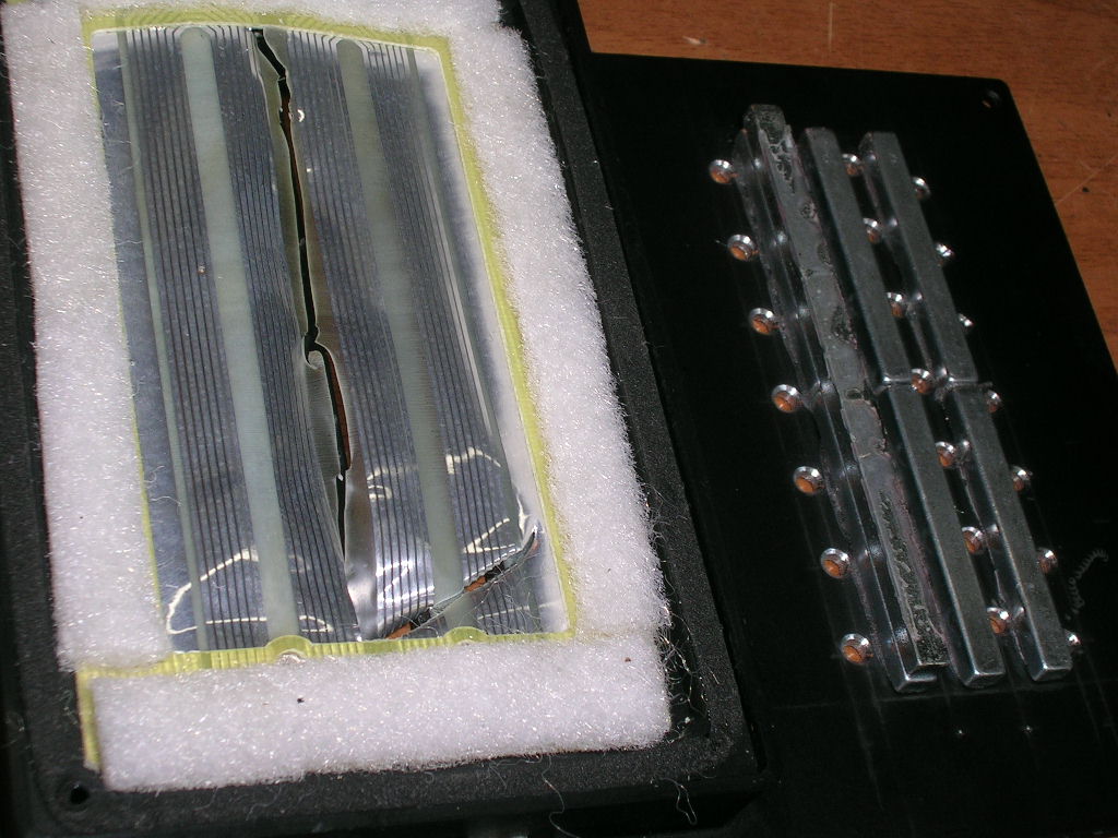

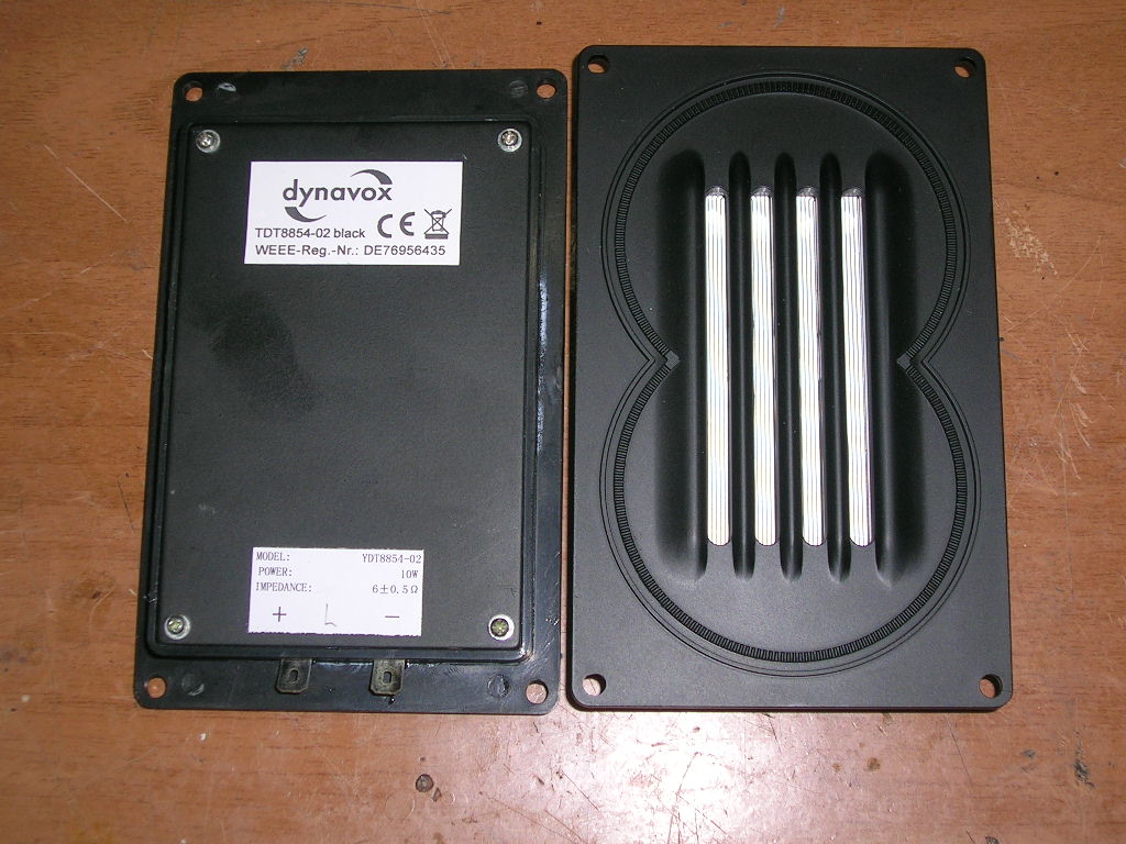

A couple of observations:
1) the Tymphany compression drivers play much lower than you would expect. I took mine apart, and it appears that the tweeter may be ported.
2) with 3D printing becoming more common every day, it's just a matter of time until people start putting tweeters in transmission lines to eke out some additional response on the low end.
Agree. I modified for OB use but I think if you glue a piece of PVC pipe to the back, fill it with acoustic fiber and close the end it will also work well. Not only extending low end but making the top end sound better.
