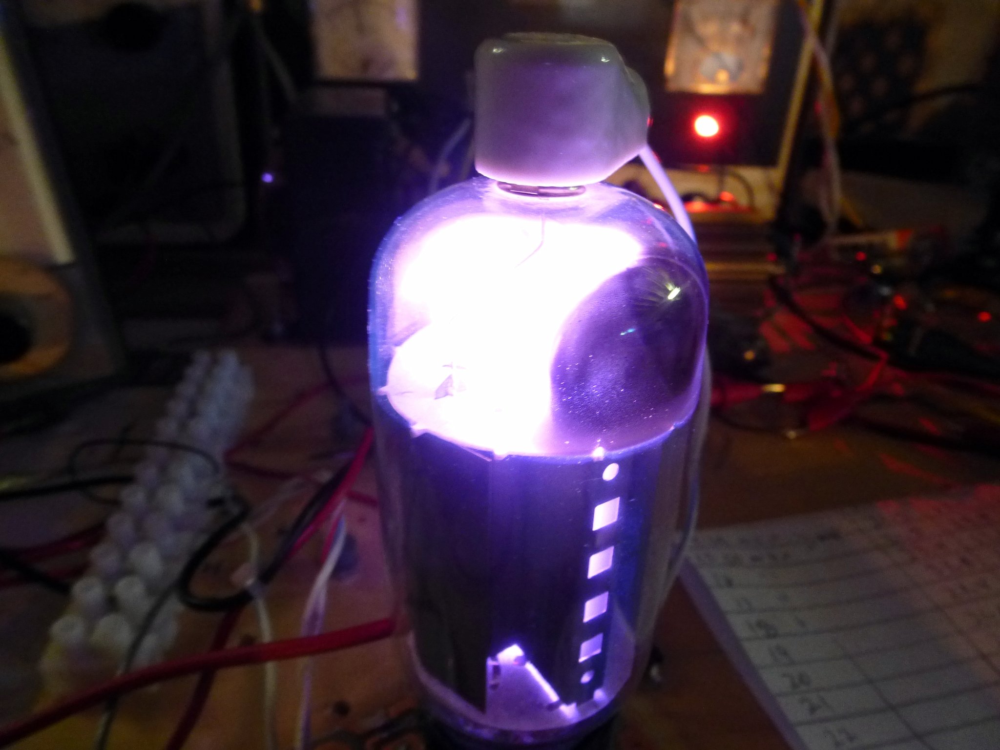

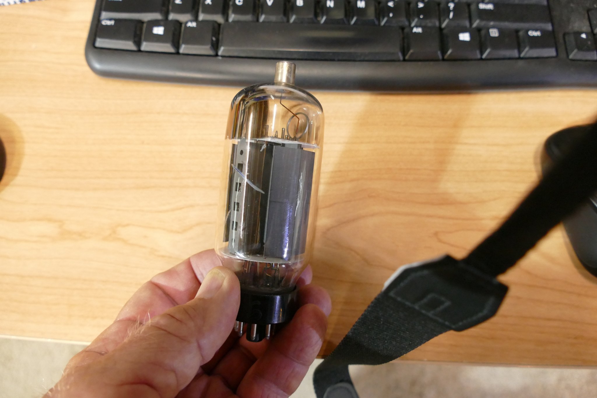

The purple / pink glow does suggest an air leak. The getter may look good for some time after the leak started depending on how thick it was deposited at the original burn. and how hard the tube was run since it was built. I have a large sweep tube that developed a small crack, but still worked for a few weeks. Then it started to glow inside. The glow got worse and the amp began to distort badly. I pulled the tube tortured it a bit just for fun to get the pictures, then set it on a shelf several years ago. It took several months before the getter showed any sign of trouble. Now 6 years later one of the two getters is nearly gone, but the other still looks normal.
Try another tube if you have one.
The first picture is from 6 years ago. The second picture is the same tube 6 minutes ago. The getter on the back side is nearly gone but the one on the front would still pass for good and this tube spent nearly 2 years running over spec in a class A SE amp before it failed.
