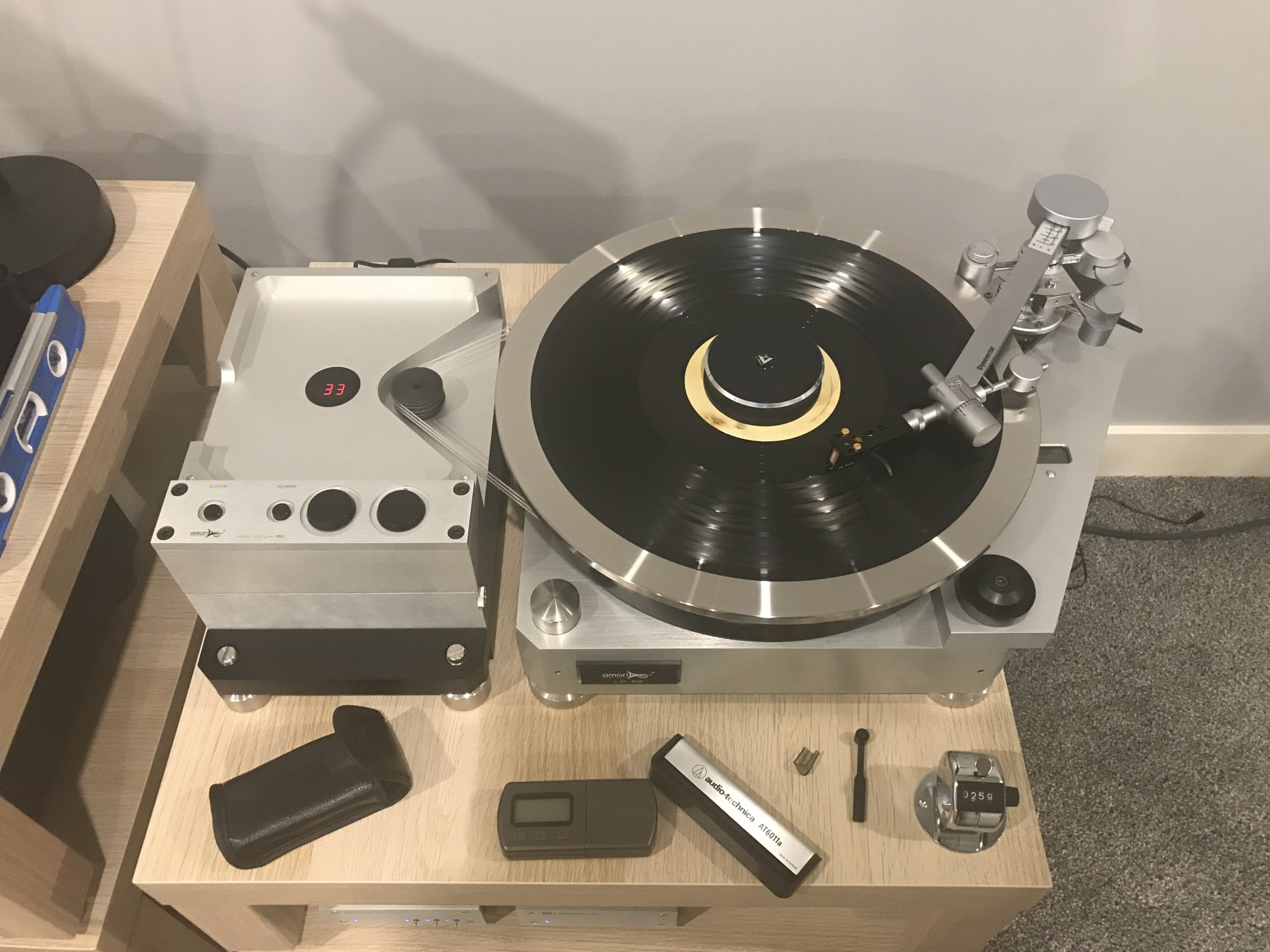

Hello all,
I have an Amari LP-82 turntable, it is basically an Micro- Seiki RX5000 clone. I’m finding it difficult to get the exact 33.33rpm when using the fine speed adjustment. Does anyone have a suggestion for replacement speed Potentiometers that would make fine tuning the speed a little easier?
Thanks in advance

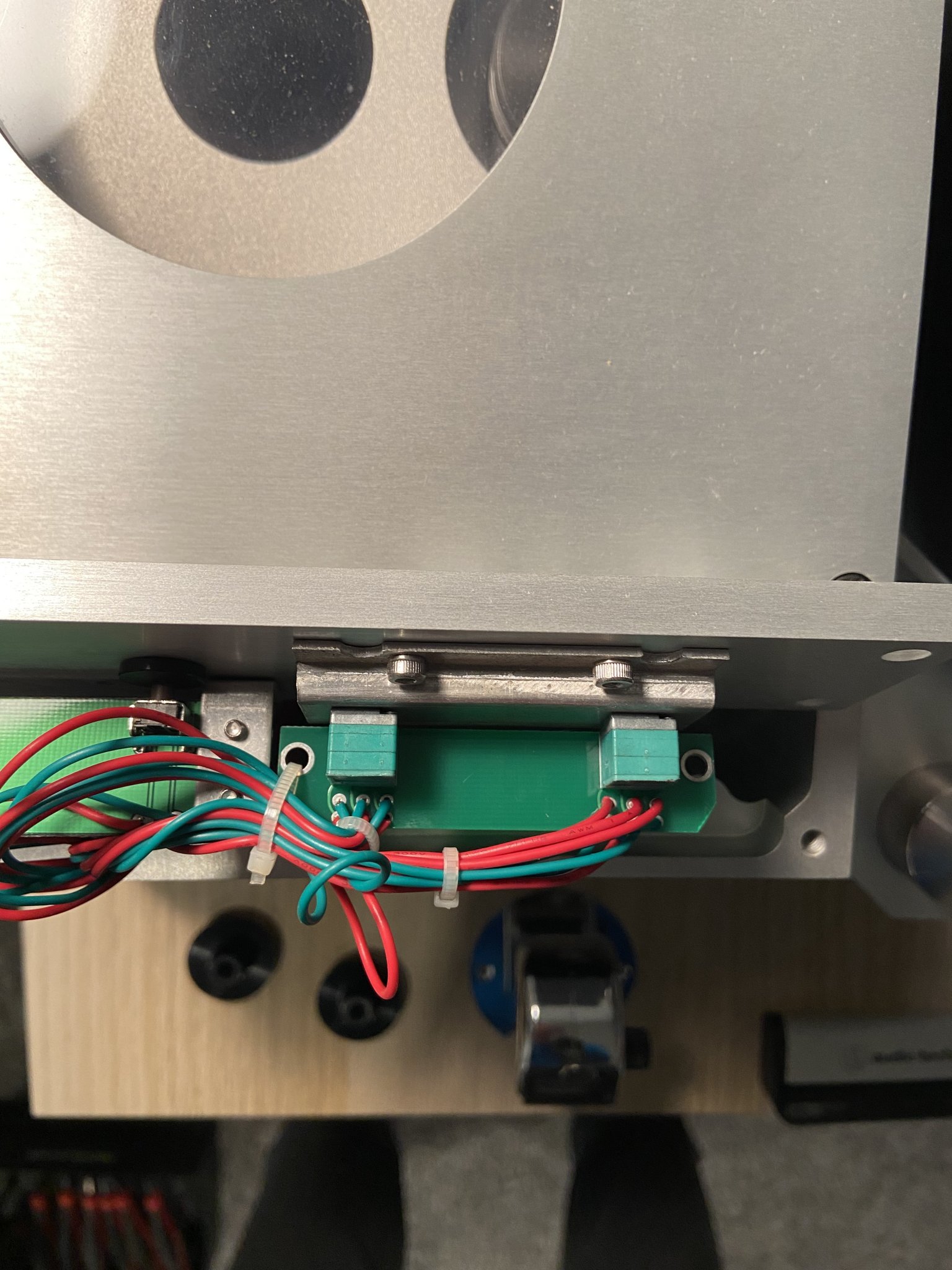

Many thanks for the reply, I took off the cover to have a look at the pots, they are B50k and measure 9x11x24 mm. Can you recommend a suitable replacement that would be easier to achieve the required speed?
I replaced them with TKD 2CP 601 pots, they are a direct replacement, the shaft is longer so you will need to replace the knobs. It is still tricky to get the speed bang on, but the speed is much more stable. Do yourself a favour and replace the drive belt with a length of silk thread, that helps with speed stability and weirdly sounds better.
Here is where I got the pots from: https://www.hificollective.co.uk/catalog/2cp601-dual-taper-potentiometer-p-8595.html
