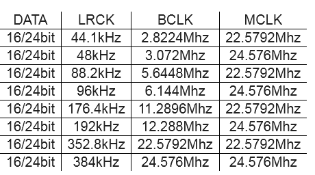

The DIYINHK boards will hit 49Mhz for MCLK. Not so sure the kosher Amanero will. The knock-offs might but I wouldn't know.
See extract from the Iancanada board manual below.

MCLK
Hmm, thanks for this.
You have re0iterated what Ian said, and lets face it, he would know !!!
The only thing I thought strange was, that I could have sworn I used a DIYINHK board of the Spec'n shown in the attachment and it worked.
Their 768 pcb does indeed O/P 49 MHz (approx) MCLK but I don't think it was this type of PCB I used.
I will have to check more thoroughly.
Thanks anyway.
