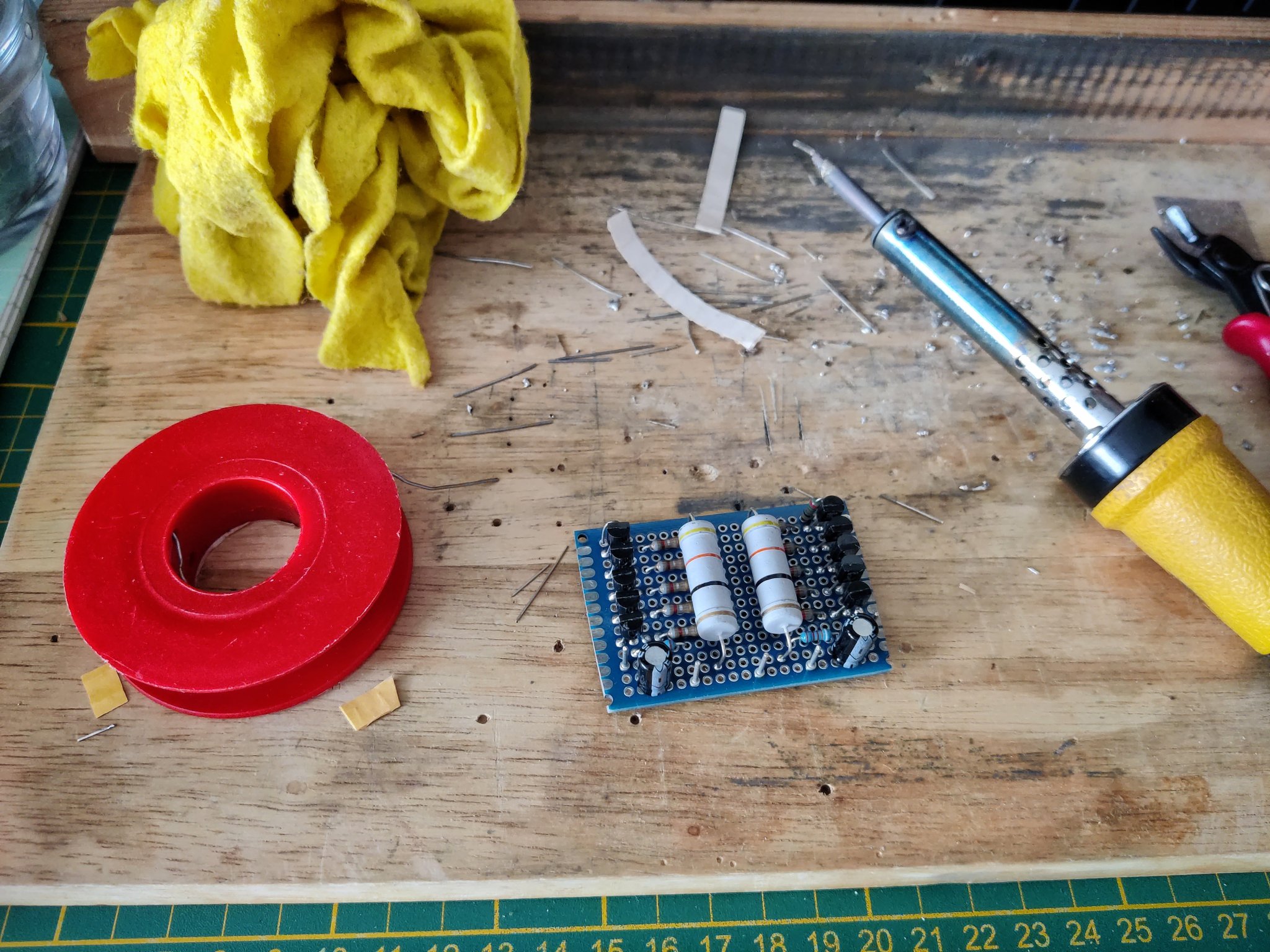

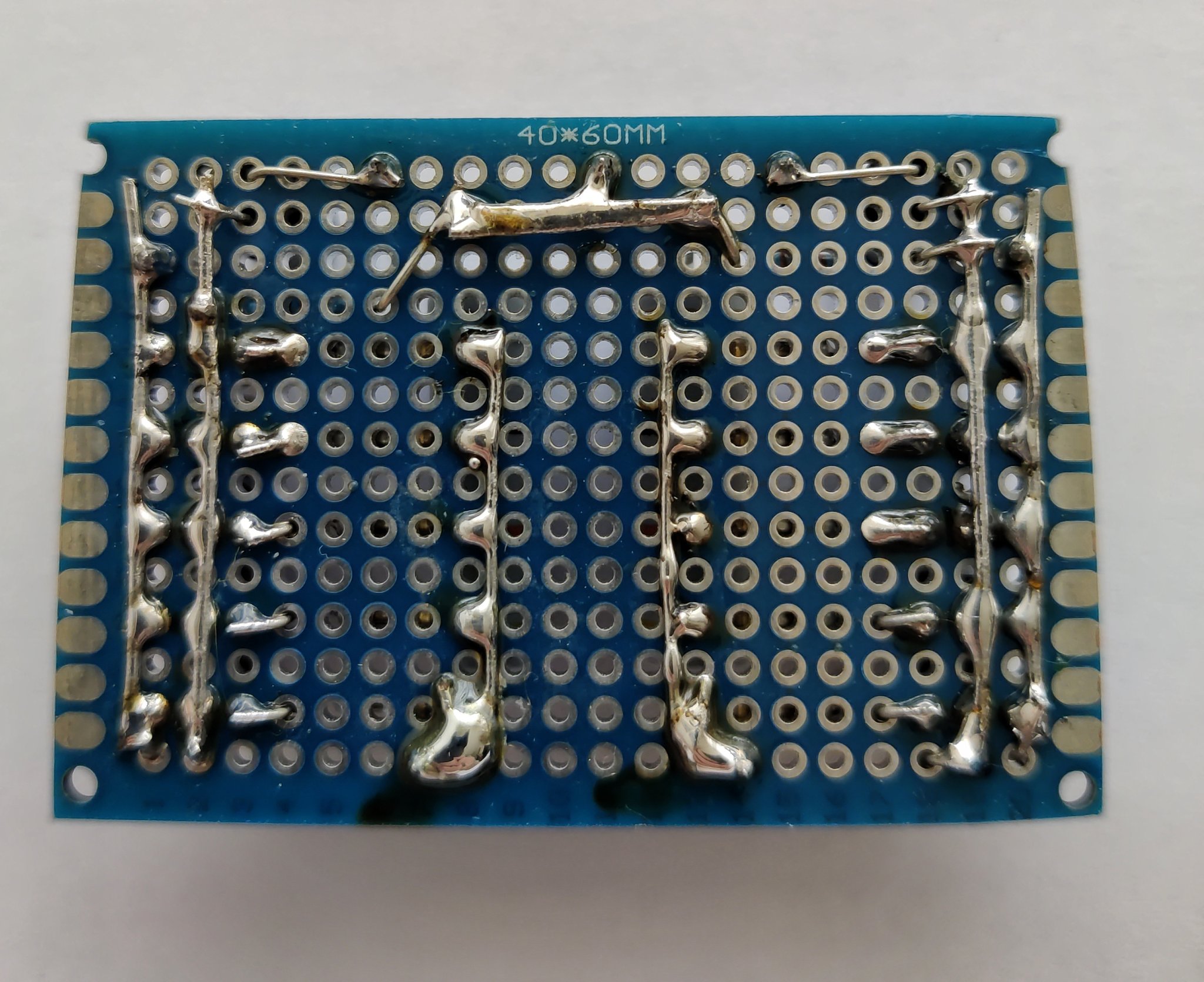

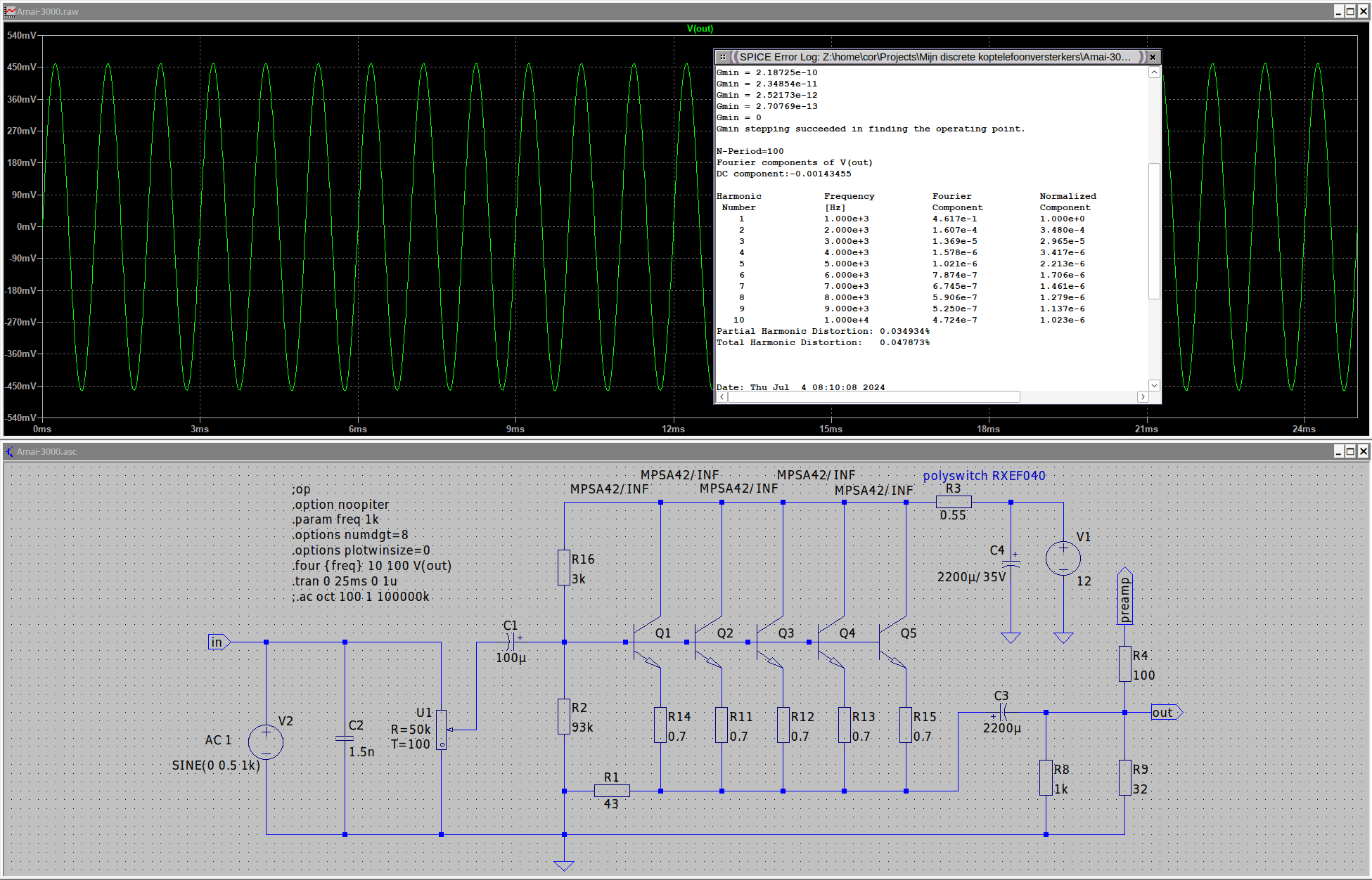

The adagium of an old Dutch technical oriented audio magazine 'Audio & Techniek' was 'less is more'. More components in an audio circuit will not benefit the sound quality. Food for discussion I am sure but I believe it to a certain extent. So the thought popped in my head why I would need a voltage amplifier stage in a headphone amplifier when the DAC delivers enough voltage? Why not try to make a frontend for the USB DAC to plug the headphones in, a current buffer? I did and it turned out to be a fun experiment using the cheapest components I could find. It is suited for headphones with an impedance of 32 to about 80 ohms.
The circuit is a 136 mA biased, class A current buffer that consists of 5 paralleled TO-92 transistors per channel. Perhaps there is some benefit in using paralled transistors, I do not know, you tell me. I have a lot of them, ordered from beyond for a low price.
The frequency range runs to 3 Mhz before it begins to drop off. If necessary it can be limited to 80 kHz by using a 15 nF capacitor to ground right after the input capacitor. In my case that was not needed, but see my comment further on.

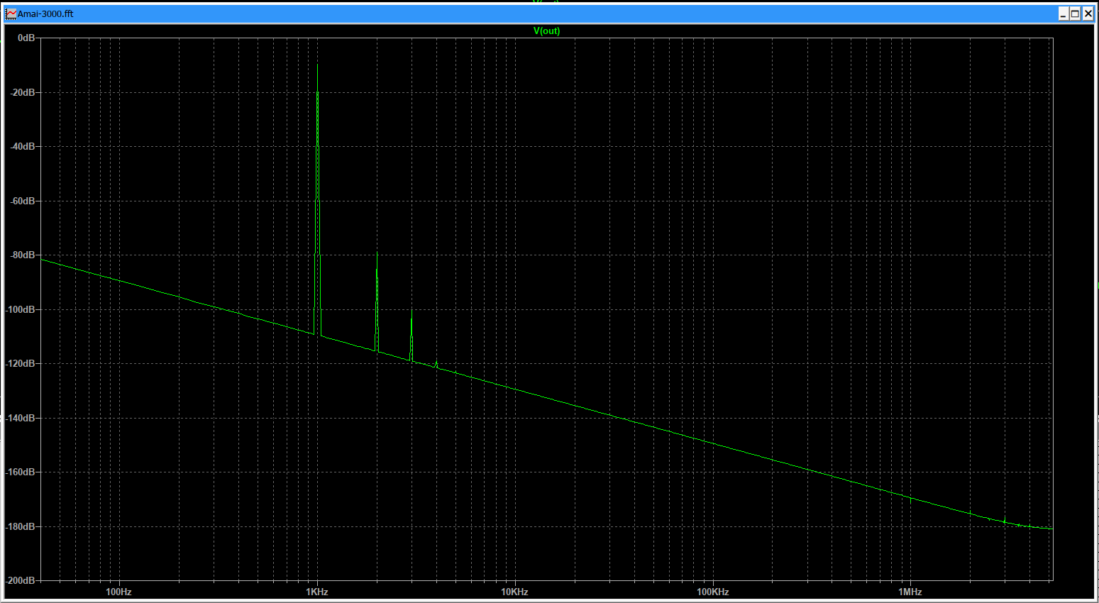

According to LTSpice it produces nice harmonics, especially the 2nd one stands out. The distortion is not too low, about 0.03% in 32 ohm and 0.01% in 80 ohm, what is to be expected for a simple circuit like this. If it sounds right I will very soon forget that number, the former is what matters to me most.

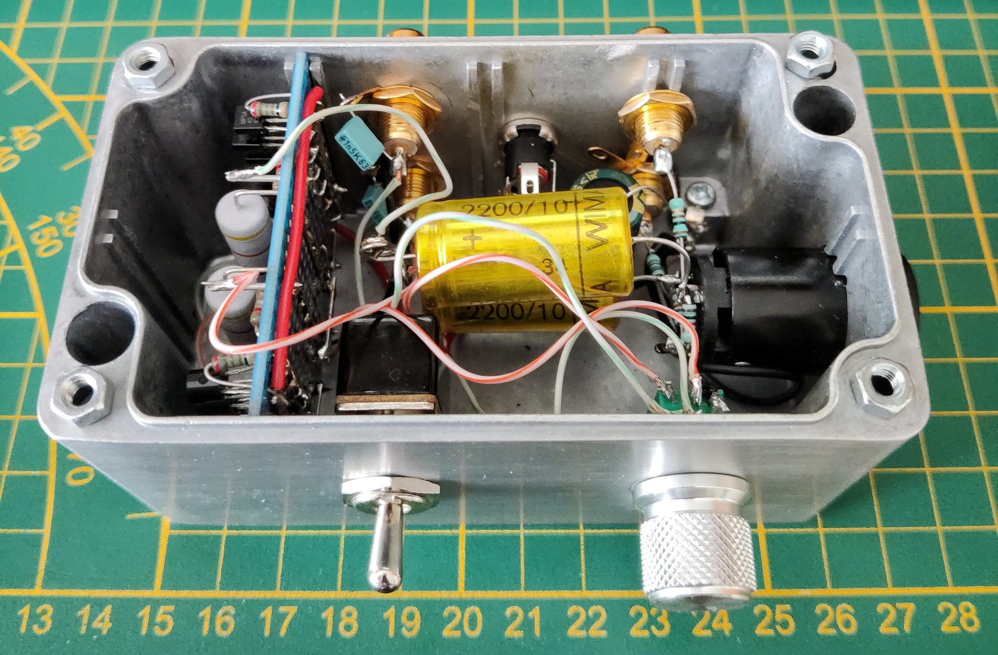

As a first (endurance) test I left the circuit on for more than 10 hours to see if the cheap components would last; of course they did otherwise you would not be able to read this 🙂 I will see on the long term...

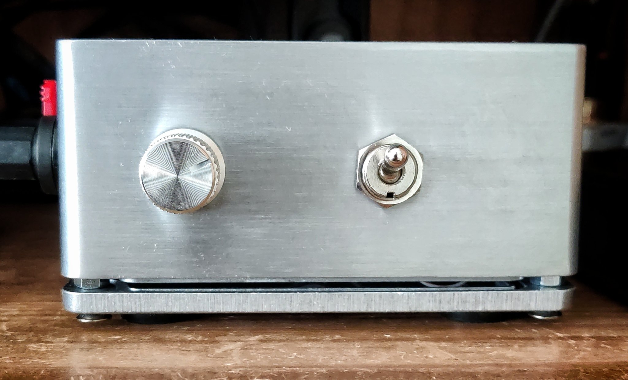

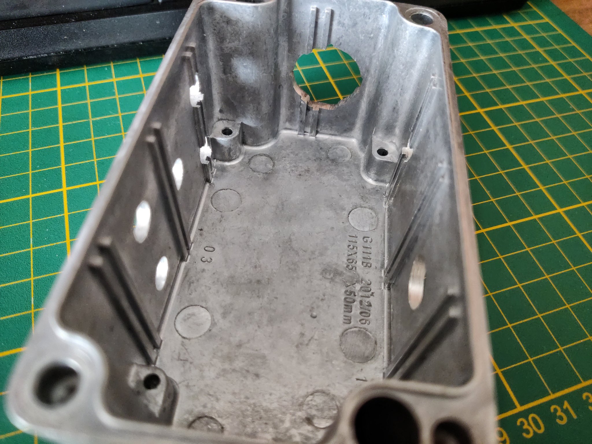

Reading many threads (not only on this forum) and looking at all these expensive oversized fancy pancy amplifiers in the shops you would believe that the bigger the enclosure, the better the sound 😉 Why not use an enclosure of 5 x 6.5 x 11.5 cm (https://www.gainta.com/en/g111.html) I thought. That may be to the other extreme, using an undersized box like that, but I like puzzles. To let the heat escape and to avoid drilling more holes I lifted the cover of the case a bit by using 4 extra bolts thereby creating an opening around the case.
Btw, before I used WD40 as a lubricant while drilling holes in the aluminium, but a trick that I read elsewhere that I wanted to test is to use hand cream. That worked even better than WD40 and it smells nice too but opinions may vary. There is nothing like the smell of WD40 in the morning, that's why afterwards I treated the aluminium with WD40 to protect it, not to protect it but for the smell.
Oh, and another thing: after finishing it there was a slight hum that varied with the volume. At maximum volume the hum dissappeared. This may very well have to do with oscillation in combination with the power supply, as another post suggested. Replacing the power supply helped to solve that, although I also suspect that limiting the bandwidth by using a 15 nF capacitor to ground right after the input capacitor might as well be a solution.
No real correlation - large circuits can be good or bad, small circuits can be good or bad, very small circuits will be constrained in performance by a lack of degrees of freedom - once a feedback loop is involved the quality is strongly determined by the maths of the feedback, if adding more components gives you more linear open-loop performance and or more open loop gain, or more stability, add them!
Another area where more components might be good is adding protection circuitry - one day you'll be grateful...
Compare to optical lens design - trying to make a high performance wide-range zoom lens from only a couple of bits of glass is doomed, not enough degrees of freedom to cancel out optical distortions. And you also have to add all the lens coatings to reduce reflections - so more is good, definitely.
