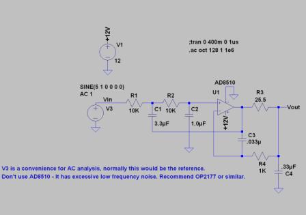

Take a look at the LT1019 series of references, they are very quiet and also extremely stable. Note that you can also use active LPF (sallen key ) after the reference if you need/want something even quieter - just be certain to use small resistors <1K set corner below 100Hz and make sure that the op-amp you use is <10nVrtHz and also low noise below 10Hz, like say op2177arm.. I use a 3rd order filter implementation with the final filter pole in the ouput and use a lag compensation network to set the op-amp dominant pole somewhat below the output pole. Very quiet and commonly used in ATE applications where we need very quiet dc for testing A/D and D/A chips.
I can post further details if anyone is interested...
Kevin
Kevin
Please post schematic. I am interested in learning how you implemented the filter.

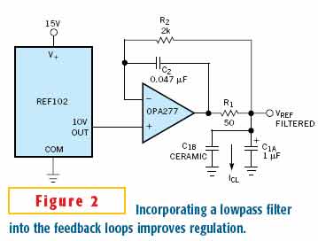

Ron Mancini of TI discussed this in the Nov 25 2004 issue of EDN (methinks he would prefer you use Burr Brown OpAmps and References 🙂 )kevinkr said:Take a look at the LT1019 series of references, they are very quiet and also extremely stable. Note that you can also use active LPF (sallen key ) after the reference if you need/want something even quieter - just be certain to use small resistors <1K set corner below 100Hz and make sure that the op-amp you use is <10nVrtHz and also low noise below 10Hz, like say op2177arm.. I use a 3rd order filter implementation with the final filter pole in the ouput and use a lag compensation network to set the op-amp dominant pole somewhat below the output pole. Very quiet and commonly used in ATE applications where we need very quiet dc for testing A/D and D/A chips.
Kevin
Here's another article on the TL431 from the folks at TI -- it follows another discussion in Switching Power Magazine last year which discussed methods of compensation:
http://www.edn.com/contents/images/091505di.pdf (go to page 5 of the PDF)

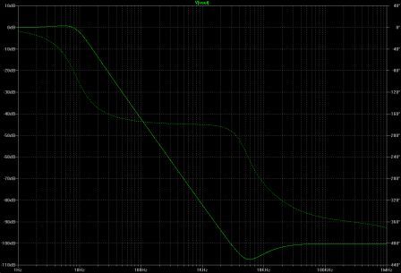

kevinkr said:Hi,
This circuit is quite similar to what I have been using and works well.
It is a little more complicated than that shown above but provides noise attenuation from 10Hz on up.
Kevin
Hi
Allright, thanks
Looks good, but still for LF the noise is unattenuated. Won't hurt for most applications, but for oscillators it is vital.......
best

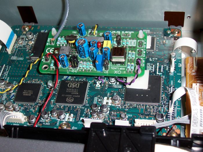

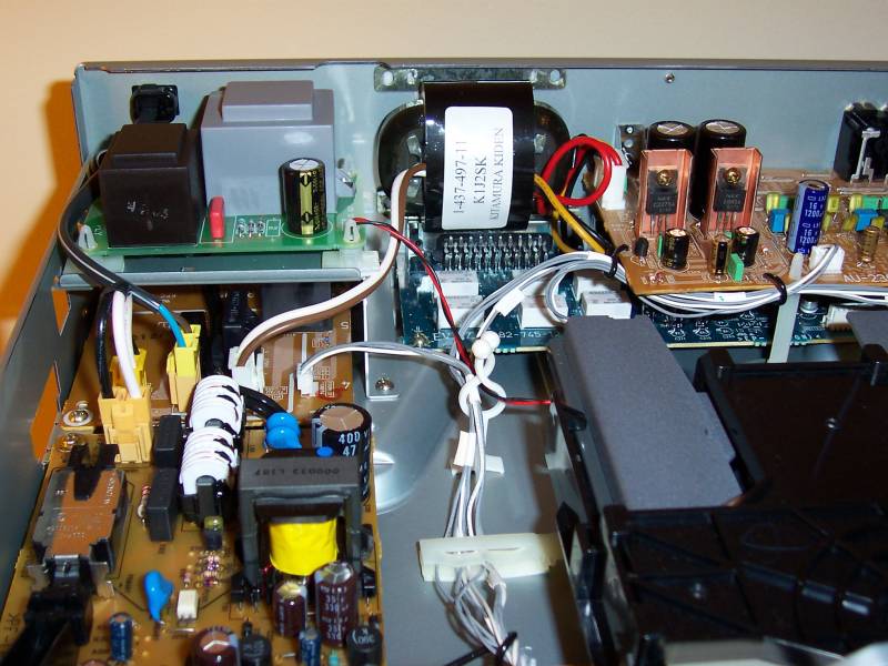

What about a CRC before the reg, on the unregulated PSU?
Guido sells an optional (L+C) unregulated PSU for his clocks.
Here it is, on the top left corner.
This is a Sony DVP-NS900V I modded for a friend.
I had to change the BG cap, otherwise the PSU didn't fit inside the player.

Kevin -- could you post a pic with a clearer view of the axes (or just email me jack@tech-diy.com)
