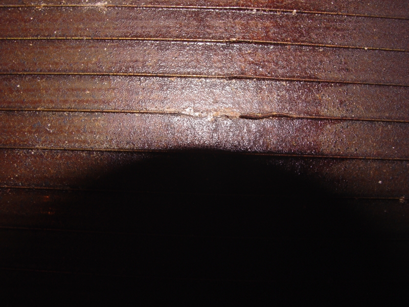

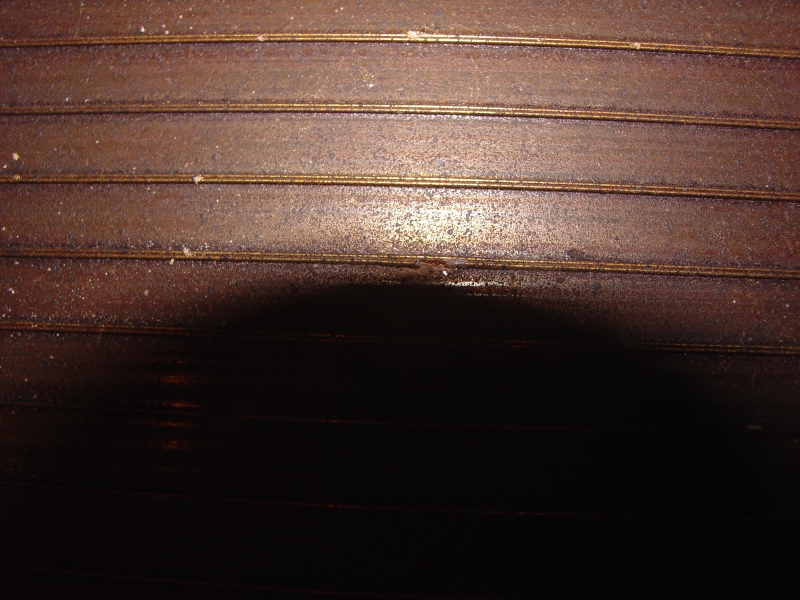

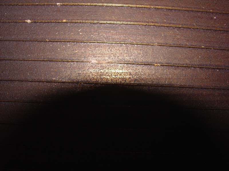

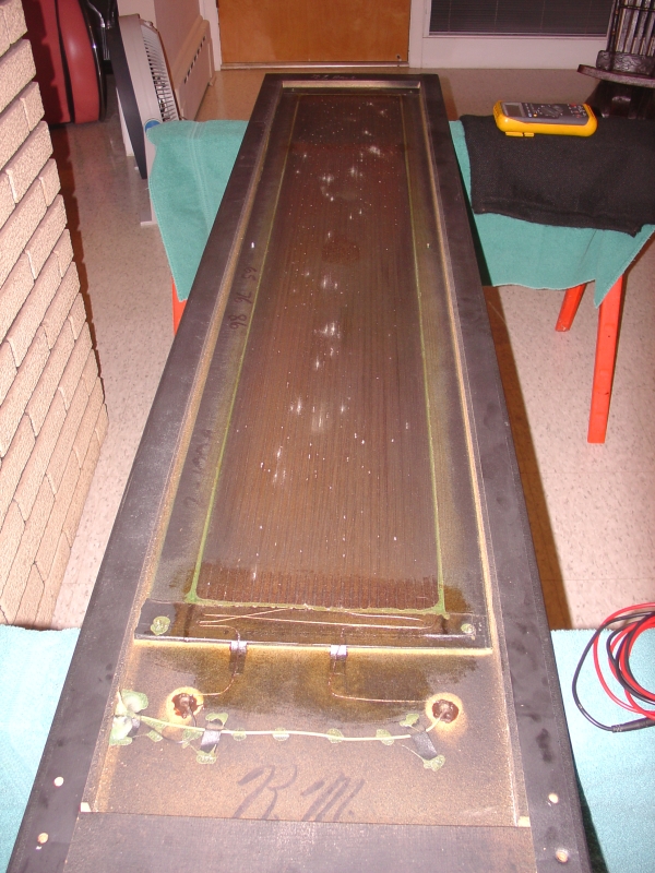

I need help to locate a retail source for alum. magnet wire.
Time to make new coils for my Magnepan T-1D's and 1-B bass panels.

Have you tried Magnepan? If a Google search doesn't turn up something, you could try to find a local transformer winding or repair company. Many of the manufacturers will send samples if requested.
Yes, Magnepan will sell kits to rebuild them. $50.00 per kit (2 panels per kit). For me this means 8 panels (4@ T-1D and 4@ T-1B) + $475.00 ea for the tweeter panels.
So I still would like to locate a source to buy the wire on a commercial spool instead of the "custom you just get enough so do not screw it up" Magnepan kit!
I will check several motor rewind shops (indeed I used to work for one 25+ years ago).

23-22awg. I do not yet know what the tweeter wire ga. is.
I may convert to Cu wire but will need to calc. the differences in resistivity and mass so as to not disturb the panel tuning (natural panel freq.).
But, the simplest is of course to replace same with ......
I do not yet know what the tweeter wire ga is.
I suspect T-1 tweeter wires are the same wires used with other models (and my IIIa mids) - 31g. But Magnepan will tell you, if you ask them.
I would suggest you should not change to Cu wire as it will:
a) have a much lower resistance than the same length of same-guage Al wire ... and this change in resistance will change the XO frequency, and
b) will be heavier.
