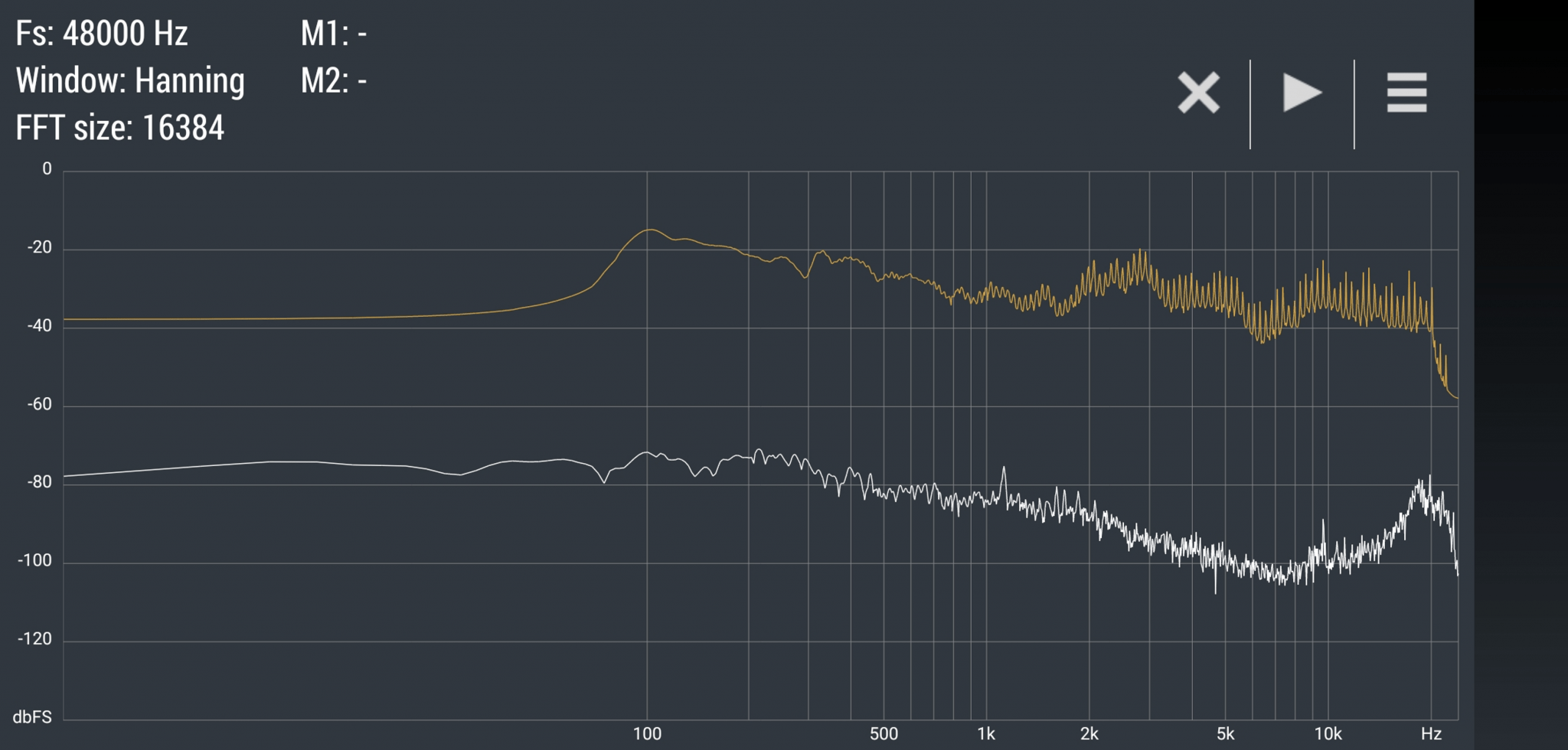

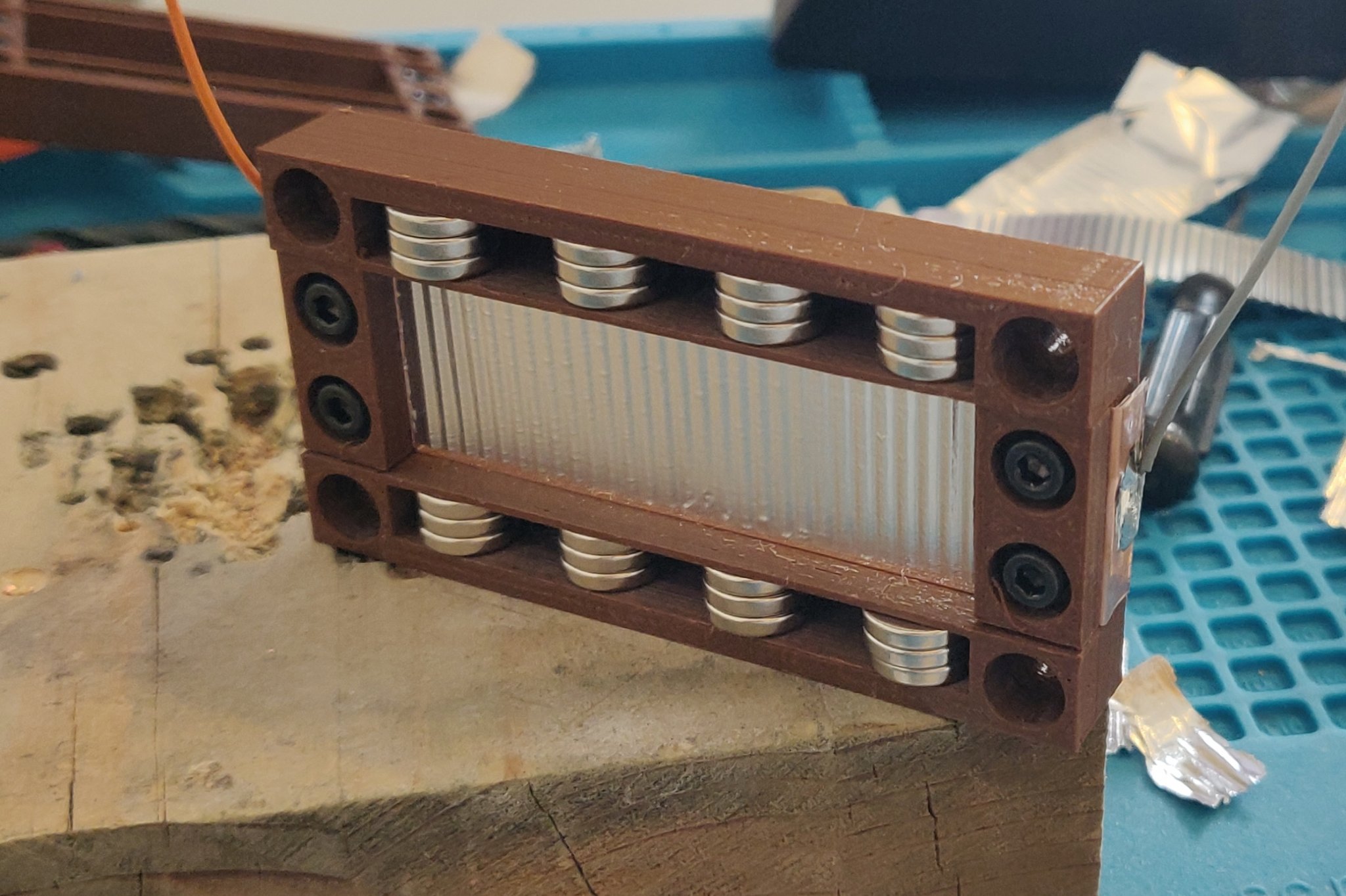

Hello, I designed for the first time a ribbon transducer and is shown in the attached picture. I used aluminum foil for food wraping. I temporary used the magnets n52 as shown but i ordered from Amazon.de N52 neodymium magnets 60mm X 5mm X 3mm. I will use 2 on each side of the ribbon. The ribbon is 60mm X 20mm but my question is if i can increase the width to 30mm in a new design. Overall is sounds good but there is a min in audio level at 6KHz because of a reason which i cannot explain theoriticaly yet. Also i discovered that the power amplifier must have a output 15w at least, but with a series pwer resistor of 8 ohm because the tranducer has 0.1 ohm resistance.
The diaphragm as i mentioned is 60mm X 20mm and the material is aluminum foil for food wraping. I believe that it has about 10-15 micron thickness. The whole design was designed by me and 3d printed with PETG. Please let me know wher can i find a foil with better quality and lower thickness.
The foil which i use is free without any tension. I made it with multiple v shape in crossection. Also the aluminum is not elastic so it cannot be tensioned. Only, if i use aluminum on kapton i will tension the material, but then i will make planar transducer and not a ribbon transducer.You have to apply an amount of tension to the foil then maybe you can control the 6kHz dip.
Did you simulate the magnetic filed of your arrangement ?

i think you measured up close looking at the reach of 100 hz. try measuring at 1 meter.I used a program for my android phone. The yellow graph is from transducer.
that dip is more likey baffe difraction , or the fact it is rather large tweeter and not a true line source either. move your mic up or down see if it shifts. if so..the problem is not the foil or tension of the ribbon itself but its size/length. bolserst had a nice picture of what happens with large ribbon tweeters/small line sources, usually its a nice wiggle
To maybe help answer your secondary fundamental magnetic question,....All the many speaker (traditional dynamic magnetic cone & magneplanar, etc) designs, I only see non-nagnetic VC wire used.....Steel (or any other magnetic) VC wire (or foil ribbon) would remain sucked up tight attracted to the pole piece magnet & make quite a bad buzzing sound distorted mess....The weak but additive "electro-magnetic" field force field effect causes the non-magnetic VC wire (spool coiled or linear straight" to be alternatively pulled & pushed away from the pole piece carrying the attached diagram if used....It deff seems to work where magnetic wire or ribbon just gets in the way !! ...I leave the involved physics version up for others !! ....tomCould aluminum foil (like cooking foil) be used as a transducer? I mean since most ribbons and magneplanars use aluminum strips attached to a mylar or similar membrane. So could use just forgo the mylar and use the foil since the entire surface is aluminum. Although you wouldn't be able to stretch it like mylar thats for sure.
Anyways any ideas on this. Oh ya one question, a fundamental one I suppose. Since aluminum isn't magnetic, how do ribbons and stuff work exactly? Does the electromagnet affect aluminum differently than a earth magnet?
