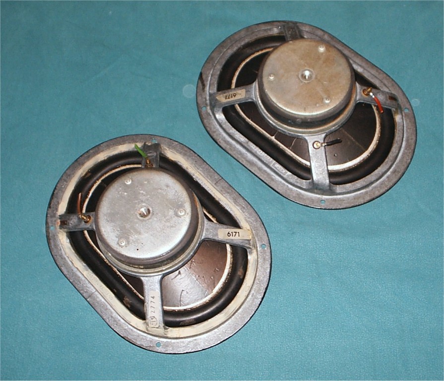

B139 is a completely solid polystyrene foam cone (not hollow) about 3 inches thick with flat aluminum sheet on the front and PVC sheet at the back. This thing is very stiff and very light, hardly a sandwich. The whole piston is damped. The front, if dented remain dented, it does not return top it original shape. I have preserved the rubber roll surround and over the past 60 years became more and more compliant in the Fs is now 15Hz. Two are used in an H frame that Siegfried and I built, one of the first attempt.
In a way, perhaps a bit before their time > the B139's have been quite revered & little criticized > except perhaps their maximum SPL output.
Very interesting note regarding the lowering of Fs over time 🙂

Why? They have served me well and sound is great. I would not even dream of messing with them. They fill in the low and very deep bass nicely from under the desk supporting a pair of original Rogers LS3/5 (had since new) on either side of my 37" PC screen on my desk.
I don't think you could have anything better sounding for near field listening. No DSP at all, exactly as developed by BBC. The H frame was built by hand, all perfect 45 deg angles, no table saw or routers, by an old carpenter/shop fitter in Santa Carla using solid maple on the outside box glued to MDF on inner box and soft board, often called sound board on the inner, inner cabinet in the late 70s. I have no idea how it measures, but it sounds right.
The two woofers are mounted face to face and crosses over to the LS3/5 at 70 Hz. This has been my personal entertainment system since I can recall. Most recent changes (about 30 years ago) I replaced the passive cross-over to the subs for a 70Hz 2nd order Butterworth active to the H frame. The LS3/5 is driven by JLH 69 and the woofer by JLH 69s bridged. All class A. Yes they are hot and I have the air-con running at 24/7 winter and summer.
