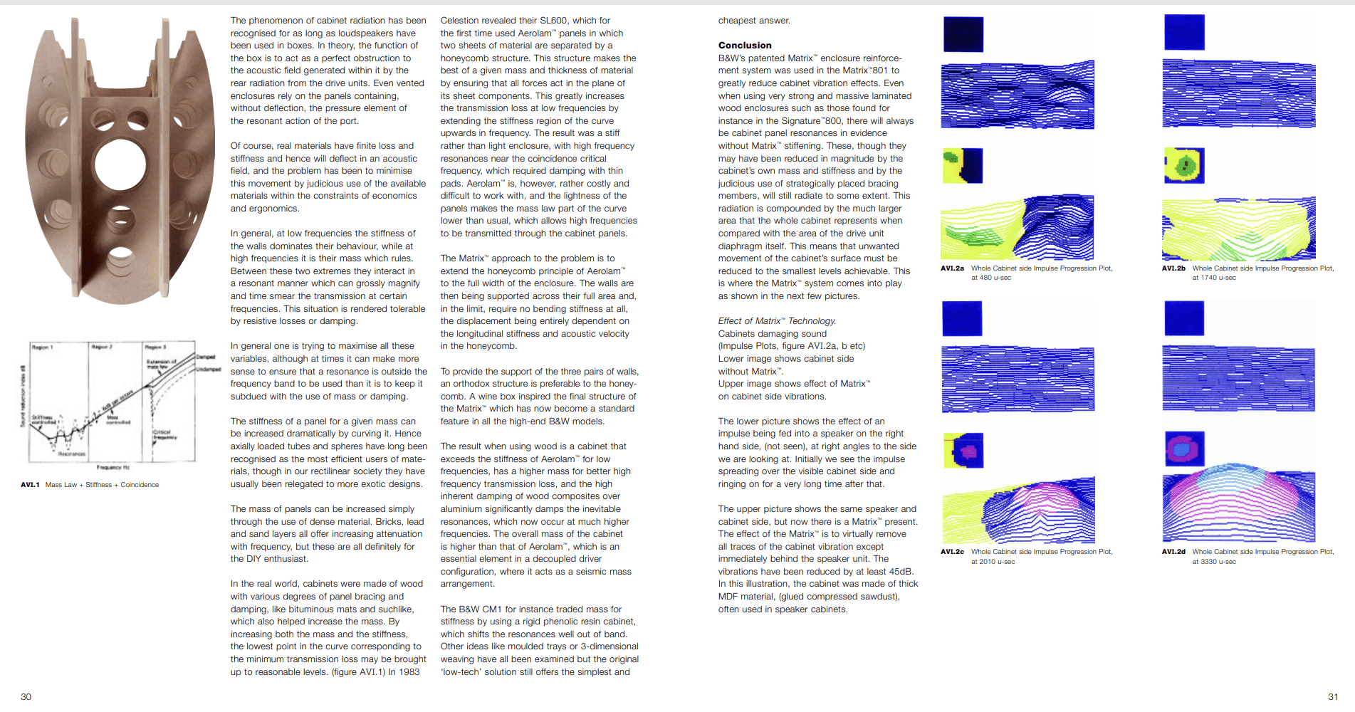

Here is some more from a B&W white paper on the 800D, what they say there is very much in line with augerpro's image depicting the different regions and it also includes the same image that b-force posted about Mass, stiffness and coincidence.
"In general, at low frequencies the stiffness of the walls dominates their behaviour, while at high frequencies it is their mass which rules. Between these two extremes they interact in a resonant manner which can grossly magnify and time smear the transmission at certain frequencies. This situation is rendered tolerable by resistive losses or damping. In general one is trying to maximise all these variables, although at times it can make more sense to ensure that a resonance is outside the frequency band to be used than it is to keep it subdued with the use of mass or damping. The stiffness of a panel for a given mass can be increased dramatically by curving it. Hence axially loaded tubes and spheres have long been recognised as the most efficient users of materials, though in our rectilinear society they have usually been relegated to more exotic designs. The mass of panels can be increased simply through the use of dense material. Bricks, lead and sand layers all offer increasing attenuation with frequency, but these are all definitely for the DIY enthusiast. In the real world, cabinets were made of wood with various degrees of panel bracing and damping, like bituminous mats and suchlike, which also helped increase the mass. By increasing both the mass and the stiffness, the lowest point in the curve corresponding to the minimum transmission loss may be brought up to reasonable levels. (figure AVI.1)"
At some point I read another paper about the latter version where the bracing was changed to plywood with aluminium inserts based on FEA modelling to find a more efficient use of materials. I have never been able to find it again, but there are some images in this video showing what they did and some screenshots of the sims.
A paper from B&W that I could find
https://www.comsol.com/paper/download/199487/cobianchi_paper.pdf

A paper from B&W that I could find…MEDIA
