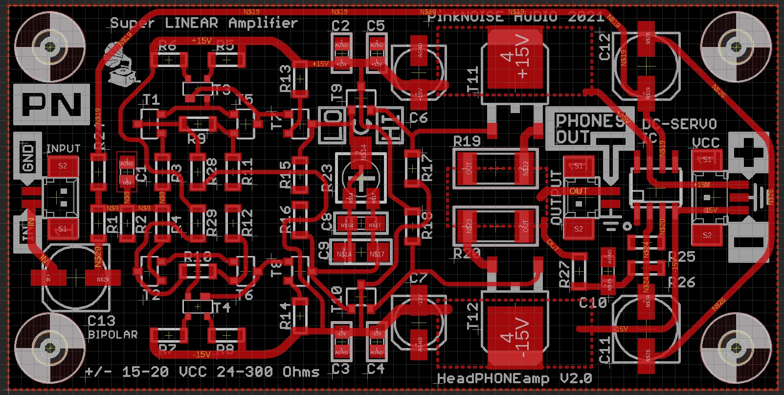

allpcb offers 5 pcs. aluminum boards < 100mm x 150mm for free to every user once a month.
I will test these boards with a phoneamp circuit.

Maybe good for an HPA or something using, say, medium power SMD output devices.
EDIT: could possibly be of use in some types of discrete DAC output stages and or discrete AVCC regulators, say, maybe some something running from +-24v rails.
