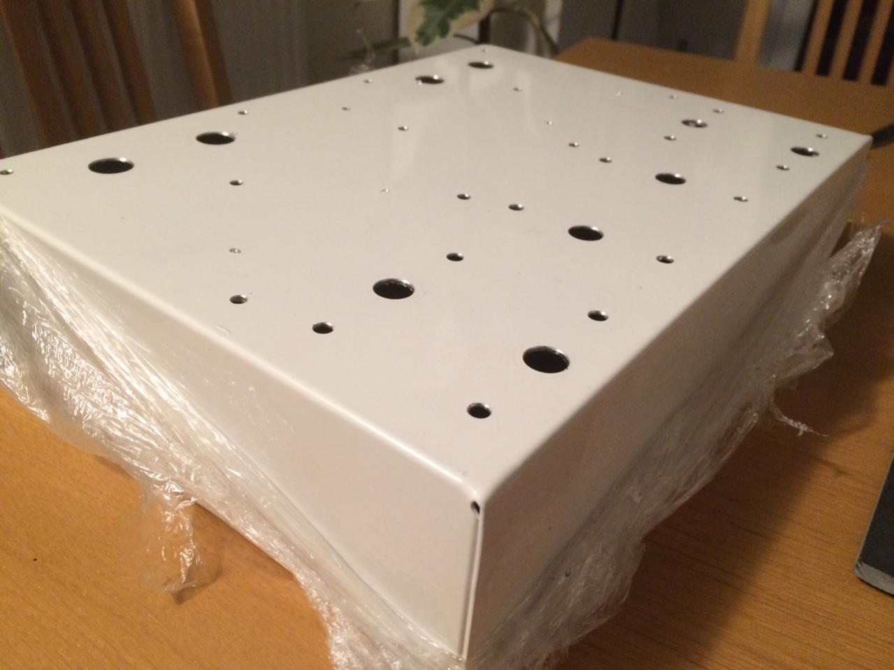

An update - I went ahead and got the chassis powder coated. Looks great.
I then started getting the holes drilled. Using 'proper' workshop-grade equipment, under expert supervision from a technician, I was able to do the top surface. A lot better than the kitchen table, a scale print out and a hand drill!
Still to do the power valve sockets, the front and rear.
If I were to do it again, I'd obviously do the holes first...

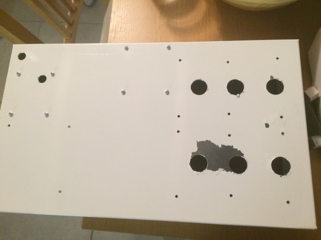

Well that didn't go well...
Another update on this. And not a positive one.
The lesson here is be patient and get your holes drilled before powder coating...
The coating just peeled off when I removed the masking tape on my preamp chassis - see attached.

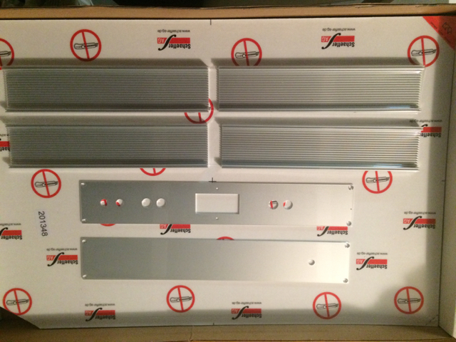

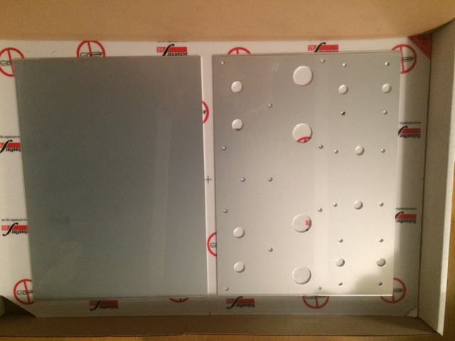

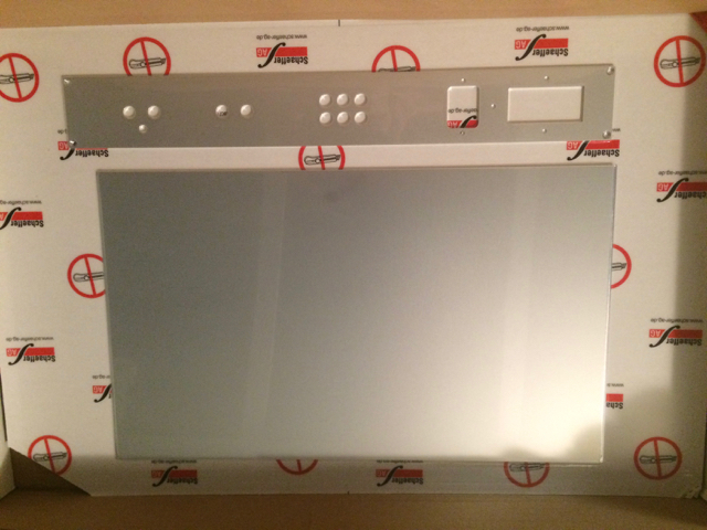

So I gave up and ordered the two chassis from Schaeffer / Front Panel Express. I'm very impressed. The ease of importing from AutoCAD and processing the order, all the way to the packaging (attached). OK, it costs a bit. But the time I would have saved as well as the quality makes up for it.
Highly recommended so far.
Thats but one lesson.
This is due to the Al. surface not being cleaned and treated with an etch prior to powder application and baking. I've seen this occur on switchboard enclosures for a Naval project I worked on years ago. The pealing became apparent half way through assembly and wiring about 150 boards in various states of completion . Due to high QA requirements every panel had to be stripped and re-coated.
This idiot paint contractor was 'lucky' in that the faulty coating came off relatively easily due to such poor prep treatment.
Correctly cleaned and etched aluminum or even zinc sealed steel does not do that even after harsh post-paint cutout modification. The coating will crack if panel is bent or folded and melt if localised heating occurs while cutting, but it will not flake like that.
So, make sure the powder coating 'professional' your using knows what happened to last effort and then does the correct prep work in future.
Many of these guys have had long experience spraying 'wet' paint finishes and I reckon many have brain damage from the fumes... I know many enjoy that sweet smelling thinners and solvent aroma and the 'high' way too much.
If they try to suggest it flaked due to mechanical damage like drilling holes and masking tape... don't argue, just find a true professional paint shop for the new case panels. Take faulty panel to another paintshop and they will confirm what I say here.
