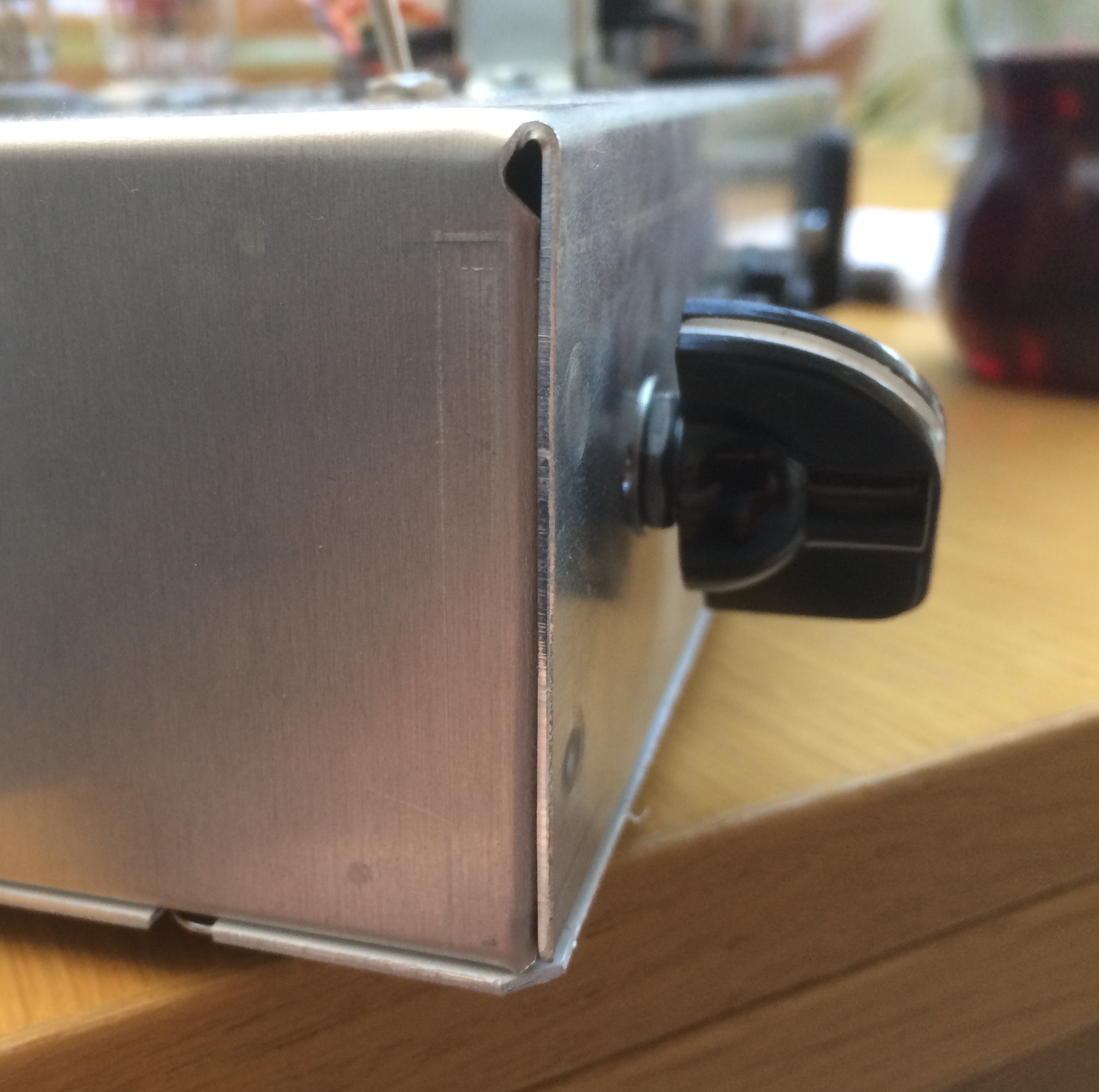

I'm going to use Hammond aluminium enclosures for my amp and pre-amp builds. To make them living-room friendly I'll get them powder coated.
The problem is, where the sheet metal is folded at the corners, there is a ~2x1mm gap on the apex. Along with the join of about ~1mm on the welded edge. See attached.
Is there anything I could fill this with prior to powder coating?

Body filler is (from my costly experience) not going to work. After powder coating the work goes through a heat curing process that "bondo" just does not like.

What about brazing, all you need is some heat and a rod? Although such a big work piece might leach all the heat away.
Mig would look good but theres the expense. You can braze it at home with a simple propane torch and a little practice. If theres a tech school close by they might weld it up for a small donation or the cost of gasses.
I think I would get a piece of aluminum or stainless steel and give it a face lift. Drill it out for pots plus 4 extras to fix it on. Ideally after the joints are filled in. Unless you flush mount a new face some overhang will hide some of the ugly. At least from the front.

Indeed. New faceplate with a decent overlap hides a multitude of sins. You could even do the back panel as well if you wanted.
It is not possible to braze aluminium with brass.What about brazing, all you need is some heat and a rod? Although such a big work piece might leach all the heat away.
A sheet metal worker with good welding skills can fill the holes using a MIG setup. Here is a utube film of the way it can be done. Just a thought.

If you have it welded from inside and then you can finish the outside to a smooth finish before powder coating.

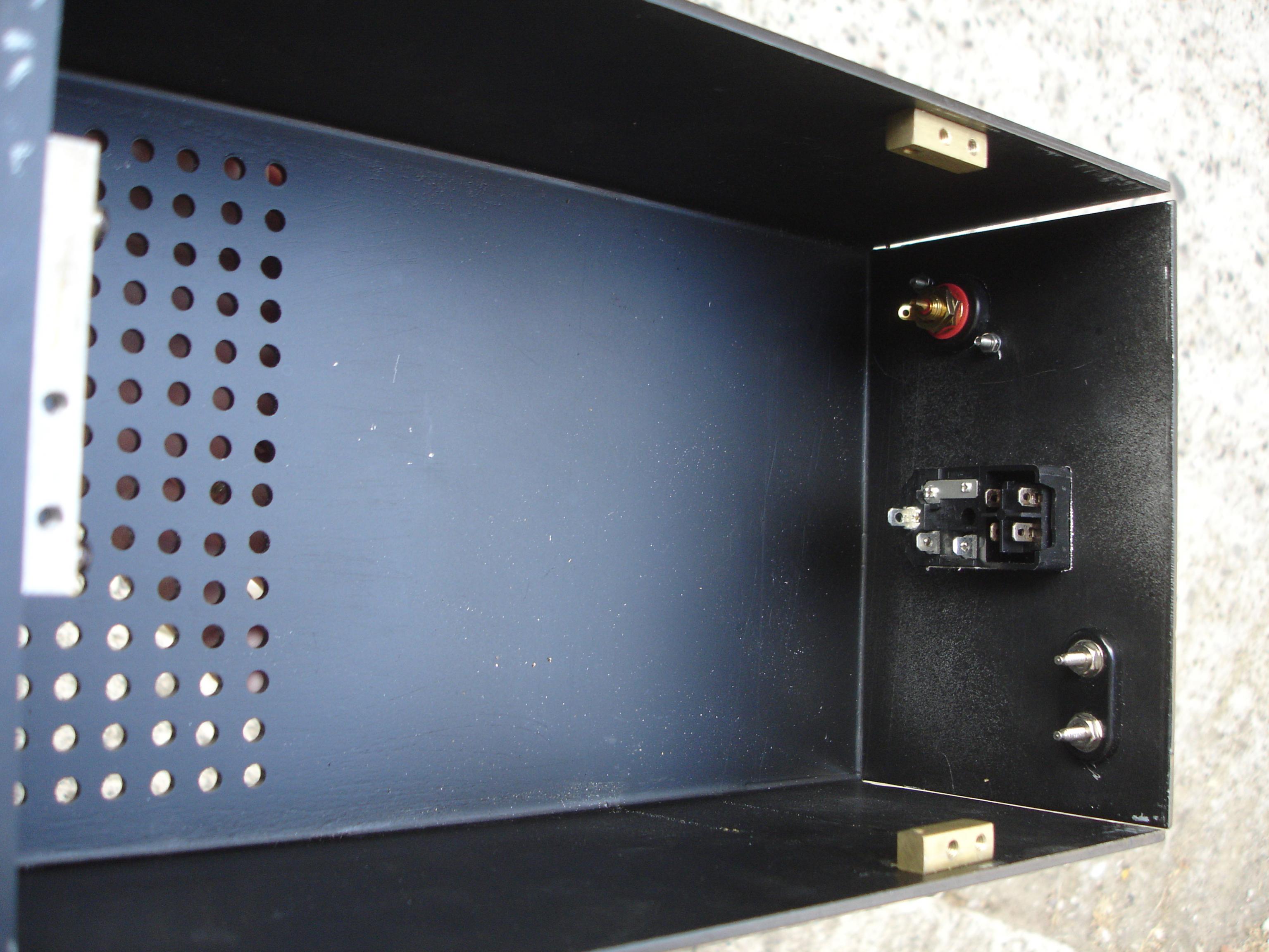

This was anodized at first and then painted with a black spray paint.Hi thimios, tristanc,

Thanks all - I think the lesson here is you get what you pay for...

I'll see if someone would be willing to run a torch over the front edges. Certainly seems the best option. But I guess that would be pushing the limits of a favour!

If it were my enclosure, I'd get someone who has TIG welding skills to fill the gaps. Then smooth the welds if you wish, use some etch primer and paint and forget about powder coat. Use a good base coat and a urethane clear topcoat either gloss or semi gloss and you'll end up with a reasonable looking job.

how about devcon can withstand 350 degrees. I've used it in auto body repair.
