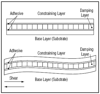

The combination of butyl and an aluminium foil is known as a CLD (constrained layer damping). Often used on metal surfaces like on the inner side of a Car door.
attachment.php
While it may do something when its stuck on wood, I don't expect it to act as a true CLD layer. The aluminium foil layer is probably too thin to be able to act in this way. Their target often is sheet metal as found in cars.
