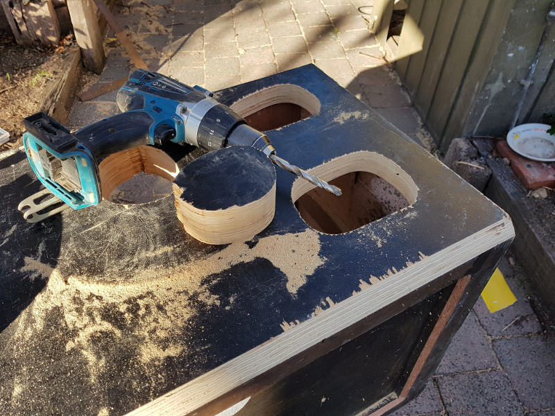

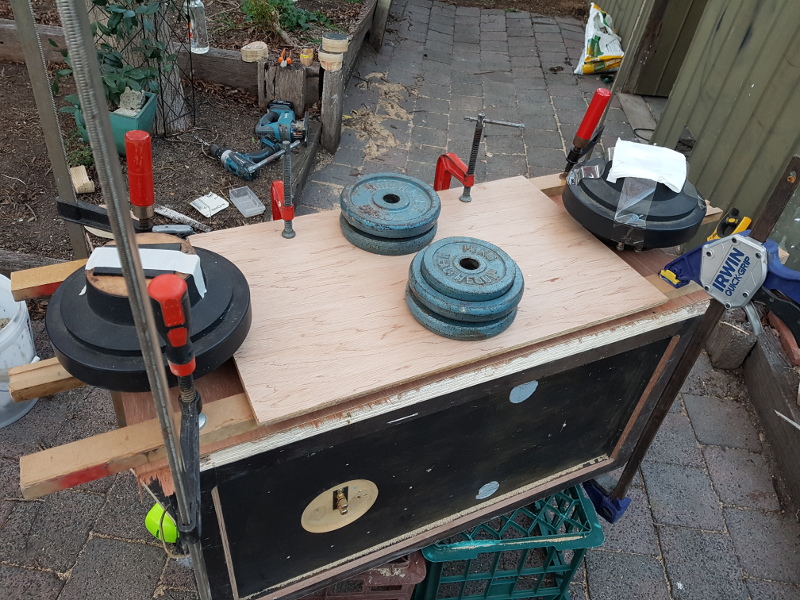

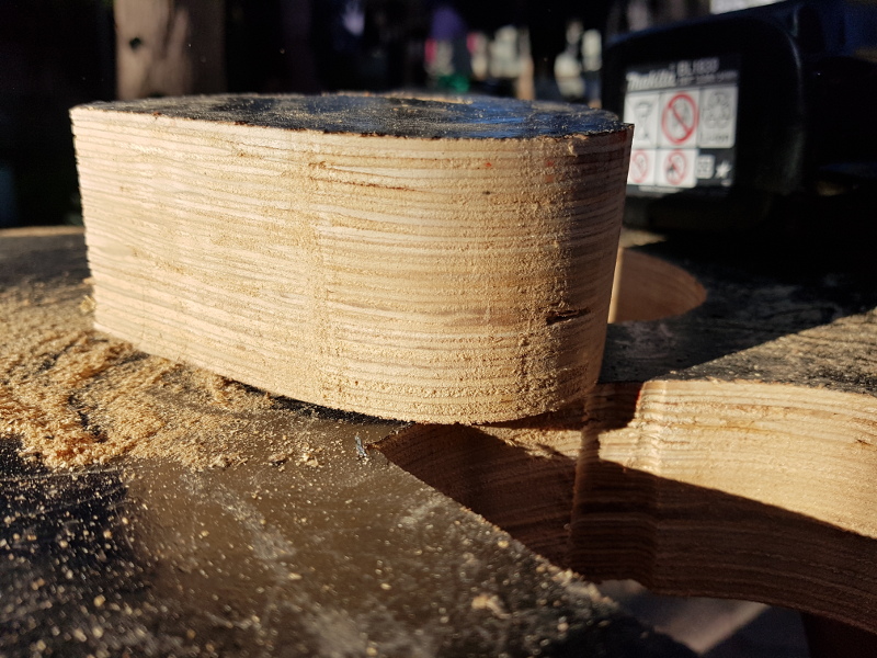

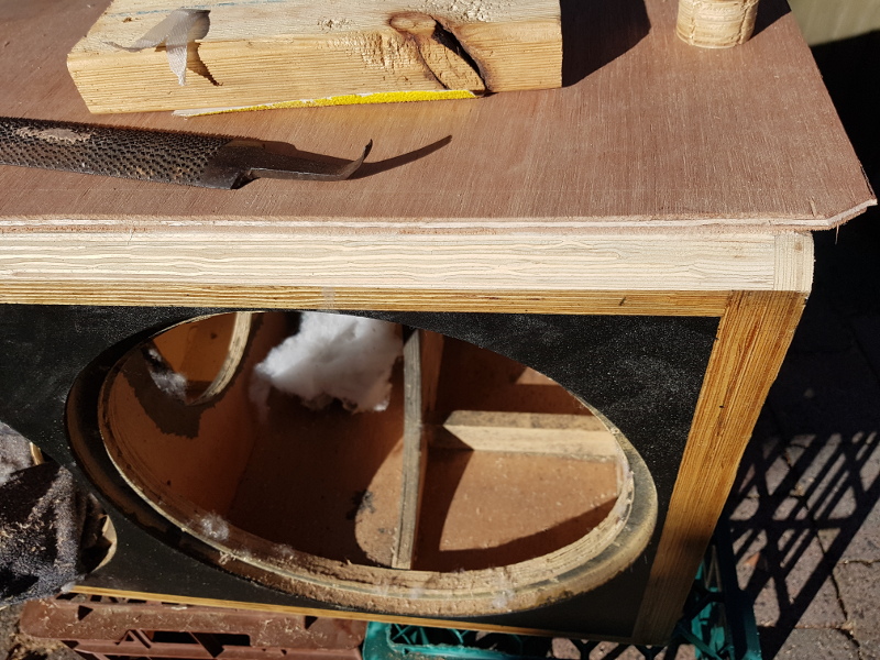

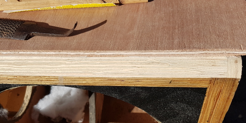

Loosely related: doing a tweak of an old box.
I'm putting a new skin on (4mm braceply, 5mm bamboo). The original box is already double walled, so I'm honeycombing it to keep the weight reasonable. A minor bonus is that the box will have slightly more internal volume.
Using a drill + jigsaw, I was surprised at how quickly I was able to make the cutouts. Laminating the skin layers on is the slow part.
Is there anything that'd involve less work, e.g. is there an off-the-shelf source of honeycomb material that isn't prefinished (both sides sealed)?
