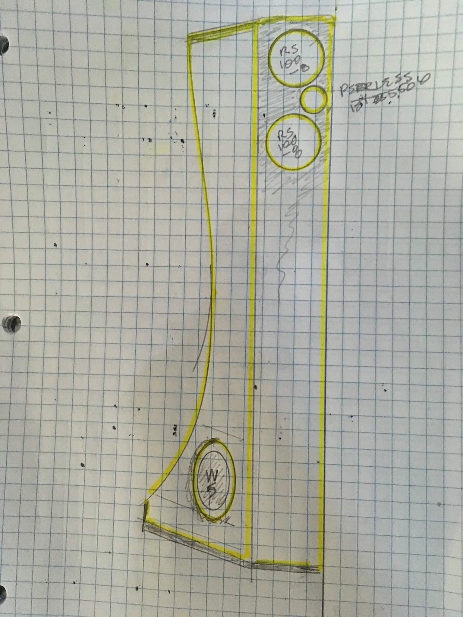

I build qw full range and subwoofers mostly.standard qw pipes full range and anything for subwoofers. The more complex more fun. Perfect is not exactly a priority. Exciting is. Big subwoofer output is always exciting. But big in a small driver in multiples is great. I’ll play along with the iron law no problems with size of cabinet.

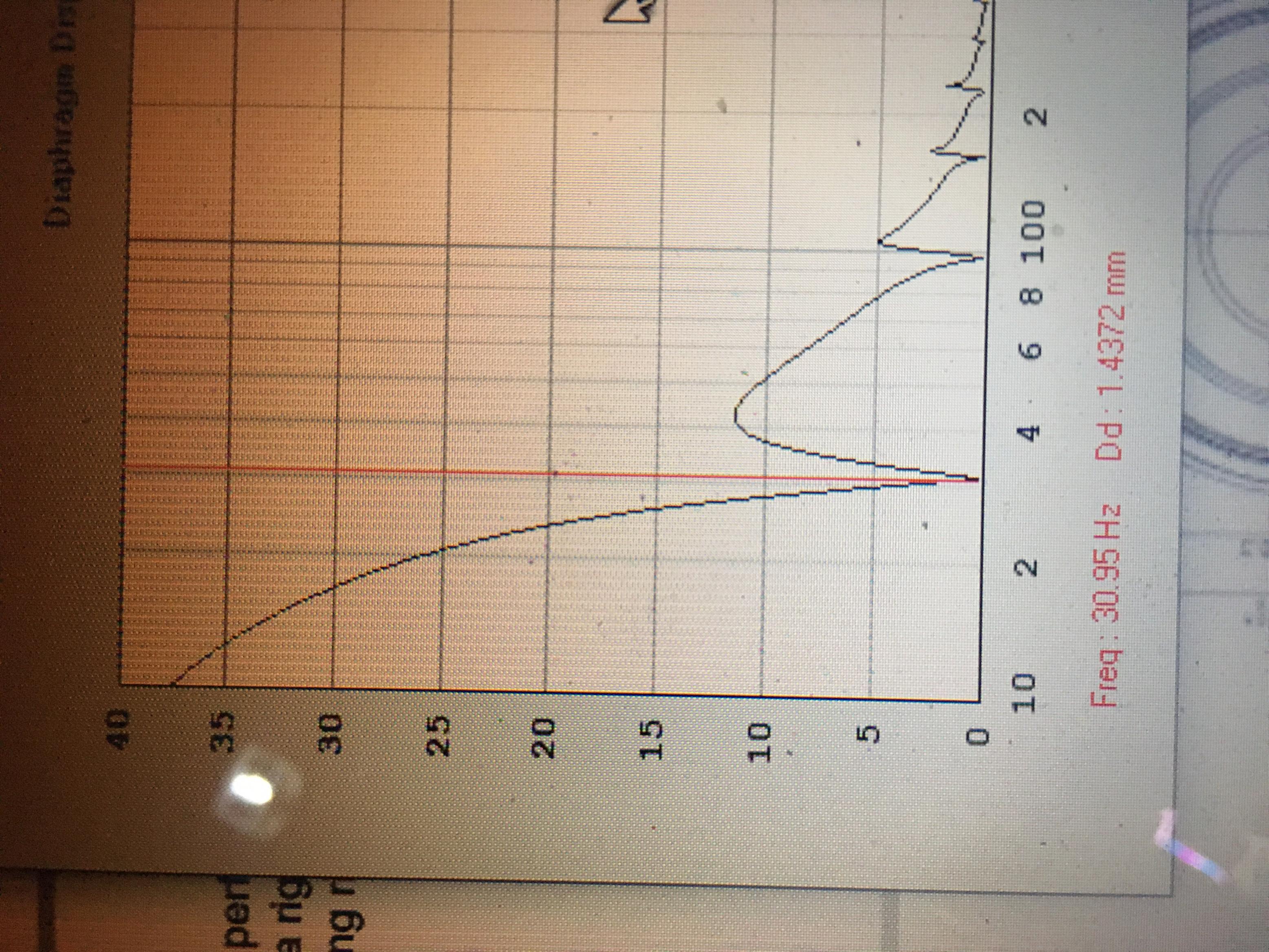

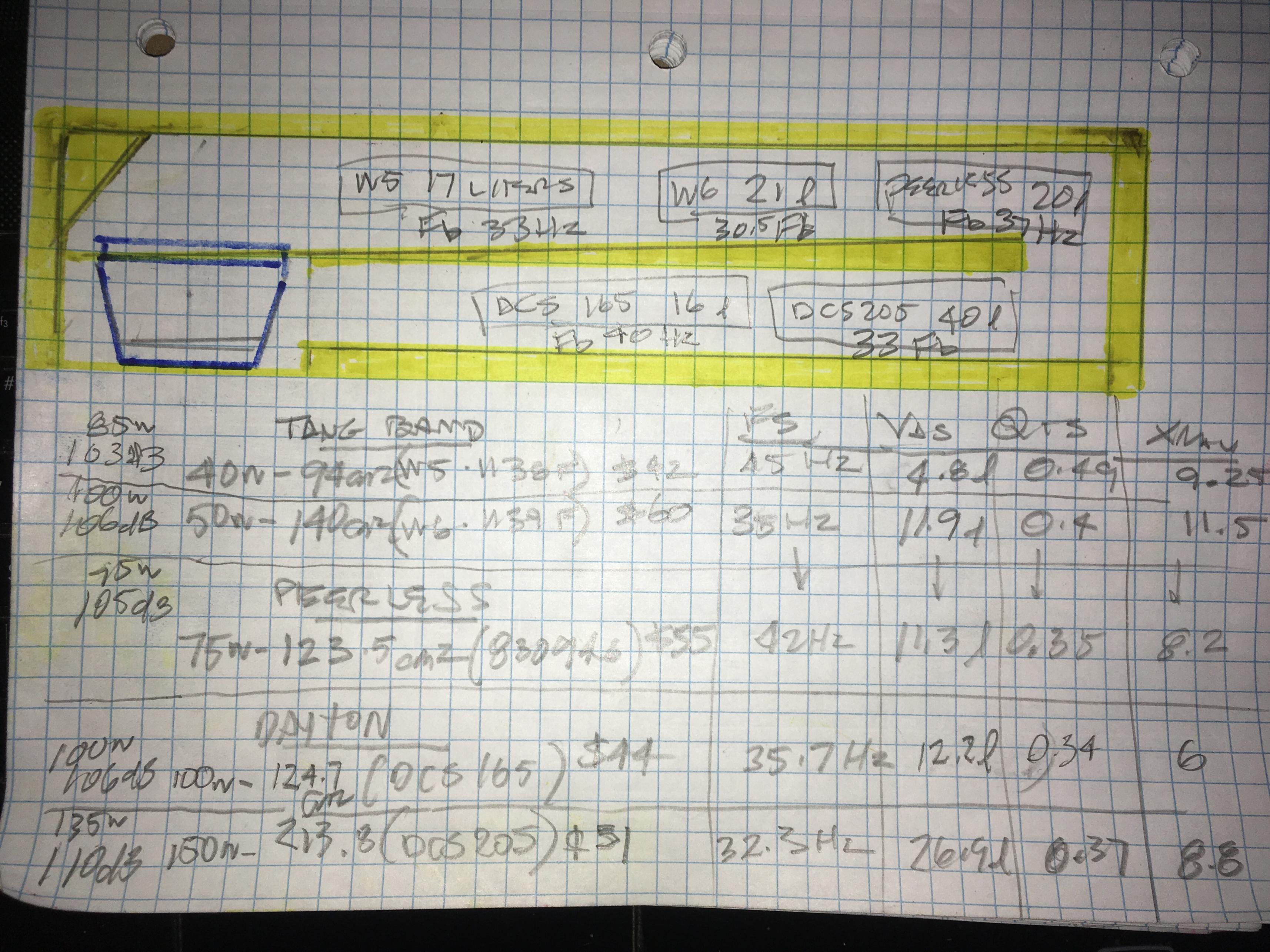

I grabbed 5 drivers to compare. Thx to suggestions from you guys.
Tangband $43 w5-1138f, $60 w6-1139f, peerless $55 830946, and the Dayton $44 DCS165, and $51 DCS205. Modeling them with suggested parameters in standard end loaded pipes using Brian’s QwikMath for this very thing!
My notes....generic TL used with exit @ driver. Slight tapers used to flatten responses as needed. Simmed as a tapped pipe with no substantial segment @driver/exit or throat entry.
Tangband w6 murdered the Fb @30.5 Hz at xmax (106dB)and 100watts In 21 liters. It’s little brother @33hz, but only 103dB in 17liters(85watts used). My w5 says(sim) 106 in a transflex, 21 liters or so. But that’s oranges not apples. And you gotta milk that outta the little guy.
Dayton Dcs205 took the dB @110 for its 33hz Fb with a much bigger TL at 40 liters. It’s the biggest by far, but seems to be the $$$ best spent in a few ways other than that.
Dcs 165 in 16 liters took 100watts at Xmax for a flat 106dB@Fb 40hz. Solid.
Peerless 830946 was at 105dB @ Fb 37hz, 20 liter TL.
Everyone had a nice simple sim with a flat response and no pressure to perform. These are merely simmed examples, not to be taken as a fact. Nothing stuffed, massaged or given too much thought.

In the base of this skinny tower(pair) is room for a side mounted ‘subwoofer’ and it’s qw path. The MtM section above is an 8 ohm pair of Dayton Rs100s and a peerless tweeter with a small wave guide. The rs100s are in 4.5liter TLs of their own, already tested and good to ~65hz. With a subwoofer, It would be ideal to cut them off at Anything 80-100. They can bottom easily when pushed as a ‘full range’.
I only have one w5 and need another, but they are out of stock everywhere I checked(parts express).plus at $42 they pivot in an area where $15-20 more is a different driver all together(dsc205, w6-1138f,etc.). After simming ^^^^its quite a leap from the w5 Output for not too much $.
Brian Steele’s DCS205 idea is great. A bit too large is the only issue. Your W6-1139 seems to be the beez kneez for this...?

Remember to include the semi-inductance parameters for the drivers in your sims. Some of the response curves can change quite a bit when these parameters are taken into consideration.
The DCS165 looks great in a straight TL - when used in pairs (with just one the CSA of the TL could become too small to physically fit the driver's depth). More expensive than just using one DCS205 instead, but does allow for physically slimmer cabinets.

I put the DCS205 in ISObaric modeling and laugh at the irony. The TL fits amazingly and quite easy, it is great. However the added room of the piggy back driver pokes out the sides now. Additionally I have to ultimately enlarge the exit to a size flared for air velocities... why is the ‘iron’ law so ironic? 😛 no matter what! Lol. Can’t win. But! The DCS165 in a throat chamber entry of 2 (not ISObaric) is very interesting here!
Guess I Bite the bullet and save the DCS205 as that special one... some day I will get us both 2 of them and we can each make a pair of ‘boom boom units! (I assume you can’t get PE stuff easily at your location).
It's easy to do - use a trace tool like FPGraphTracer to derive a ZMA file from the published impedance curves, then use the workbook available from my website to derive the semi-inductance parameters from the ZMA files. Takes only a few minutes per driver. I think PE actually publishes the ZMA files for its drivers, so there's no need to do the tracing.
