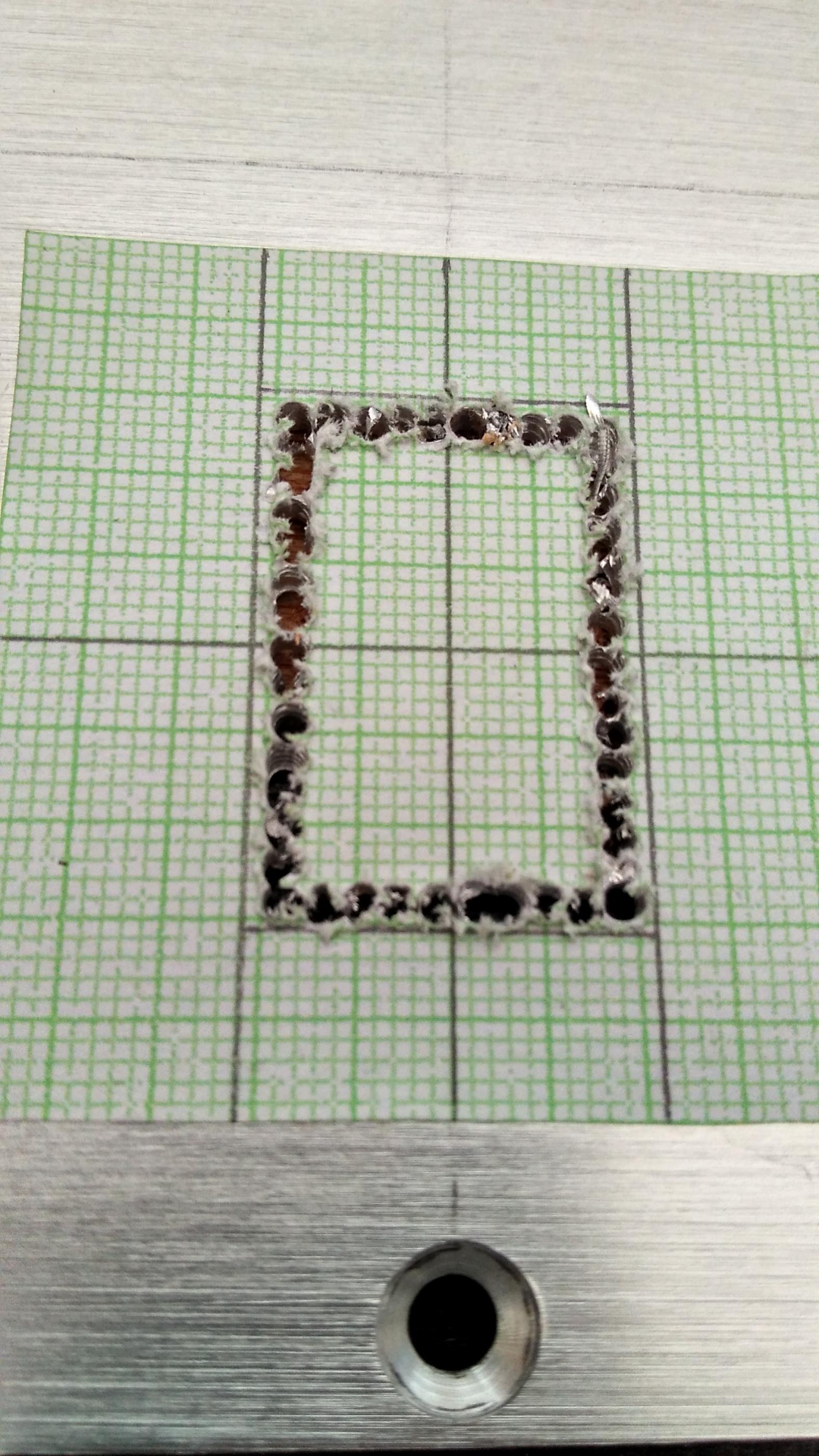

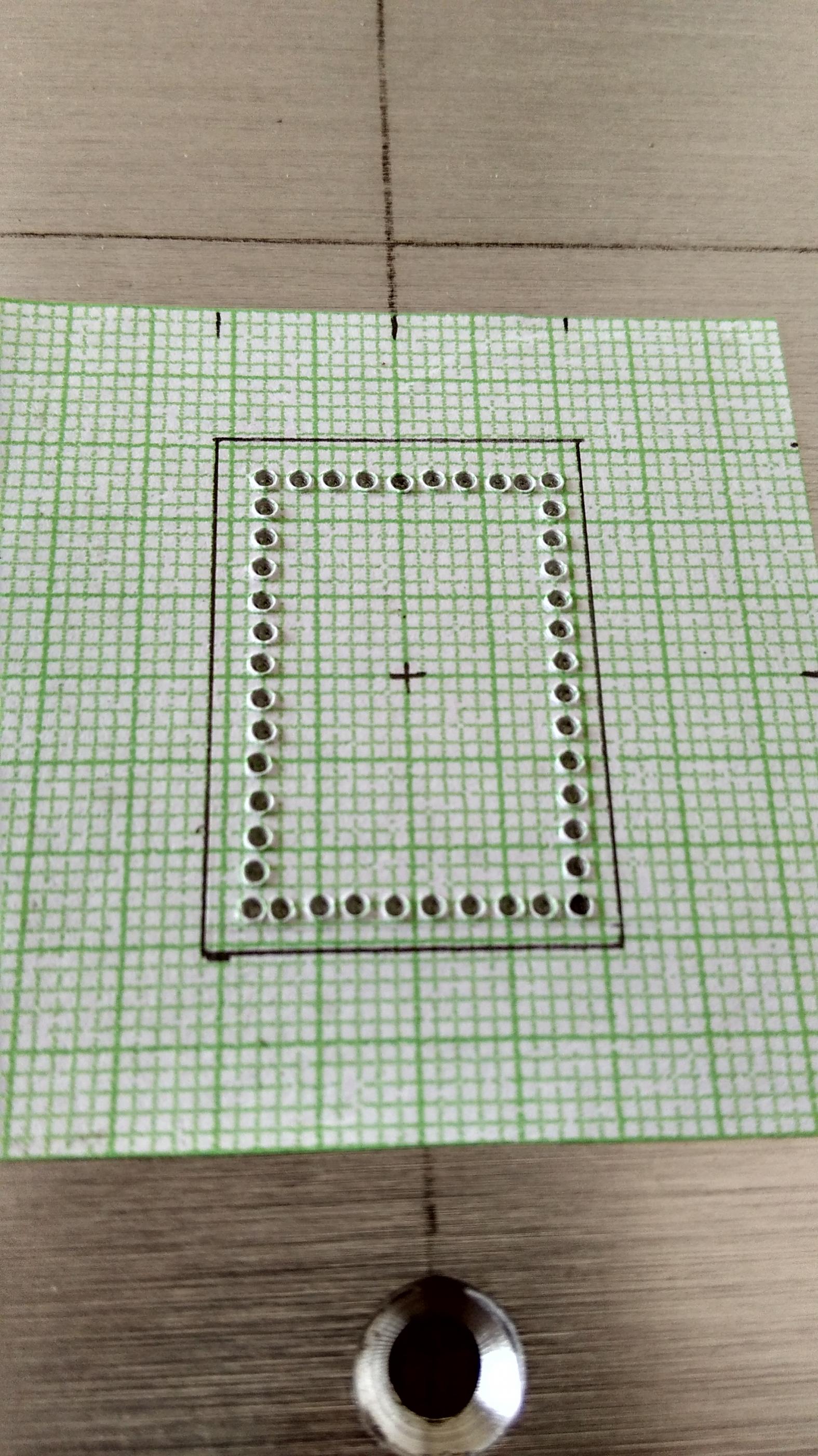

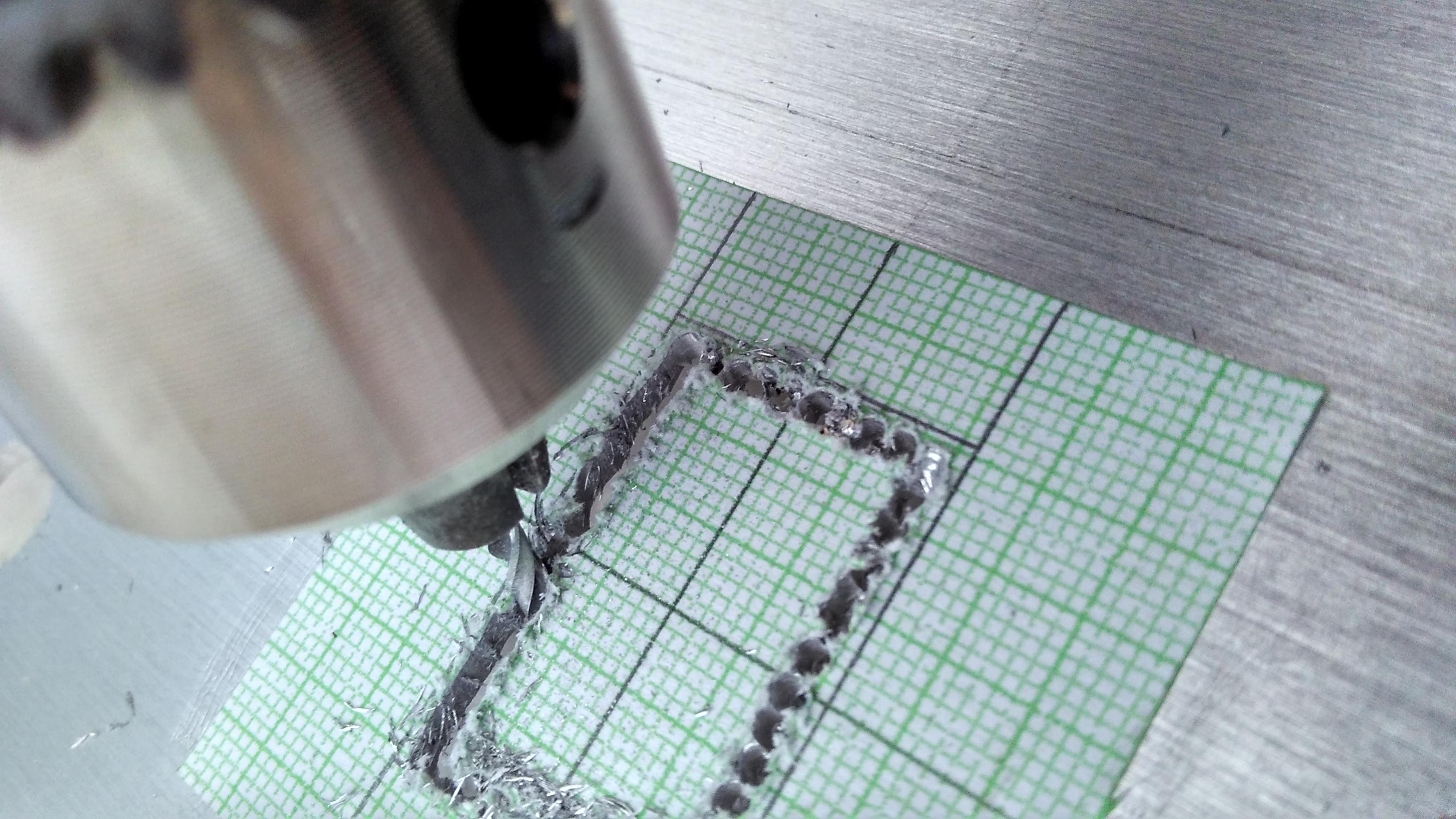

Just want to share what i have accomplished with hand tap, hand drill, and flat iron miser (this last item hopefully correct in english as google translate). My amplifier back panel only has iec hole, but i have to make extra hole for on/off socket, while for fuse,rca, and binding post is easy. So below step for rectangular hole on 3mm alum.
1. Mark your alum with a stright line with pencil as your reference.
2. Glue milimeter paper on plate alum and draw your rectangular
3. Use hand tap and mark 3mm inner rectangular line with 2mm distance
4. hand drill 2mm size, after all holes drilled then use 2.5mm size and this is the trick : while drilling, pull and push along the holes just like you are cutting with drill.
5. Clean the miser
Then you have rectangular holes, yes not perfect but from outside you'll not see imperfertion since it's covered by socket boundary
