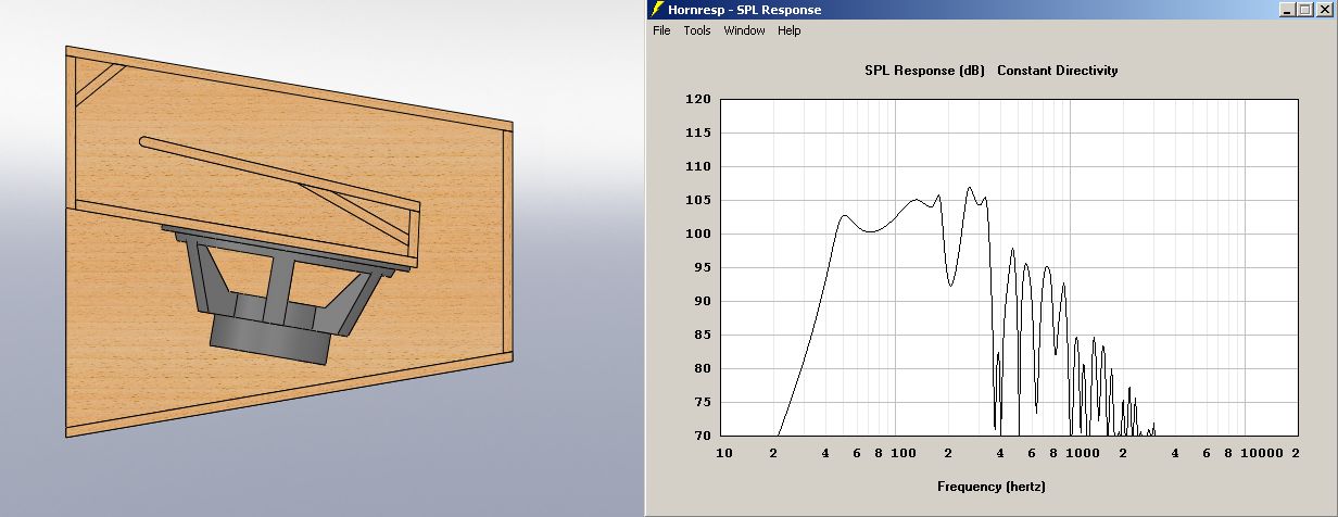

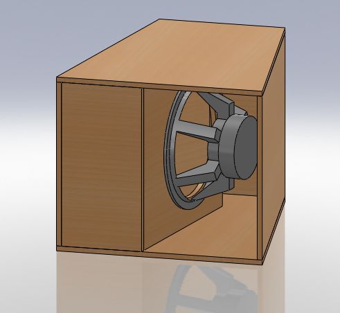

If you would like to get a bit more flexibility with the design of your TH, I have a suggestion for a fold that might help. It is a prototype drawing I did a couple of years or so ago - since then the progression we have made towards designing high performance tapped horns has been amazing.😀
This fold could acheive the passband you are after. The difference being that it is based on a trapeziodal cabinet. This is a cutaway view of the plan. ie Looking down at the cabinet.
The design would need some development work. This was based on a 18" driver and is simmed in 2PI. Dimensions are 624 high 720 wide and 842 front to back
The 105db hump at 130 hz can be reduced by removing or adjusting the tapered piece of the horn throat from S1 to S2.😉

Martin: Not sure what you mean by "more flexible"... Could you explain what you mean? Also: It's too big! Two times the volume of the Cowan 60Hz, and way bulkier. I could probably manage a TH higher than the C60Hz, but what you suggest simply won't fit in my living room... 😉

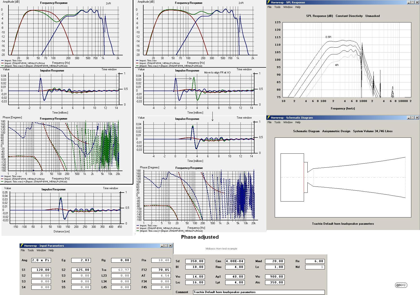

Bjorno: the horn is designed for a 140Hz cutoff at 2pi. Length about 80 cm. No delay is applied.
I wish I could say that I understand exactly what point you want to make with the measurements, but I don't (although I'm quite sure there is a very valid one). 🙂 Could you please elaborate a bit?
Hi Ayebee
The Cowan horn is very simple with a single fold. This means that the horn has only one taper angle on its complete length. This may work but does not give much flexibility to adjust the horn path to achieve the desired frequency response.
The trapezoidal layout allows up to 3 differing tapers to be used on the horn path. This makes it more adaptable to be adjusted to achieve the required response with your chosen driver.
The layout was meant only as an example. The Cowan 60Hz horn used a 10" driver - My example used a 18" driver. The size of the horn may be reduced by using a smaller driver - the path length will need to be roughly the same to get the same frequency response.
The driver and size of the horn chosen depends on how loud you require the TH to be to match the rest of your system.🙂
