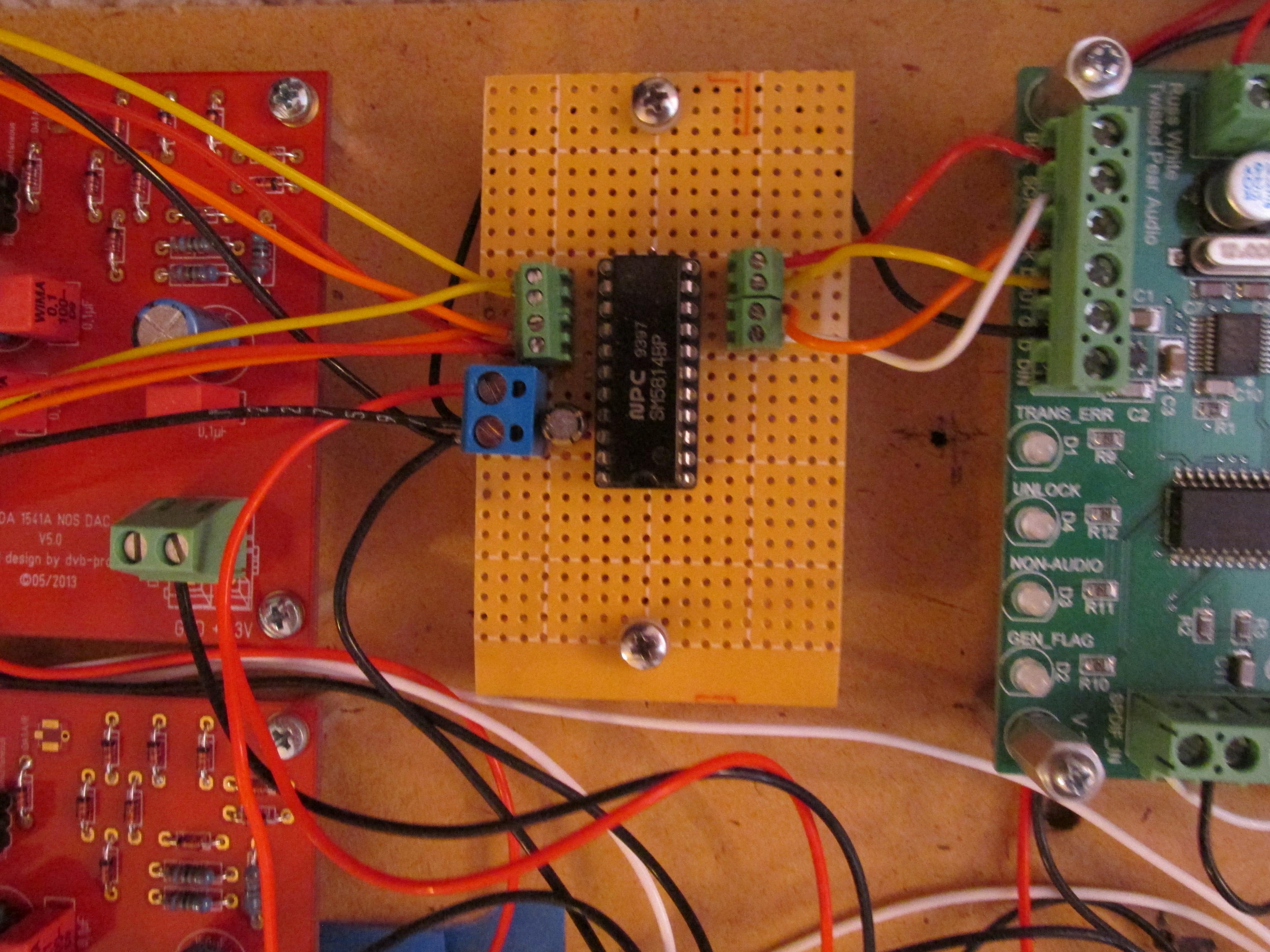

Hi, I tried the SM5814 in my Curcio DAC. The best results I got with a CS8412 DIR with Wildmonkeysects loop filter and a MAX913 at the input.
Thank you Torchwood, also for correcting the typo's in the datasheet.
I am glad you found it useful. It sounds better then any 7220 for sure. My cousin gets all the credit for this one. He discovered this part all those years ago. :nod:

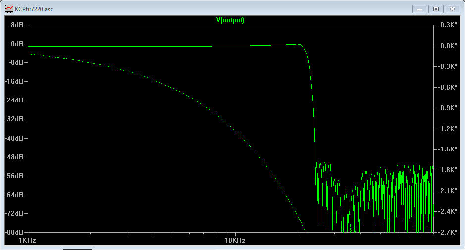

SAA7323 doesn't have quite the same frequency response as SAA7220 - the HF lift looks to be less - 0.4dB vs ~1dB.
Here is a FR plot of the SAA7220 based on coefficients extracted.

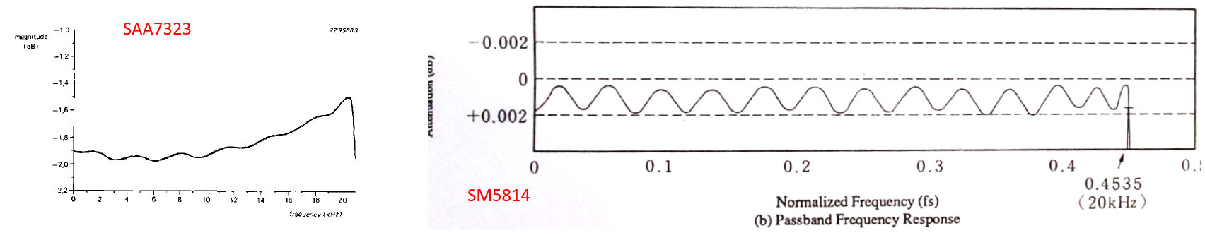

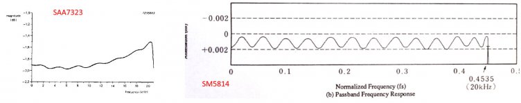

thanks for providing the (theoretical) FR of the SAA7220.
Well, I couldn't care less about +-1 dB difference in the region above 16kHz (I reckon the SM5814 neither has the same FR).
Overall, out-of-band attenuation seems to be ~10dB better than with the SAA7220.

Edit: SM5814 doesn't have any FR compensation at all.

Yes - the SAA7323 has slightly improved stop-band rejection, I take it this results from the extra 8 taps they were able to include (128 vs 120 for SAA7220).
I'd not expect any FR compensation from those NPC chips as they've not been engineered to be part of a complete system as Philip's chips were.
