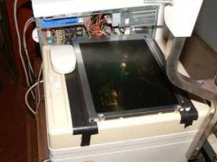

I was planed to have a dedicated PC for projector, so single board computer works for me. Now how do we get sound from that thing?😕 suppose we want to watch Divx on it. USB ->sound convertor?
Since its PCMIC (or some other acronym) compatable...a standard backplane (cheap like 20$ or less) can be used for PCI and ISA slots...or you can use USB

Sound on SBC-675
I think a cheap USB / Audio would be fine.
Highend USB/Audio with Digital Out, also transporting
AC3, DTS , 5.1 i found somewhere in USA for
and this was called "Sonica".
Link to the Company
http://www.m-audio.net/products/consumer/index.php
and the 59$ Link
http://www.eastcoastmusicmall.com/product/K1ME55HCWPBA9J9B9VNR6GPLLPR97NR7/none/MDM+SONICA.htm
some guy at Aaeon told me that you can
, against the manual which says 466 Mhz,
up to 500(533) Celerons plugin that board.
All Celeron "Mendocinos" where the Core Voltage is 2V.
So and this you can find until 533 Mhz.
Over that, there is fewer core voltage which is not supported.
But i think a 500 Mhz is fast enough for decoding
DIVx / Xvid and a also this slower USB Audio at the
same time.
If not i will solder my old Soundblaster AWE64 with short wires
at the ISA pads of this PICMG connector
- without the need of a Backplane.
Not eleagant, but no problem - It's old slow ISA !! (4.77 Mhz Busfreq so near DC 🙂) no HF )
If you can soldering a bit than you do it in a hour i think
cutting this little wires together is the longest process.
... but only when it's too slow what i not hope !
