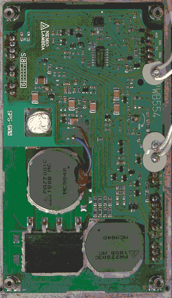

They are NOT isolated. Here is one I took apart to repair after blowing it up. PF-1000A-360 They don't current limit either. Be prepared for smoke and fire. Everything is surface mounted on a metal sheet for heat sinking, and you have to heat the whole darn thing up with a blow torch to replace anything on it. I did get it working again though.

Practically speaking, I think it is easier and cheaper to get a used PFC power supply model like a Kepco or Lambda off Epay and pull the PFC module out. They will be complete units too, the Lambda PF.... modules need energy storage capacitors, thermistor and a heatsink added yet. None of them are isolated though.
Another good one is the Vicor PFC module. That one might be isolated, not sure, I know something is different about it since it doesn't use a buck converter like the others. I have one I got surplus, but I haven't tried it out yet. The module is potted in solid plastic though, so no hope of repairing these if you blow one up.

It seems I may have given bad advice.
I was aware that the VICOR front end modules were not isolated but the data sheet I have from the local supplier of the LAMBDA module says:
Isolation
Input - Output: 3000V AC
Input - Baseplate: 2500V AC
Output - Baseplate: 500V AC
If its not isolated then off course it should not be used as a source of B+.
Ian
