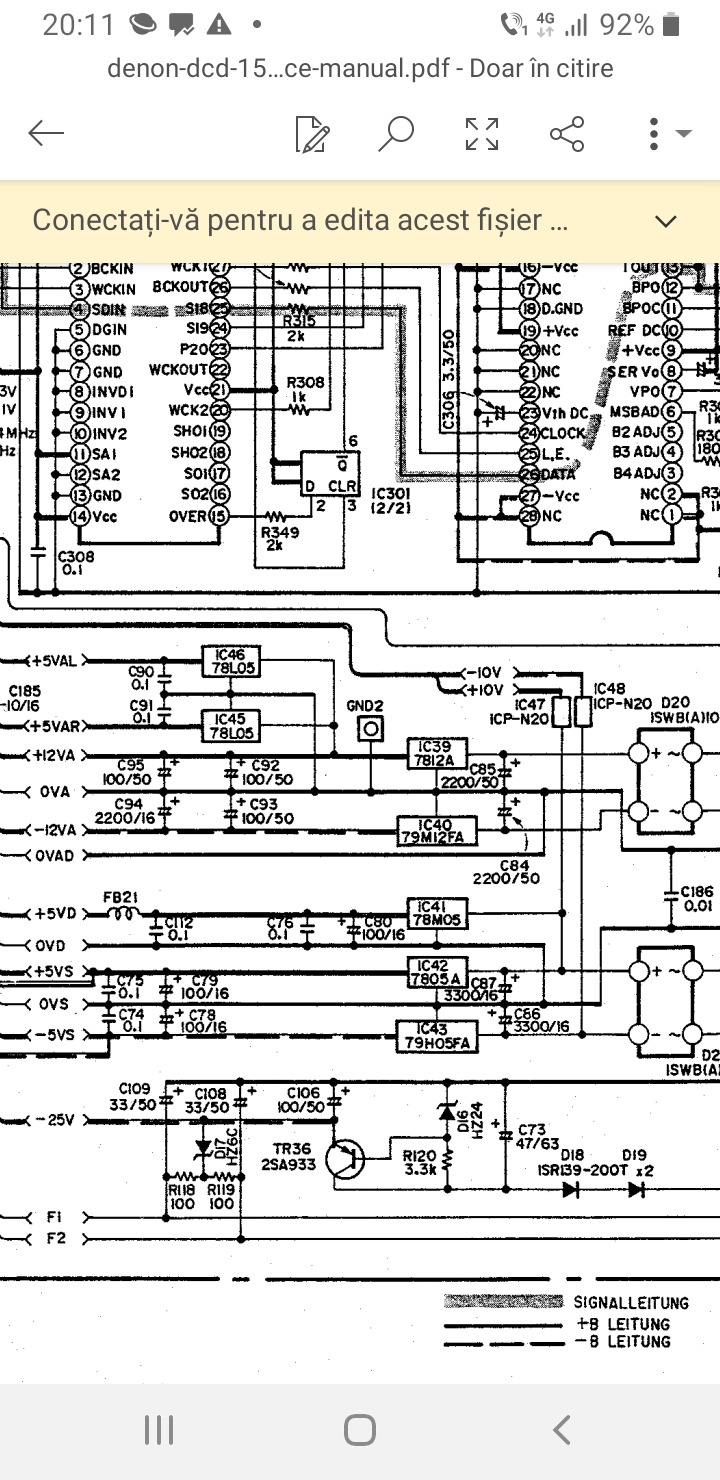

It may have the motors or the transport on 12 v too...thus higher capacitance after lm7812 can't hurt...Denon used the beefy AWF 2200uf before the regulator and some smaller size caps that i don't remember after the reg but you can see 2200uf on the output of -12v line too.The analogue 12v lines aren't entirely audio analogue lines here as they supply also some more +-5 lines in series and the +-10v transport supplies... Didn't study the sony though...yet i'd stick with the original values.Nippon chemicon avf weren't ordinary low quality caps.

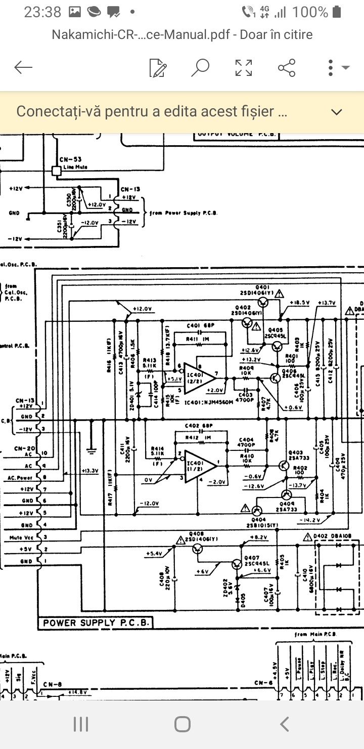

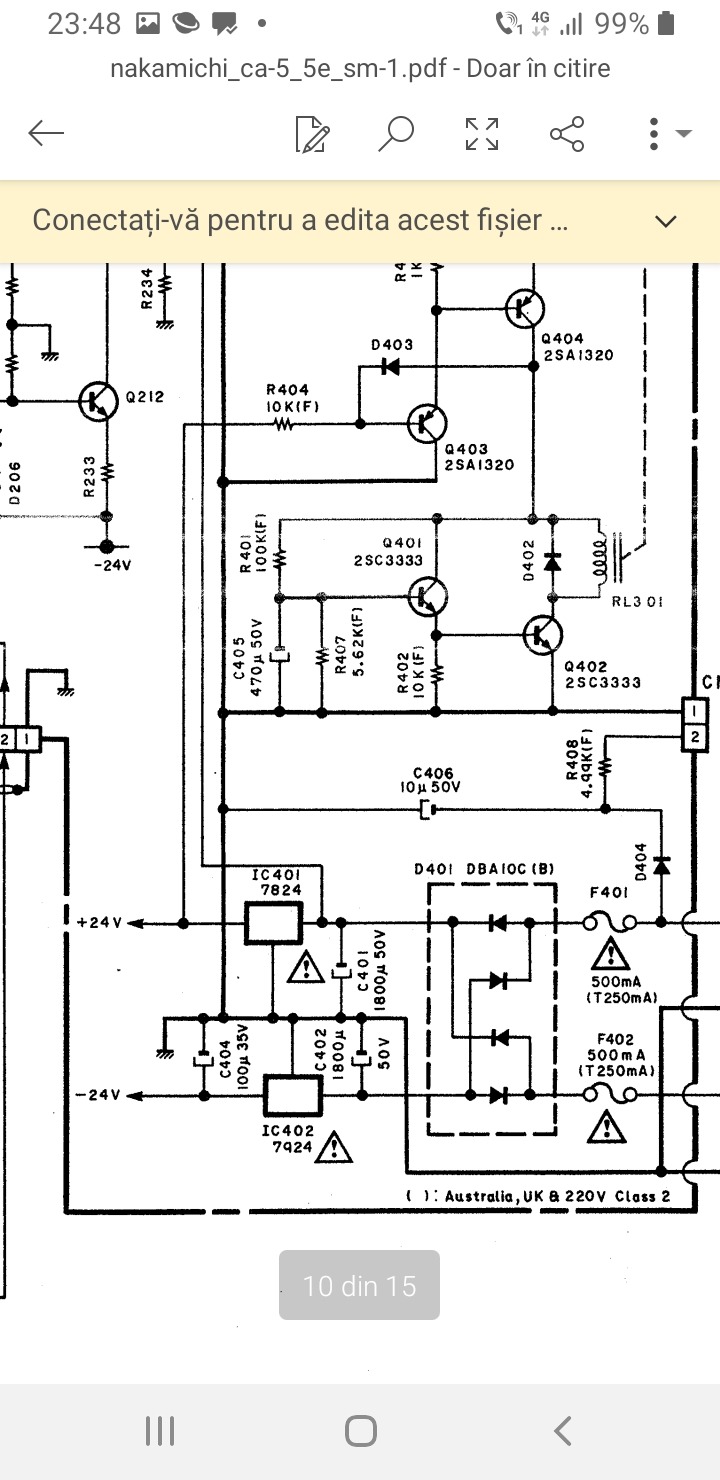

What flaws had the lm78xx had that a minidisc player could make "use" of? This is a 90's equipment yet I built tons of VERY GOOD DIY circuits based on 78xx regs and huge output capacitance with no problem whatsoever.On the contrary 78xx regs are some of the most rugged regs ever made.I saw them in million euro medical equipment as well as in hundreds of thousands industrial equipment in all sorts of configurations and never found a defective one...
You can double the internal emitter-collector antiparallel diode if you fear too much capacitance on the output will damage it, but there's a reason why there's no recommended antiparalel diode in most datasheet...
Here's the thing:
with minimum output capacitance you fight internal oscillations in low drop regs but 78xx is NOT a low drop reg.
with huge output capacitance you cancel the regs own bandwidth , you make it a simple low speed voltage regulator and rely on output capacitance's low esr to fight the transients while completely killing feedback noise...Either way it works . It's the most unusual strategy for the optimal designer, but it works as much as it worked for Nakamichi cr4 cassette decks.Besides 7812 and even more the 7824 are proportionally slower in their feedback loop with respect to lm7805 and that is a good thing once you load them with big output capacitances.
Every time i say that i have no feedback and i undestand it...as these overloaded regulators don't rely on feedback speed, but on capacitor's sheer ability to fight transients if they are big enough.78xx regs need a minimum input capacitance, but have absolutely no upper limit for the output cap size and actually some datasheet say they need no output cap at all....
Even Nelson Pass nakamichi ca 5e control preamp that has also a mc-mm phono preamp use 7824/7924 regs...
http://www.audiophileaddicts.com/2015/01/nakamichi-ca-5a-preamplifier/

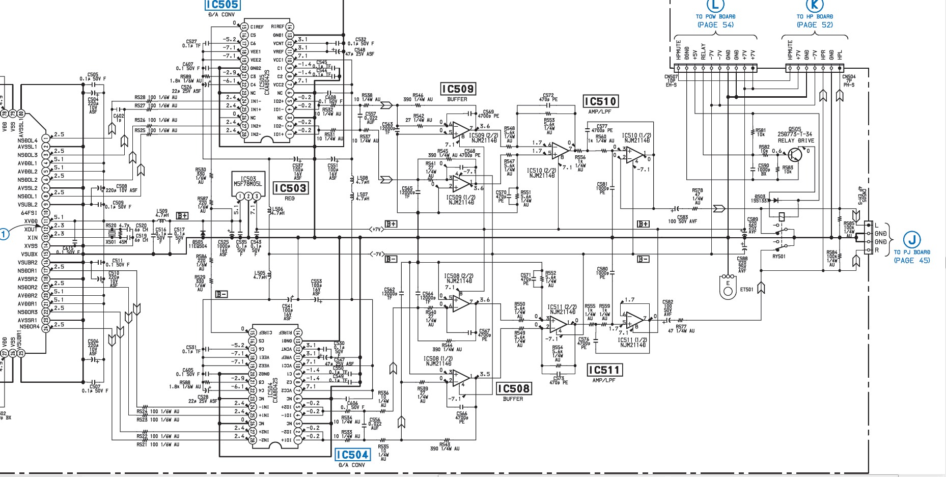

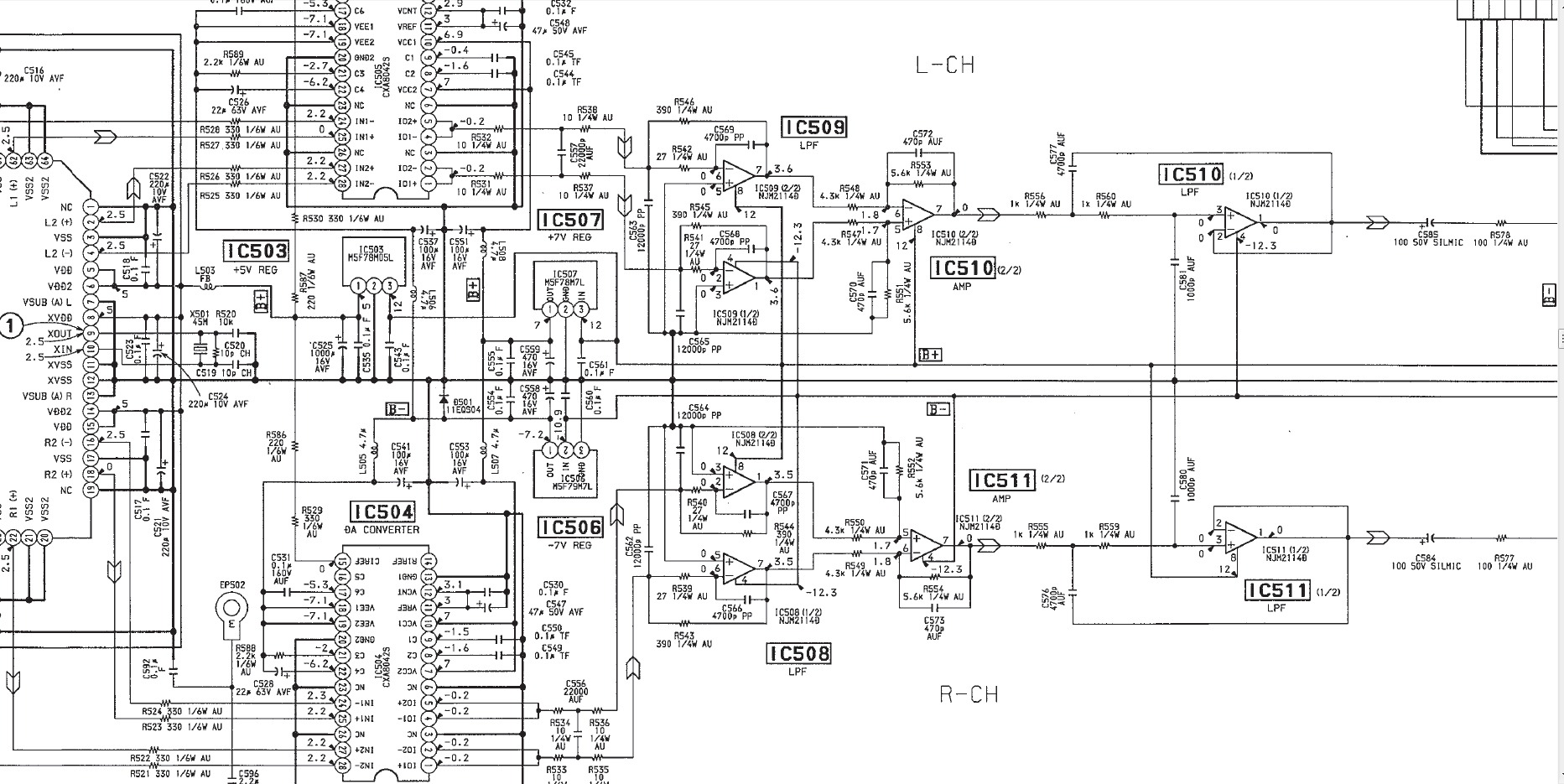

The noise will only increase with higher supplies while the needed dynamic won't usually exceed the output signal of the i/v converter...2v rms is the usual standard so +-7v or +-8v are reasonable supplies .It all depends on the satutation voltage of the op-amps internal transistors and the input common mode max voltage before you get into hard clipping.I have no ideea what njm2114 op amps can do, but i suppose the manufacturer of that cd player knew their game.If you chsnge the op amp with a more modern one you better check its minimum supply voltage and input common mode voltage against the old one.

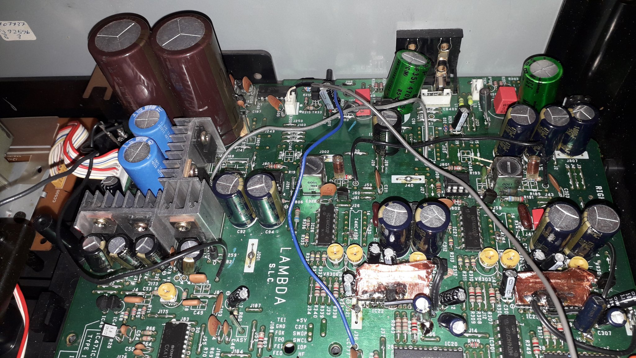

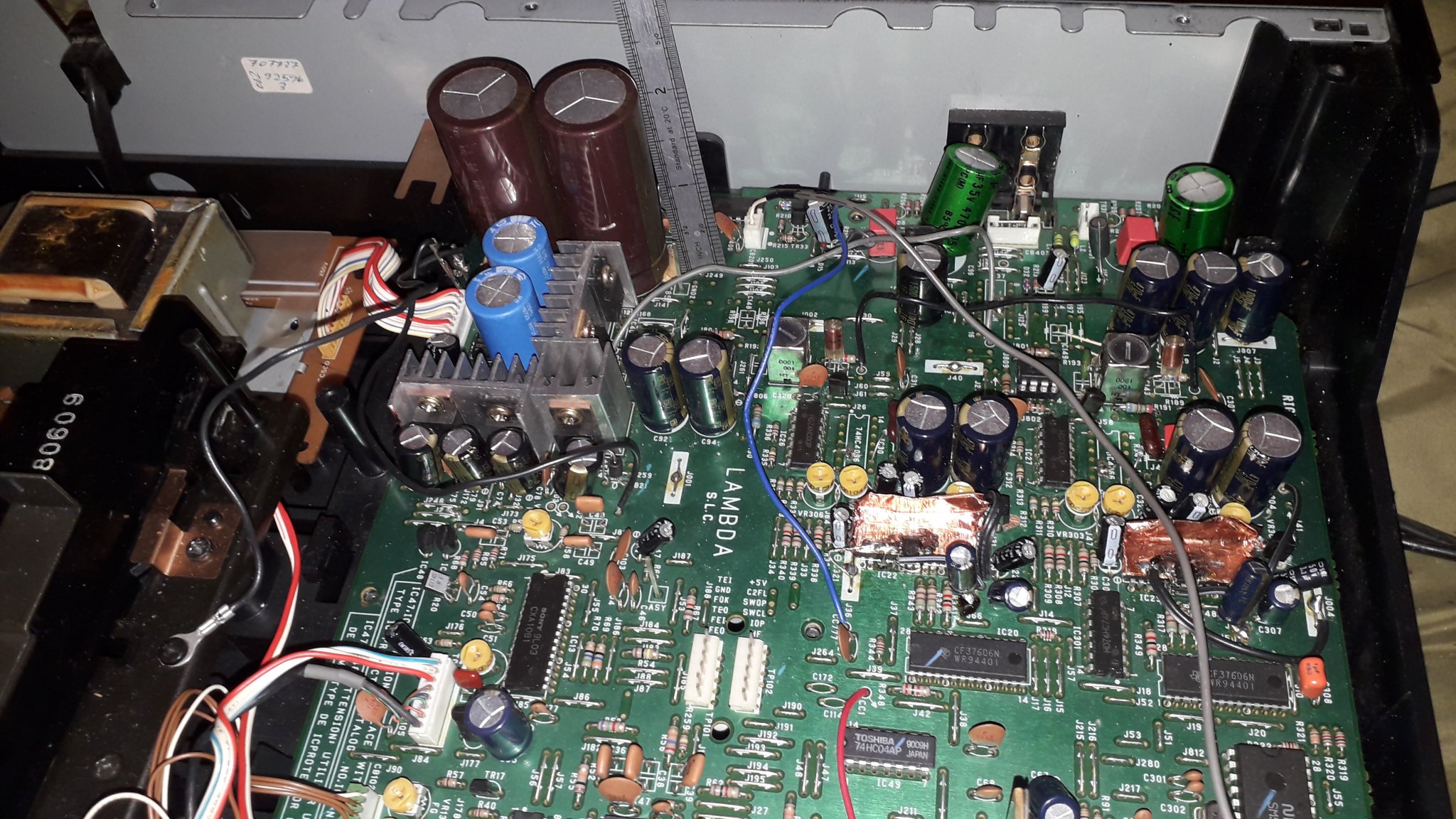

Guys, how can I replace the 3300uFx25V capacitors from Nippon Chemi-Con AVF ? These capacitors are installed after the 7812/7912 stabilizers and power the operational amplifiers. The size is limited to a diameter of 16 mm.
I just looked on Digikey, and there are three choices in stock for 3300uF 25V United Chemi-con capacitors with 16mm diameter, and there are other choices even smaller. Are you not familiar with Digikey's and Mouser's search engines?
What do you want to achieve?
Nichicon rarely fail. No point in replacing until you have a problem, which has not been described.
Op amp output swing is proportional to input voltage, so I would run a device at 80% of rated voltage.
Sony ran STK modules at 90%, their choice.
Check the op amp voltage ratings.
So first, what is the problem?
What made you decide to change only those capacitors?
