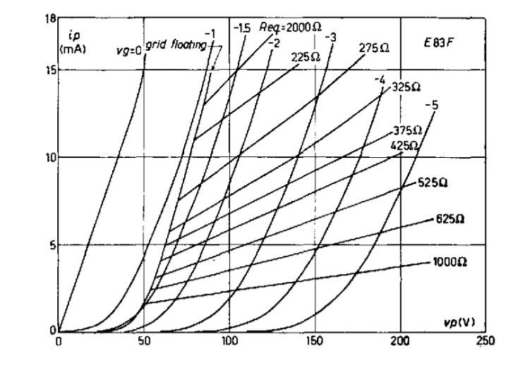

You might try to connect the EF 184's as triode; apart from this I would also get rid of the input capacitor which is superfluous.
6LQ8 is my bet.....i mean a 6bn11 if you want a pentode pentode ltp..
just wondering, why do you need all that gain?
Lower gain to EF184 is E83F (mu=40)
Great tube, and one of the tube with least noise.
Here is E83F triode curves:
