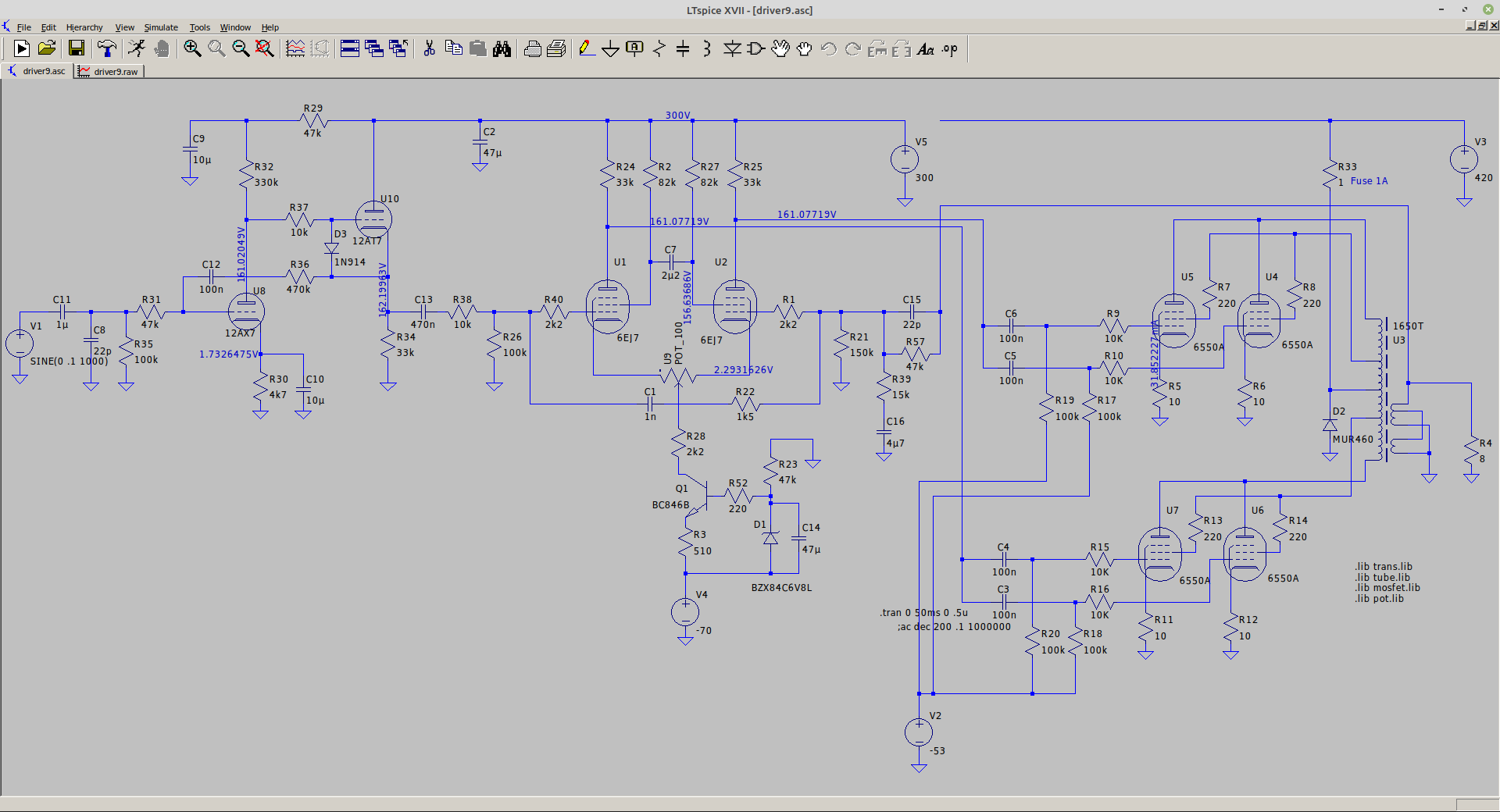

Could somebody suggest a lower gain alternative to a EF184 in a long tailed pair same pinout. Still would like Va max of around 350v.

Can you post the actual circuit where it will be used?Could somebody suggest a lower gain alternative to a EF184 in a long tailed pair same pinout. Still would like Va max of around 350v.
I can imagine lots of ways to lower excessive gain, from NFB (if used) to attenuation to, well, designing it with lower gain.
Tube rolling looks like a blunt instrument to me.
And it´s neither easy nor foolproof, changing tube will certainly alter other parameters, starting with bias or working point.

I went for high voltage gain in the LTP as the original design takes the GFB to the LTP stage - this is unconventional. If taken to the cathode of the first stage then the gain of the LTP does not need to be so large. In that case I would DC couple the first stage to the LPT and do away with the CCS to the negative rail. Its for a new design.

A lot of thought must have gone into the Citation II there's quite a few FB paths and a lot of low impedance drive. I need about 1-2W anode power dissipation sorry should have said this earlier. There's also compacton 6J11.
Looks good on simulation about 40% of the voltage gain and obtainable too - cheers.

You mention that you need less gain. Is that the only problem? Look at the first two stages of the amp. It has a 'shunt feedback stage' or 'anode follower' happening, with R31 and R36 defining the negative feedback. Perhaps reduce the value of R36 to get the gain you desire? That would be a lot easier than redesigning the LTP driver stage around a different type pentode.
