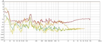

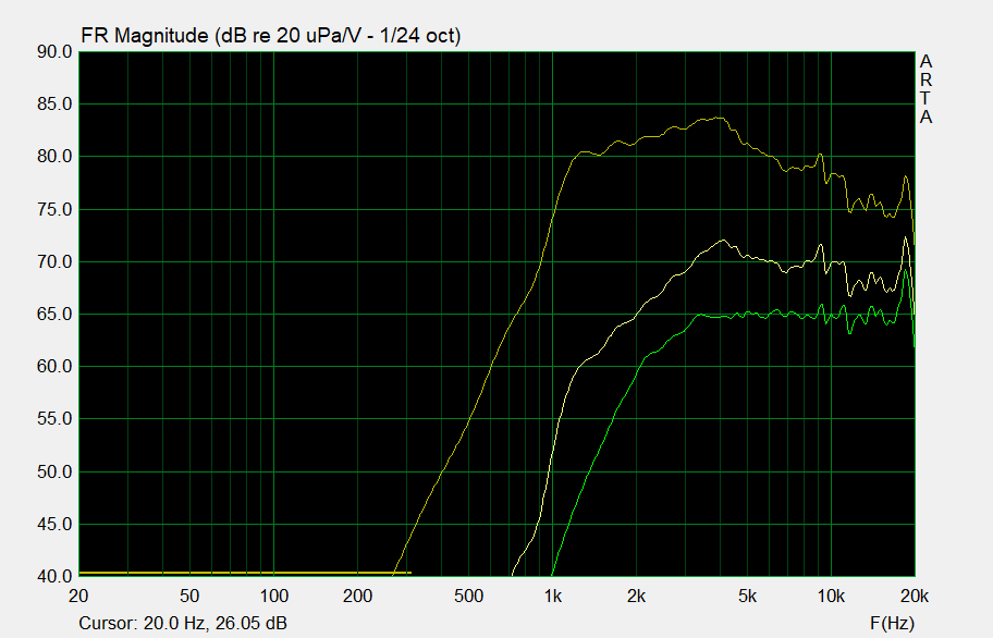

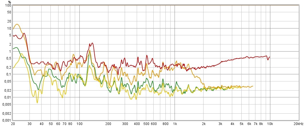

Tried to take distortion measurement with ARTA because the other hf10ak I have had audible distortion while measuring frequency response. Never done before distortion measurements so might contain errors, but the relative results are legit I think. This is naked driver without any waveguide, mic was 1 meter away as I was measuring the whole speaker and the rig was there so.
Anyway, number 2 of my drivers as baseline, no audible distortion while doing sweeps. No idea what the SPL level was, but nevertheless, this one didn't sound distorted on low frequencies during the sweep while the other did.
the other sounding nasty measured like so
And then opening it up and repositioning diaphragm as well as tightening the back cover back again made difference but still there was slight audible buzz, not as bad, but there it was, while measuring frequency response.
Then opened it up again, there is small wiggle with the diaphragm placement, like half millimeter or so, ridiculous. Then when one drops the back cover on the assembly can still move until screws are tightened up so its pretty much hit or miss... This time better success, almost as good as the other driver so stopped here.
Thought to post this, if anyone ever drops one or opens it up, be sure to compare distortion to the other you have to find out if the diaphragm is centered / damaged. I think this one is the one I opened up several years ago but never checked if there was issues with it, I've been on single speaker mono up until now when noticed the issue. It might also been dropped at some point during the shelving years.
Distortion looks nice past 2kHz. If one is going to use it below this then it doesn't look too bad either, there seems to be almost no difference between 500-2kHz, although I'm not sure how legit the measurements are so take it as is 🙂 No quarantee about audibility other than when one shoots towards 10% it definitely was audible.
