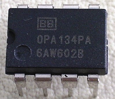

It's pretty easy to breadboard an opamp and check the major specifications. If somebody is faking chips, they're probably doing it with cheaper and less capable parts. You should see out of spec currents, offsets, or bandwidths. Hey, if they sound the same, maybe audio isn't as fussy as we thought? Bob Pease has written some good articles on testing opamps, and how to infer one hard to measure thing from another easy to measure thing. Check old What's all this..." columns, or his analog book. There are probably fake chips out there, but you can't tell from the markings and packaging, as these change on real parts quite frequently.
