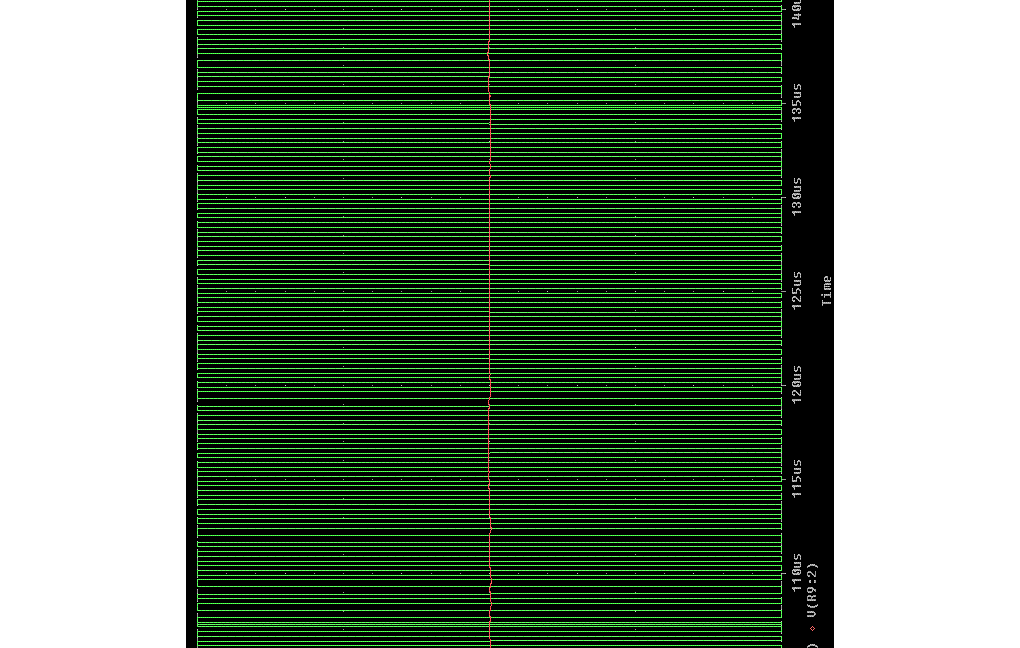

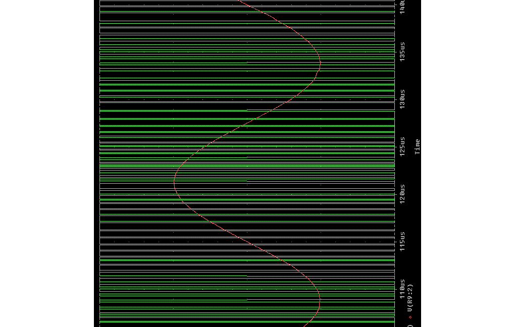

The problem of high switching frequencies is only a problem for no or very low input signal levels.
Enclosed you will find the simulation of a hypothetical class-d amp using SD modulation. The signal frequency is 40 kHz. One can clearly see the phase of the sinusoid lagging behind the switching pattern due to the output filter.
