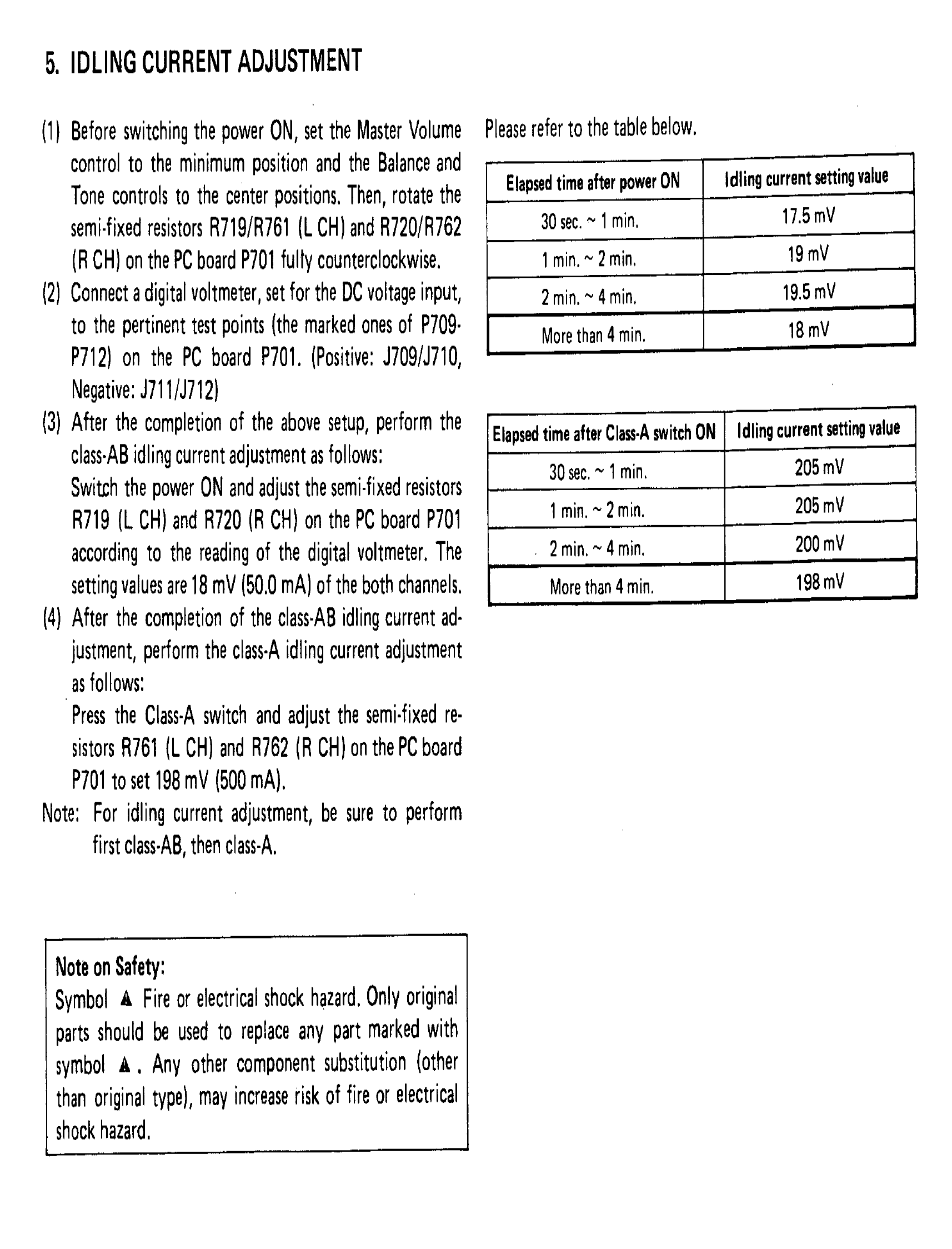

Here is something interesting :
We all expect one to replace the 3102 , check soldering , check the known relays issue ,replace a few capacitors , set the bias and done...
I also expect "techs " that simply replace the 3102 and give away .
Point is that in the first case and when one wants to set the bias will look at the service manual and bias the amplifier accordingly .The problem is that the service manual is written WRONG !!
It states that at bias points bias should be 18mv over a resistor 0.18R and that equals to 50ma ......Obviously this wrong since this equals to 100ma
farther more in the high bias condition 198mv over a resistor of 0.18 that equals to 500 ma Obviously this is also wrong and equals to 1A
Pm 80 features both neg and pos test points and what the missed to print is that the sum of the two redings ( pos +neg ) should be 18mv and 198 mv respectively .
Cannot tell if more than double the bias will stress the IC but obviously in total the heat will stress the amp and produce fatigue of parts and soldering .

Depends on how you interpret Marantz's instructions.
The way I interpret the instructions is that you connect the probes across BOTH resistors. That way you measure across 2 x 0R18 and the printed values do make sense after all (although 198 mV across 0R36 is, of course, more than the 500 mA mentioned 🙄).
The reason I believe this is because many contemporary (and later) Marantz amps like the PM40 and PM82 used 2 x 0R18 resistors in a single three-pin housing. You were always instructed to measure across the outer pins, i.e. across both resistors.
