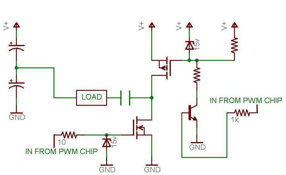

Hi lumanauw,
The circuit you have shown using p-channel and n-channel MOSFETs looks rather complex. Since you are using p-channel MOSFET as high side switch, implementing the simple level shifting method, the circuit can be made much simpler than what you have shown.
The two external driver ICs could be eliminated and an NPN transistor-resistor-zener could be used for level shifting the p-channel MOSFET while the n-channel MOSFET can be driven straight from the PWM chip. If you are using chips like SG3525, gate drive current should not be a problem as the SG3525 (with its internal totem-pole stage) can provide enough current to drive the MOSFET at frequencies greater than 100kHz.
What I have just said can be easily understood if you look at the circuit I have attached here.
To everyone,
I have not used PCB but have tested the circuit on verroboard / stripboard. I have used my circuits successfully upto 132kHz with no problem. The only consideration, as what I see, is that the tracks/ traces should be kept as short as possible. Decoupling capacitors should be placed where necessary and should not be omitted.

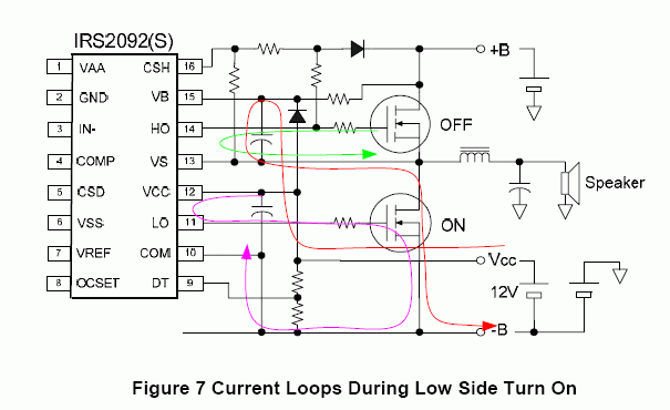

This is what I understand from fig.7 of IR's AN-1135
The lower mosfet turn on is the pink loop. The basic thing is that everytime a current is sourced, it must come back, in this case the +/- of the capacitor.
The loop started as charge stored in the +cap (this cap is the one between pin10 and pin12). This charge goes to pin12, then sourced by pin11, goes to lower mosfet's gate.
After going to the gate, this charge has to come back, from gate it goes to lower mosfet's source, flowing in -B rail, and ends at the -cap (the one connects to pin10). This means that cap has to be a fast one (tantalum or ceramic). Many designs put electrolytic//with 100nf. I think the charge of this loop goes mainly through the 100nf, not the electrolytic cap.
This agrees with loop formula, the current goes in and out should be 0.
Usually the analysis stops at the mosfet's gate, and overlooked what happens next. This fig. helps me to understand the loop. The path from mosfet's source until -cap has the same importance as the path from +cap to mosfet's gate, since they carry the same charge. If the later one is bad, the former will be affected with the same degree.

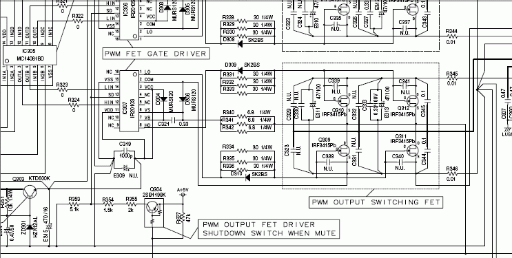

In this schematic, the charge starts as +cap of C319, to pin3(Vcc), to pin1 (LO), to mosfet gate (Q309-311), to mosfet source, to R346, ramping through -rail, then go back to -cap of C319. The problem is that C319 is only 1000pf, E309 is not used. This means, the charge has to travel a longer way to the -rail+12V generator (Q303's capacitor) E315 (on the lower left).
