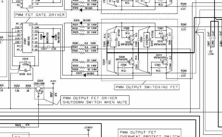

A discrete high side driver would be more complex. IR2xxx actually result in simple drive circuits with very low part count.
Every major semiconductor has their own high/low side driver. Like UCC27200 from TI.
If you want to skip these driver IC's, make class D with common source Pch/Nch mosfet, you don't need these drivers.
There are no high-performance P-channel MOSFET with Vds ratings above 100V, and the ones rated at 100V or less exhibit too high Rds-on and charges/capacitances in comparison with N-channel devices.
You get increased performance and efficiency in return for the complexity of high side drive.

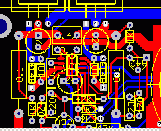

I'm blowing high/low mosfet driver like popcorn here. They seems so fragile. What's the secret to work with these IC's during development/experiment stage?

Could you show us the PCB layout and the schematic of the circuit that is so prone to blowing IR2xxx?
And where is the ground plane? 😕
The bootstrap capacitor is by far too small for audio class-D
The low-side current sense resistor is in the gate drive loop and in the HB/HS clamping loop
You clearly have some good keys for success 😀
I place all my gate driver ICs and modulators in daughter boards and I use continous ground planes. I would never sense the current in that way, too. All this is for good reasons...

Why is when I blow the output mosfet, the driver always broken too? In experimental stage, how to preserve the UCC27200 whenever the output mosfet is blown away?

Do you mean the Vss for the UCC27200 should be taken after the current sensing resistor?The low-side current sense resistor is in the gate drive loop and in the HB/HS clamping loop

The driver is probably blowing up first. Then the MOSFET fail too. You don't need such a fast driver for 300Khz class D, it's completely overkill.
Concerning the Vss connection point, isn't the reply obvious enough? 😉 Think abut the disadvantages of connecting it before the resistor (many!) Remember to move the ground of the level shifter too, and you could also move the sense resistors to the output side of the inductor too...

I'm using floating 12V to make -VCC+12V (supply for gate driver). If the level shifting point, gate driver gnd, all placed after current sensing resistor, then this floating 12V also should be connected after this current sensing resistor too? What happens if this resistor fails?
Current sensing after inductor? Nice idea. Then the feedback point should be moved after this resistor, I think. Needs bidirectional current sensing?
Thanks for the tips 😀
But here the current-sensing is done outside the gate-drive current-loop if you have a close look.

Hi Lumanau,
parasitic resonances tend to kill the drivers.
You can have killed drivers even with surviving Fets...
Do you have screen shots of your gate signals at hard switching conditions? Please note these resonances are fast (typically 10MHz...100MHz), so you need a fast scope.
