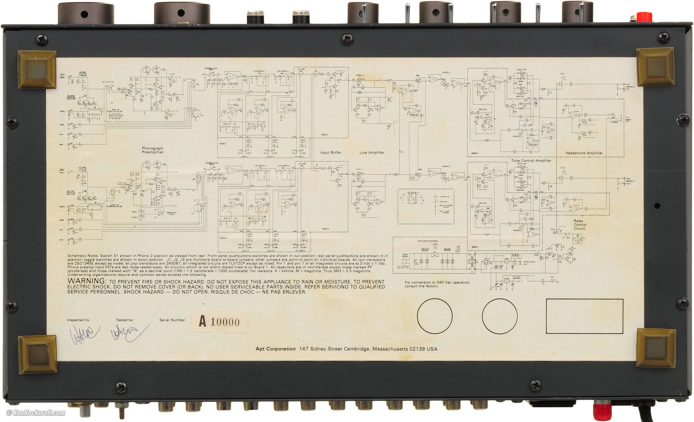

Id argue that the feedback transistor in the differential has to be faster and have higher transconductance than the input and rely more on the feedback to fasten the seat belts .I dont see the argument for a linear approach in the differential when using feedback...I believe theres a prevalence of lowering distortions over the objectively perceived noise in the apt-holman aproach, although an argument for the cheapness of the circuit can be readily made too....
