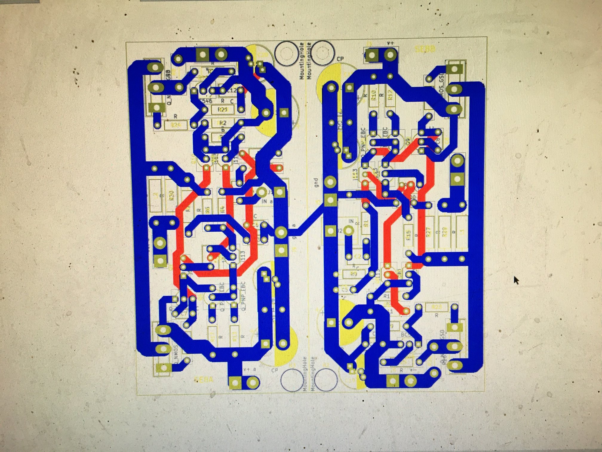

Begin with make a PCB for this a little more simple amplifier.If the schematic is not too complicated, I can offer to design a pcb.
https://www.diyaudio.com/community/threads/exapp-class-a-push-pull-6-watt.397723/latest
Use only through holes components, Please. No SMD.

Hi Lineup and rest of the forum
Here is 2 ch pcb layout for your amplifier, I designed it for 2SK1056 as I have around 200 of them (NOS)
The basic idea with the layout is that you can have both channels on one large heatsink or you can cut the board in two to have a pcb on each heatsink, i will build it and give some feedback and i can also make pcbs available if any interest
Layout is made in Kicad and size is 4" x 4" (100 x 100mm) 2 layers, all through hole

I like where you're going with this, but I still like my pet ideas on mixed-mode and current feedback more. I need to up my pace!
The J113 current looks very heavy in a couple of places. Does it really bring down the distortion that much to run them so hot?
Elvee's Circlophone has an interesting idle current balancing scheme, which maybe could be adapted to single-ended..
