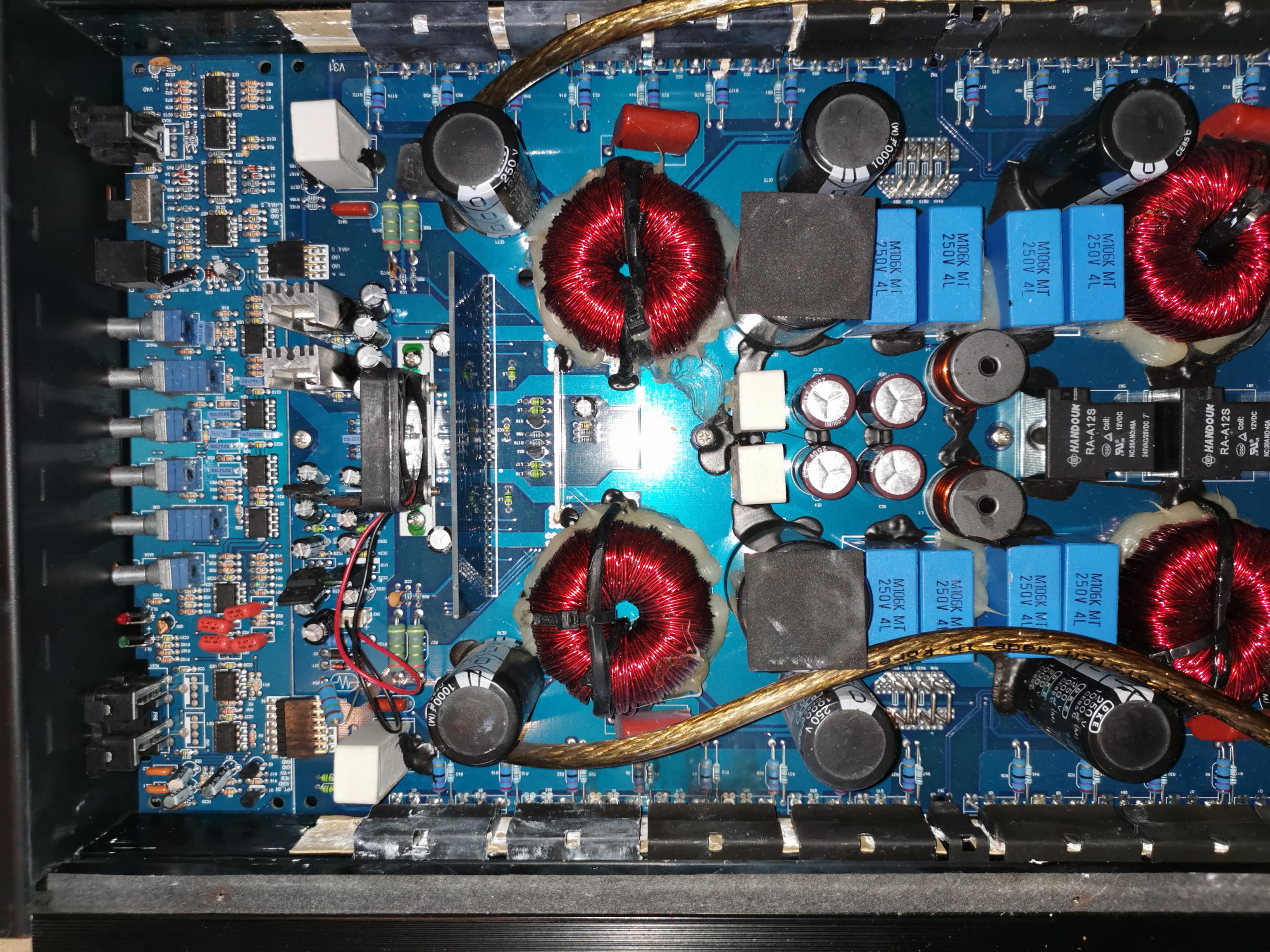

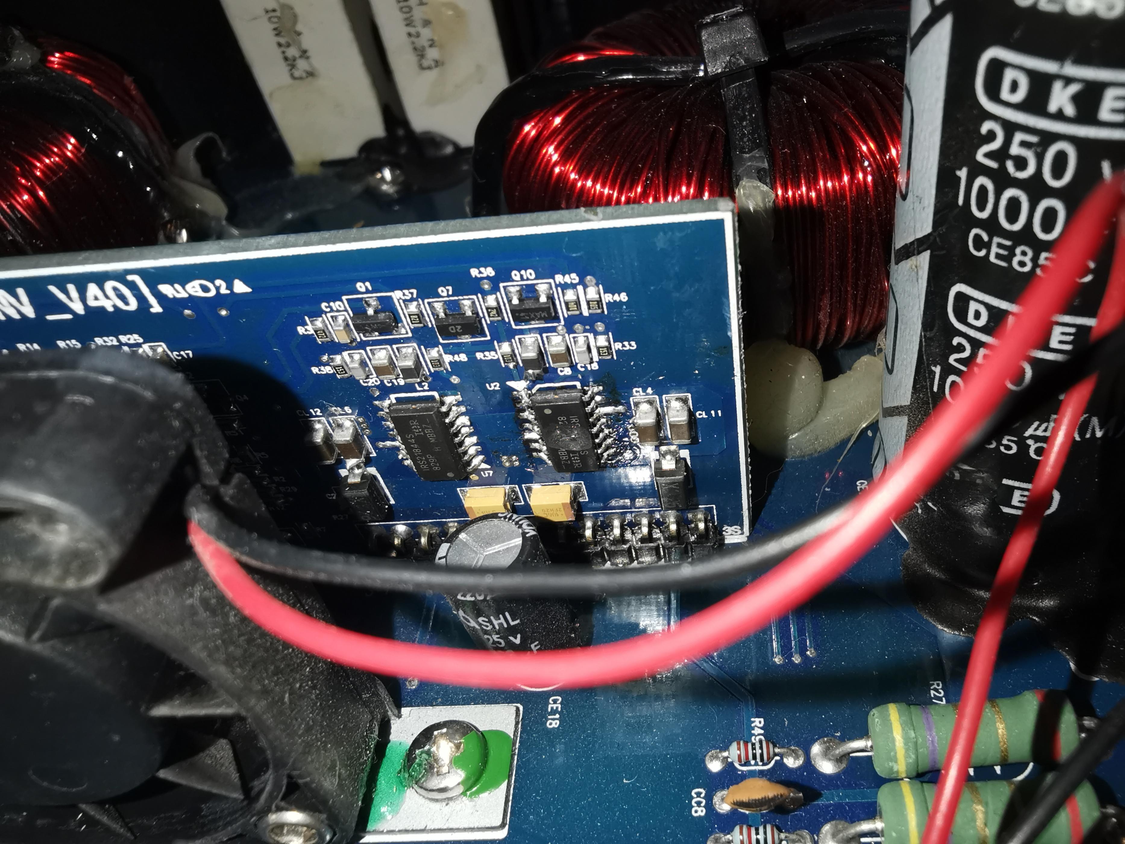

Hello again,
i think i made a mistake... The A1715 is a darlington Transistor with 5 Amps, the MJE has only 3 Amps....cant find so many transistors with the same package and as darlington. Its only for drive the PS Fets...maybe somebody has an alternative, or can i use the MJE? Will the withstand the current?
Attached find some pictures

For all of those FETs and the 494 with 180 ohms of pulldown, it's probably best to stick with darlingtons.

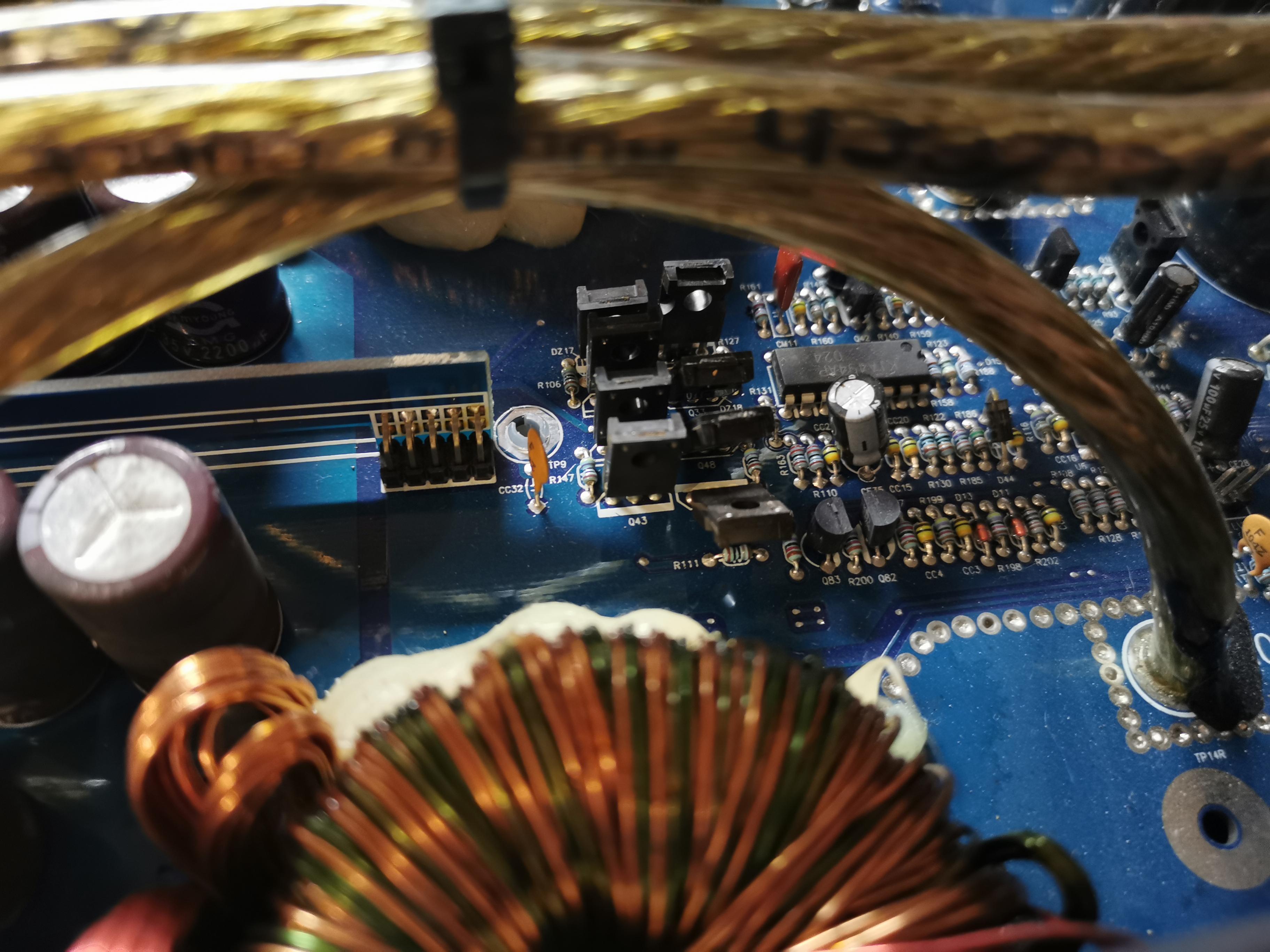

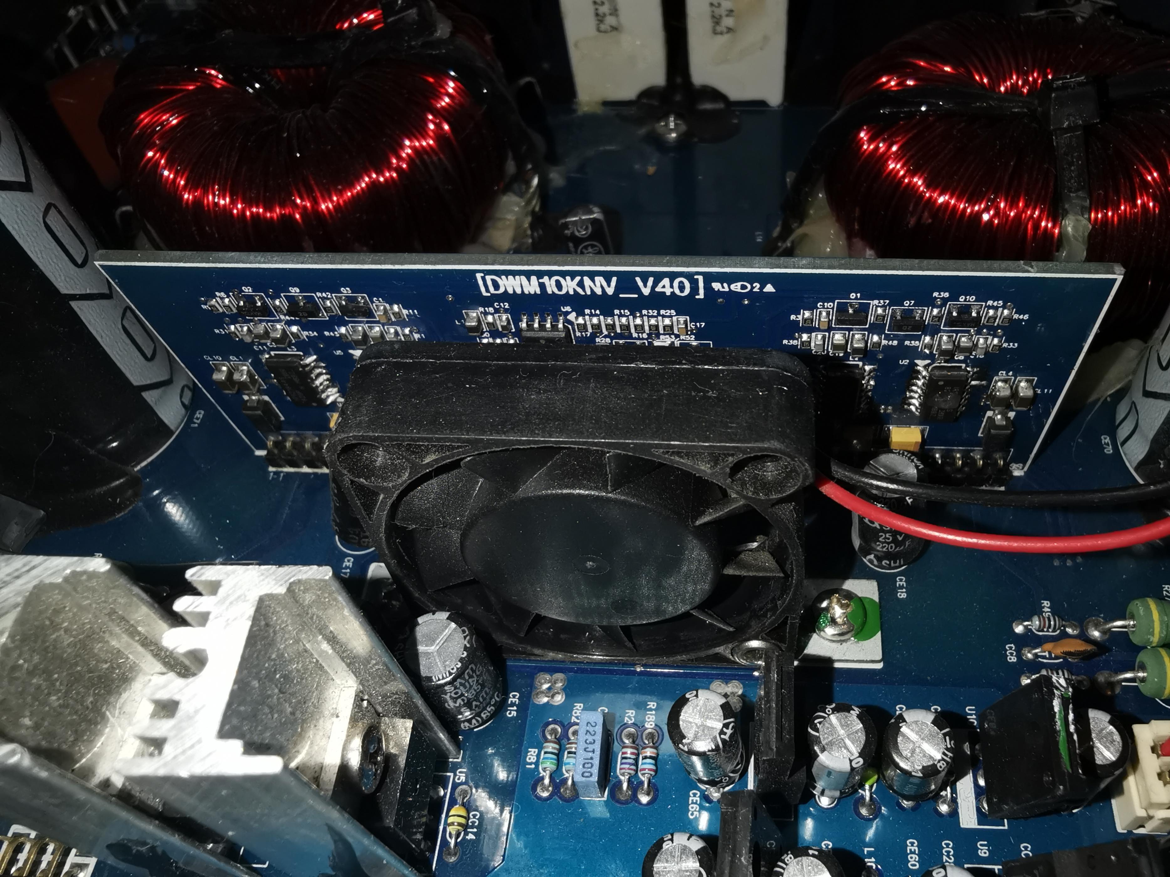

Now another Problem.
Renewed the Audio Section. Everything fine, amp plays music. But, when i switch the amp off, and in a short time on again, it blows a bank of fets in the output, also one IRS21844s is open. Happened two times now. Iam going to take out all fets aggain for recheck, but maybe somebody had this problem allready and know what to do?
