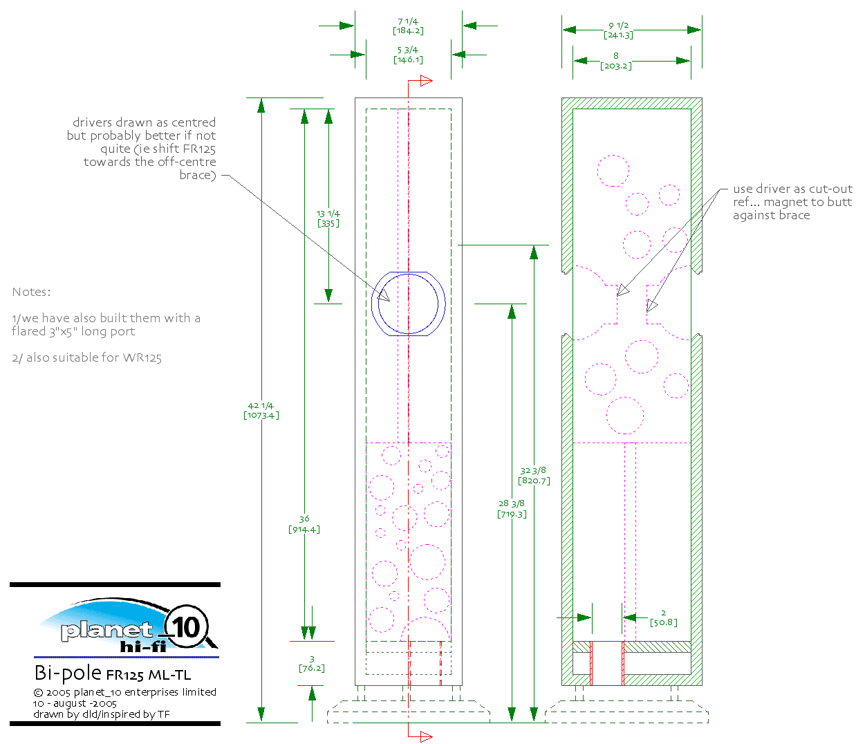

The proposed driver is a FR125S. The shallowest cabinet design is what I am looking for . Sealed cabinet would be simplest to install if anyone knows of a design that has been proven.

Any design can be used, just keep the cross sectional area the same,
or half it in the case of bipoles.

Both the FR125 & the Fostex FE127 work in a simple ML-TL. You should easily be able to accomodate one into the walls -- i've actually done just that with a set of diyAudio Ref FE127e ML-TLs (port exiting closer to the ceiling so the kids won't fill the port with ...
http://www.diyaudio.com/forums/showthread.php?postid=528564#post528564
These could be cut in half (lengthways) and used for the FR125. FR125 also works well in sealed (10-14 litres)
http://p10hifi.net/tlinespeakers/FAL/box-plans/P10-FR125-bipole-MLTL-map.gif

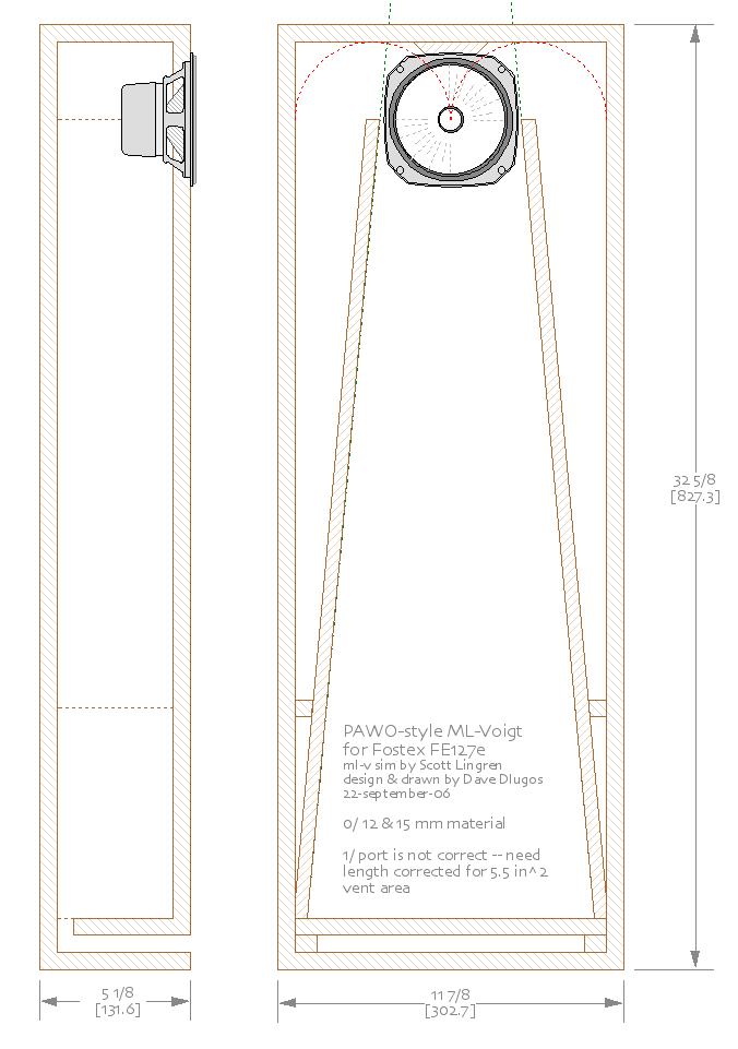

Dave, how about that WB 127 based folded quadratic taper design you did a little while ago? Should be ideal.
Scottmoose said:Dave, how about that WB 127 based folded quadratic taper design you did a little while ago? Should be ideal.
Yes, there are numbers for a Metronome for the FE127. As well i've drawn a Tombstone/PAWO format ML-Voigt for the FE127.
dave

Port length by memory for the WB design above needs to be between 1in & 2in depending on taste, & using the FE127E. The CSS drivers should go in if you increase vent length to 3in.
