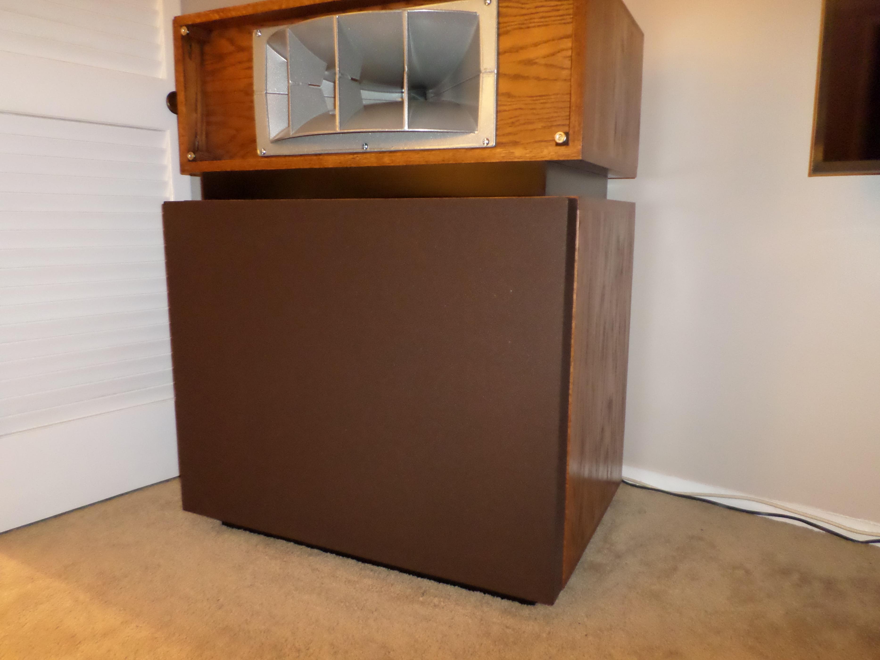

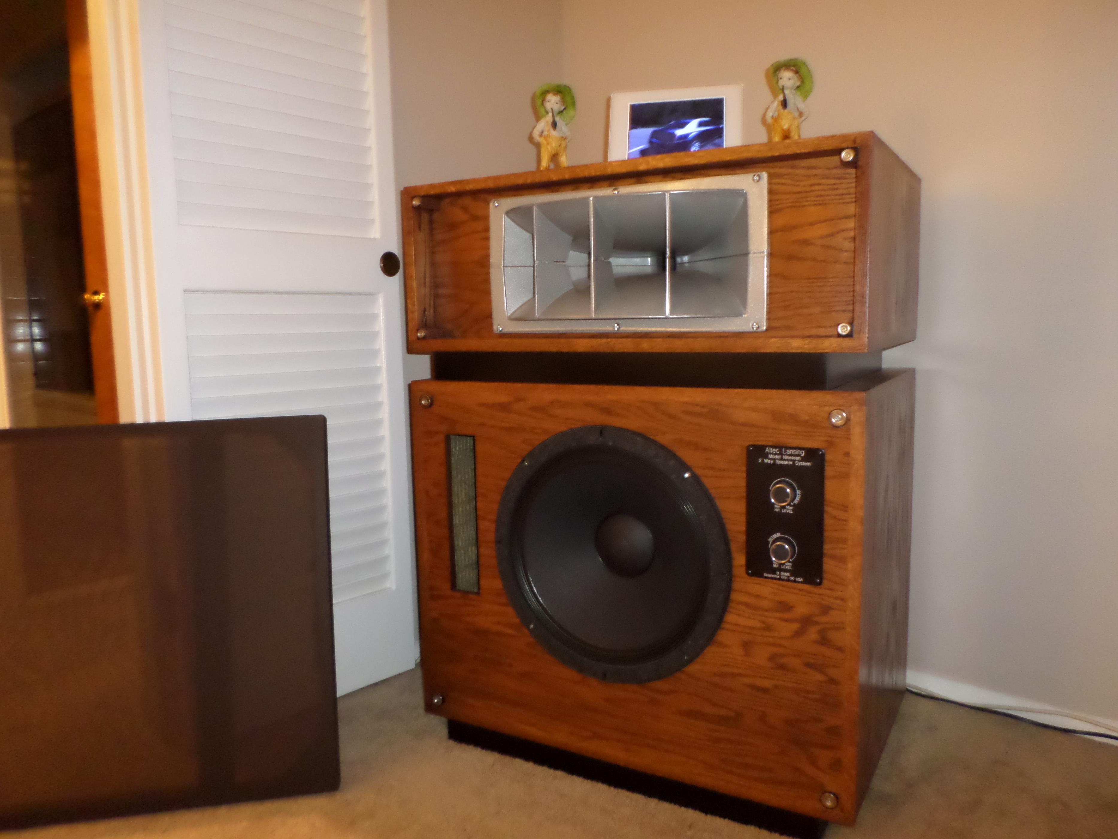

That's where I been all evening listing to music.......Mine sound correct...I used the Altec 19 building measurements... I posted pictures before but here is a few more..
Altec 19
I used magnets to hold the grills on...The grills are big !

The stock crossover works well for the model 19, it's part of what makes it a good speaker.
