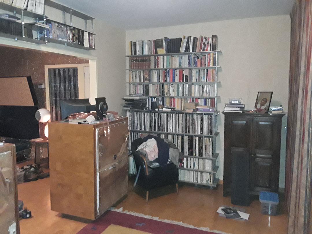

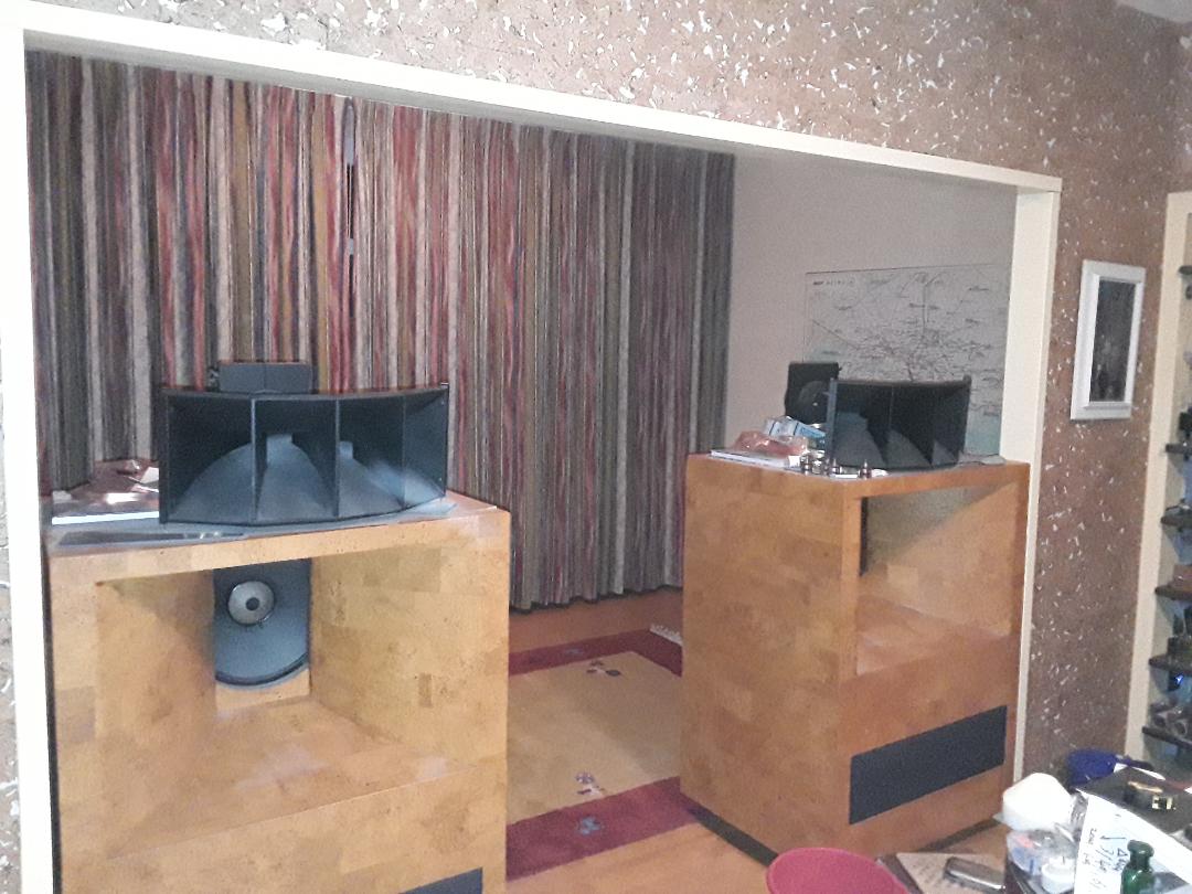

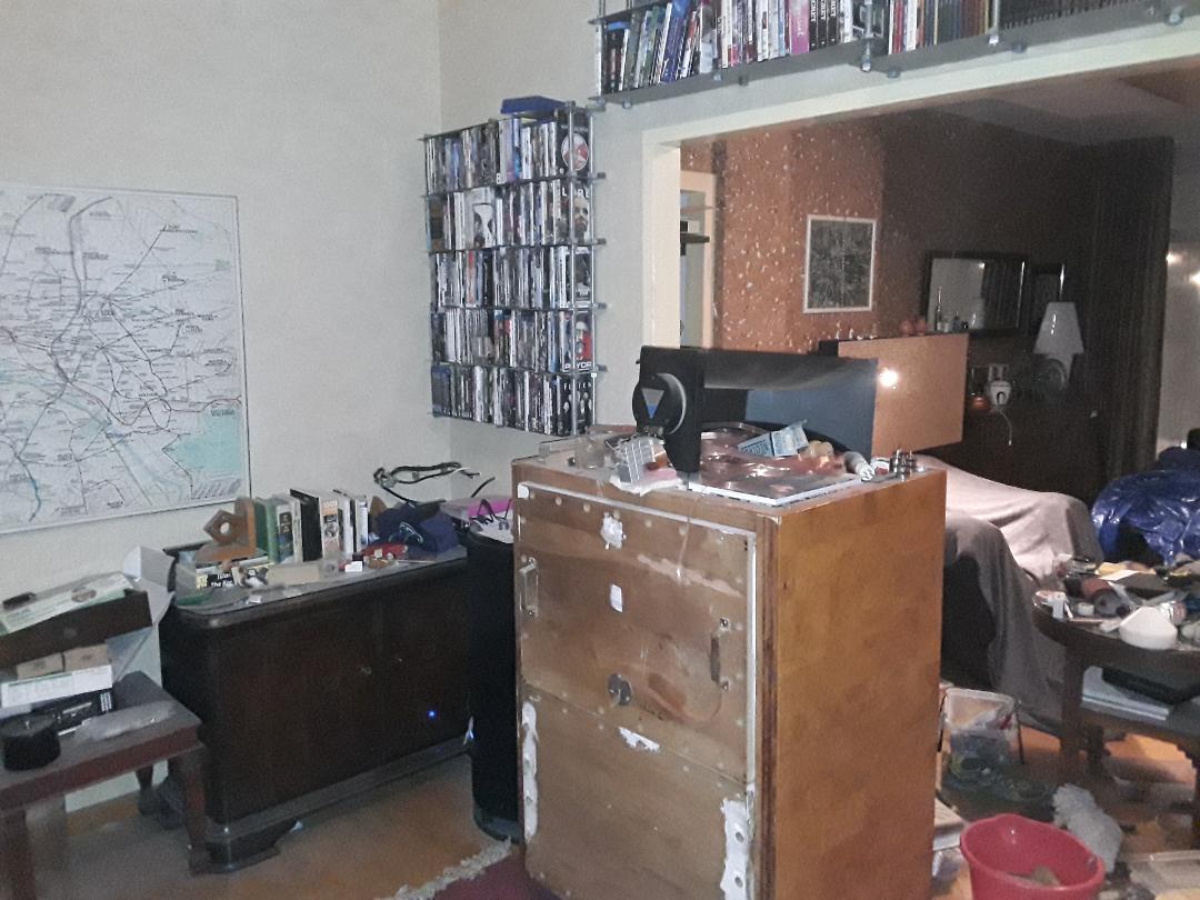

Hello,
When i bought my property some decades ago i brought my Altecs VOT and put them close to the corners of the room. Pointing the TAD2001 horns on top slightly to the center of the room to reduce reflections from the arcade like wall. When i moved in i tried breaking it down but i soon came across some reinforcing rods so probably it was more than a nice element with sliding doors to create a bit of separation. Neighbouring houses did change the shape of the arcade but in all 7 identical houses non of them is removed.
Removing the biggest part of the arcade would require an architect to do some calculations.
Because i changed the wallpaper in the major part of the room into cork tiles i asked myself why not change the position of the VOT. After all no matter where you put them nearly every new visitors first question is about my speakers especially non-audiophiles.
So in this position both VOT have a so called wing on the outside. Because the electronics connected to them need some work they are not playing yet. Pano, one of the experts here, told me to expect a deeper soundstage. Front of the speaker distance to the back '' wall '' is about 3 meters. There will be less reflected sound.
The distance in between the cork cabinets is about 1 meter so 3 feet. The TAD can be angled a little more in a straight line to widen the soundstage i presume.
At first my idea was to add wings on the inner side of the VOT too. Didnt want to drill holes in the cabinets so i thought about mounting two panels between the wooden bar in the arcade and the floor like a pair of saloon doors. I still have a few square meters of cork tiles like the ones on the wall.
BUT this kind of construction would maybe create to much of a room divided into two parts. Behind the speakers are my records and books so i will have to be there sometimes. This is also the sunny side of my house so i wanna enjoy the free light and warmth.
Because i just ordered about 65 meters of 30 mm diameter bamboo to create a kind of privacy curtain, artwork and diffusor in front of a balcony door the thought about using bamboo between the two VOTS popped up.
In front of the door i will hang two strings composed of one foot long bamboo shoots in a zigzag pattern. Because of the round structure and the zigzag i expect a kind of diffusion anyway better than a door mainly composed of glass.
NOW between the cabinets there are several thoughts, issues, questions.
I dont need to create privacy here so i can let the individual strings touch each other.
I could create a more open structure in the area situated above the cork cabinet by using not 30 but 15 mm diameter.
Wont the creation of a bamboo curtain in between the cabinets affect the depth of image? Then 30 mm in between the cork and 15 mm from where the TAD starts would be nice.
30 mm bamboo would create a nice '' up and down '' shape. Could even use bigger diameters but visually to big diameter will not look nice because the area between the cabinets is not big.
Would a closed curtain with all the bamboo strings touching each other be an advantage to make it function as a wing?
Maybe the wing should have a more solid structure like a wooden panel would have. Bamboo has nice acoustical properties they say but it is very light. Being hollow i could fill the parts with sand.
Any idea is welcome.

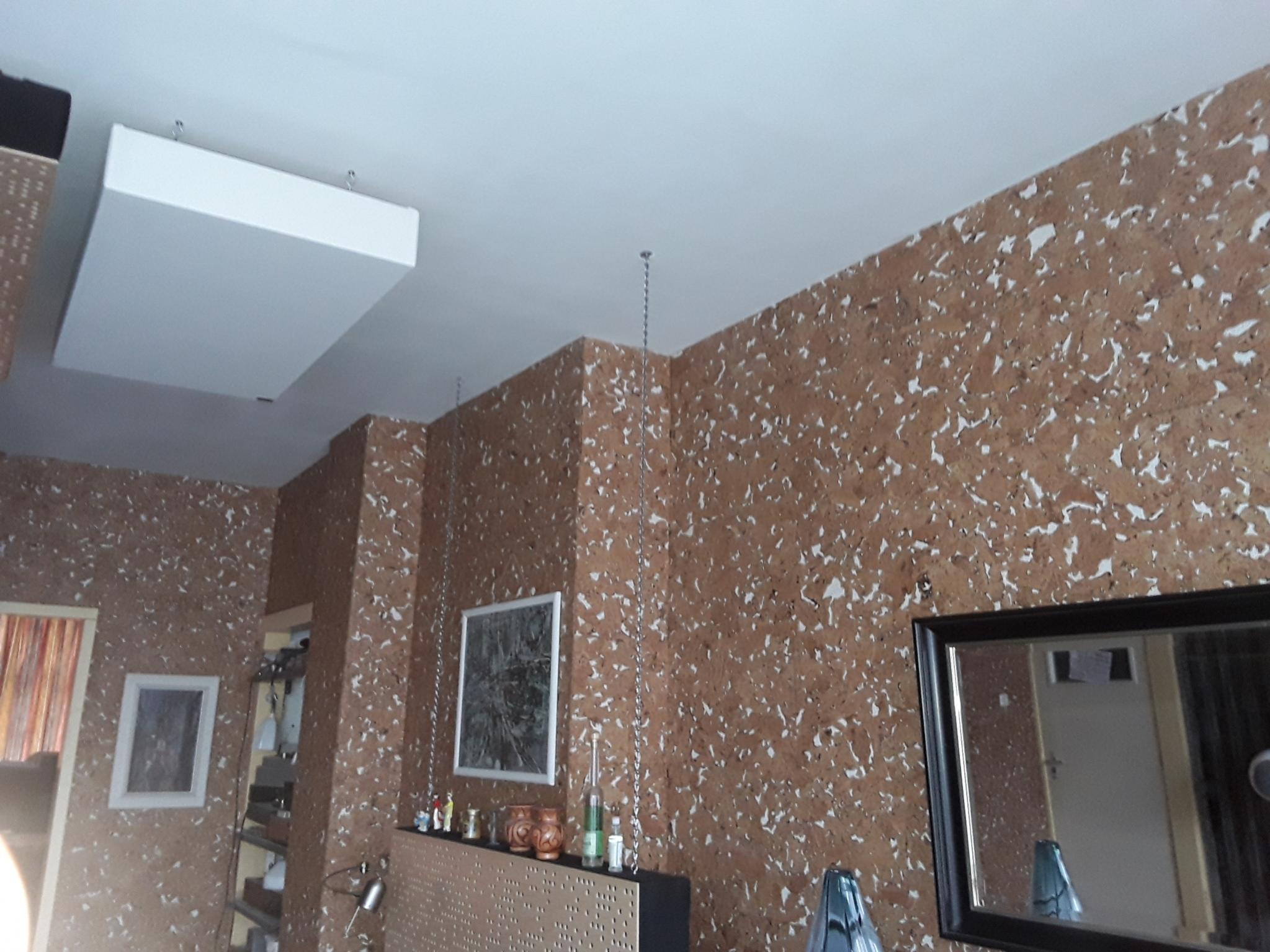

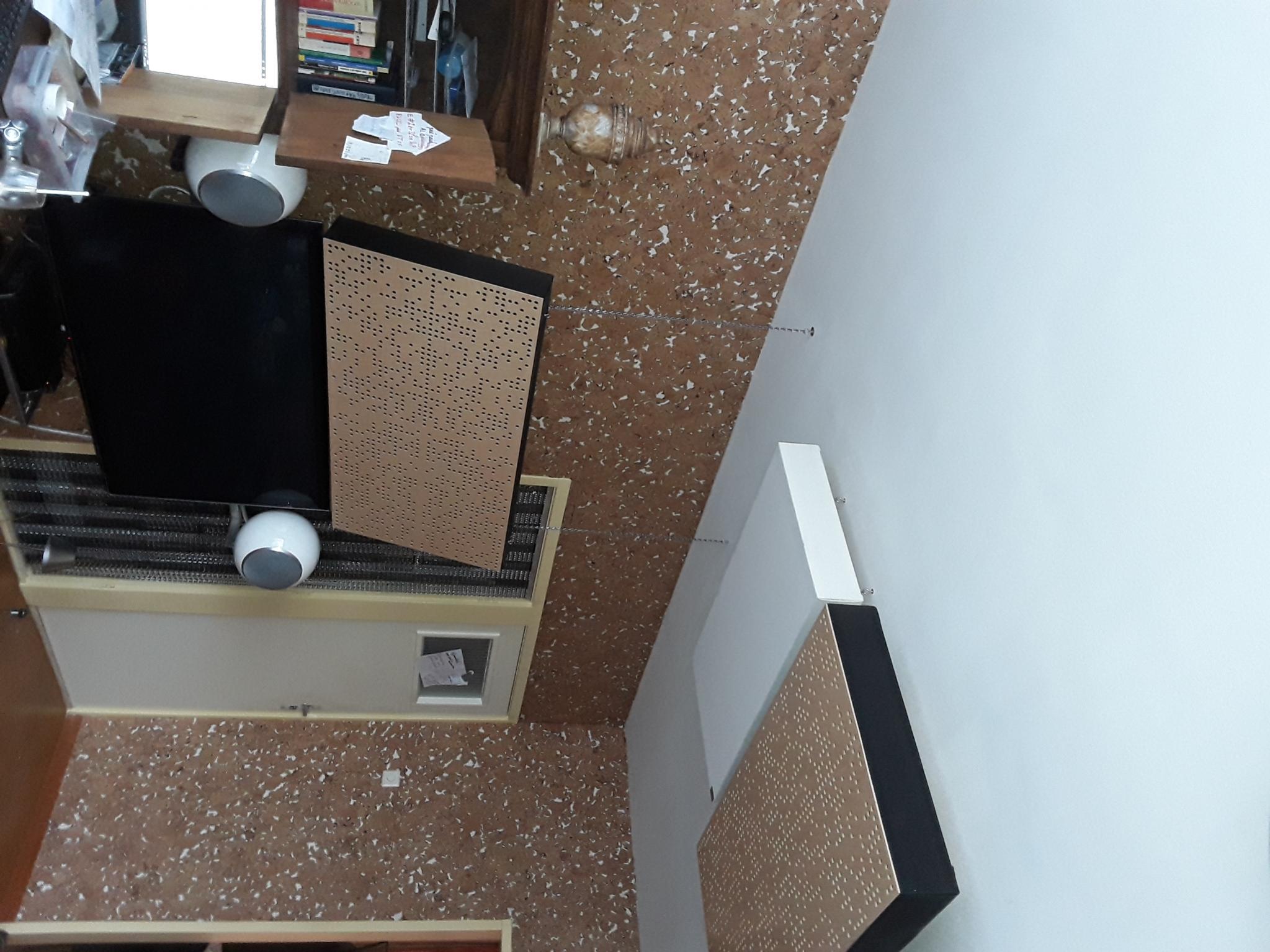

P.s as you can see i also installed a combination of diffusors and absorbers in the listening area of my room.
For my 2.1 movie set they gave a very welcome improvement

I can't say that I have much expertise, but perhaps it will help move the conversation forward...
I'll need to re-read the OP again at a later date, or perhaps you can clarify. I am not sure what the goal is (or goals are).
Are you trying to:
- 'block off' the room behind the cabinets?
- make a fake (movable) wall in the space between the cabinets?
- put something in front of the horns (LF, HF, both?)
And what is the goal?
Usually 'wing' additions on the VOTT help out with the lower registers, but in my opinion this would ideally require a tight seal with the cabinets. (not readily movable thus).
At the same time, diffusion is mentioned. What are we trying to diffuse? the HF?
So I guess the question to begin with - what frequency range are you trying to affect?
Hello,
The reason Altec introduced these so called wings was to improve the lower frequency range. As you can see in the photos on the outside both cabinets have a kind of wing because of the brick arcade.
I have to be able to pass between the loudspeakers to that other part of the room because that is where my records, dvd, blu rays and books are. After finishing covering the walls with cork tiles i thought maybe make some saloon like doors covered with cork. Maybe for a typical wing there are not many things to be considered because it will just be to create a bigger horn. But i could imagine that covering the wings with glued on bamboo tubes could act like a kind of diffusor . OR is this not what you need the wings to do?
If i created space behind my speakers to create a more spacious shouldnt i be worried by closing to much of the arcade? That is why my idea to have the height of the wings limited to about 47 inches.
Greetings, eduard
The honorable member Pano, told me creating more space behind the speakers will create more depth of image which is nice.
My impression of any structure designed to increase the effective baffle size (this is why we have wings, right? ) ...is that good practice is to ensure a good air seal. i.e. you don't want air gaps, lest performance will suffer.
* If wings are mounted on hinges in order to become doors, then you are adding a dimension of resonance which would be avoided with a rigid connection.
I think that at the frequencies for which the wings will have an effect, a (firmly attached) 'facing' material's surface profile / texture has little to do with the end result (the sound).
Adding sand to the bamboo cavities will be "mass-damping". Presumably that would lower the resonance (/ resonant frequency) of the doors themselves. (heavy enough, and this pushes the resonances down to where they are inaudible - but they might need to be made of concrete for that ?)
I think the 'big picture' here is that what you'd probably be doing with wing-doors is to affect the tuning of the back room cavity, rather than to achieve what effective wings offer to a baffle.
That said, there are those with real-world room tuning experiences and abilities here that know far better than I. 🙂

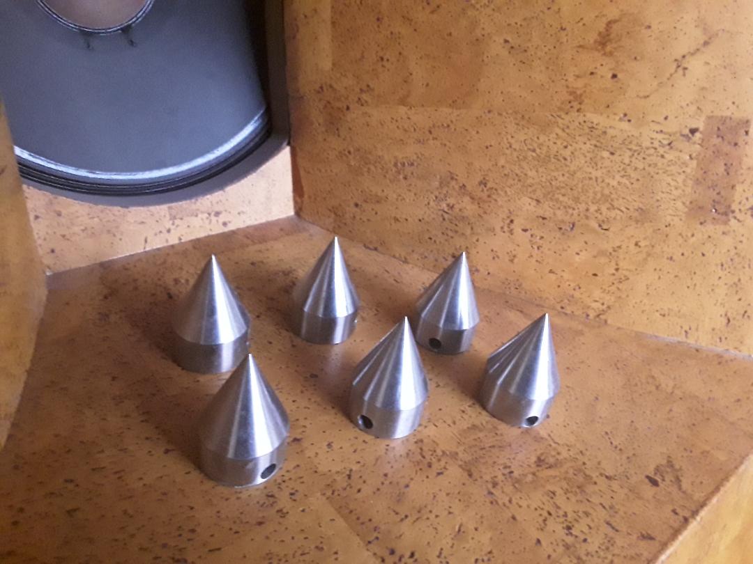

It wont be that difficult to install the stainless steel spikes pointing downwards. On the side they have two holes so a tool can be '' inserted '' to make them turn anti- or clockwise. In the center is a M10 thread so if i use a small stainless steel plate with a M10 welded stud glued to the down side of the bin it is easy to lift up the bins with a simple turn. Just find some piece of metal to protect the cork tiles. I have to lift them just a little more than the height with the wheels so around 3 inches.
NOT sure if i do have 2 more points otherwise i will need to use 3 . I think 3 will have better stability , anyway it will be easier to create one '' level ''
