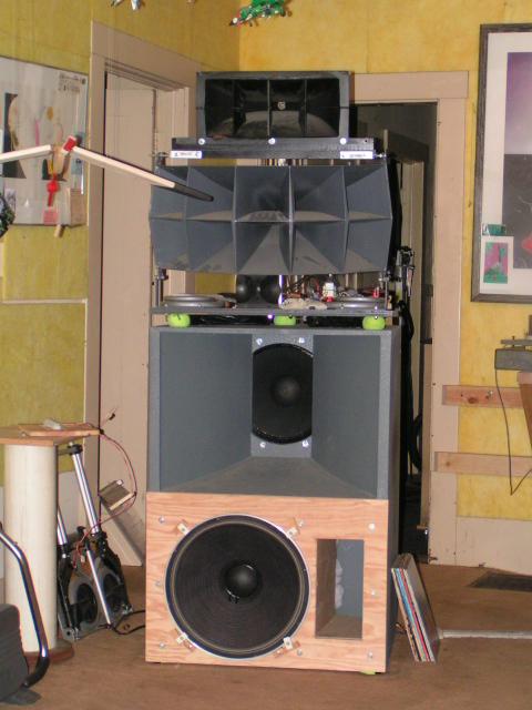

Here's a pic of one of the conversions, but I forgot to list whose it is. 🙁

That looks like something Cal would build!
No ****! As soon as I saw that I had to go look in my speaker room to make sure I hadn't just forgot about it. 😀
Funny thing is, I could just about dupilcate that with product on hand.
