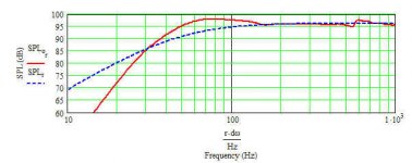

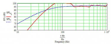

AJ's comment on the drawing is 'flat' to 61 Hz, which if placed well away from any boundaries is probably true on average, IOW he tuned it to have built-in baffle step, ergo somewhat under damped and if tube driven would be even more so:

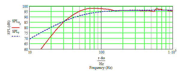

carcass said:Well, I'm guessing that graph from GM was from the Andrew Brandon's Afterburner own version (am I guessing right GM?)
I wonder what would happen if those were close to corners![]()
Greets!
No, 'AJ' = Andre Jute, ergo it's his 'Impressario'. It should be unbearably 'boomy' without increasing the vent length considerably.
Actually, the Afterburner was one of the first designs I simmed with MJK's PORTED WS when it came out:

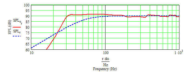

Greets!
OK, but by itself doesn't mean much 😉:
GM
