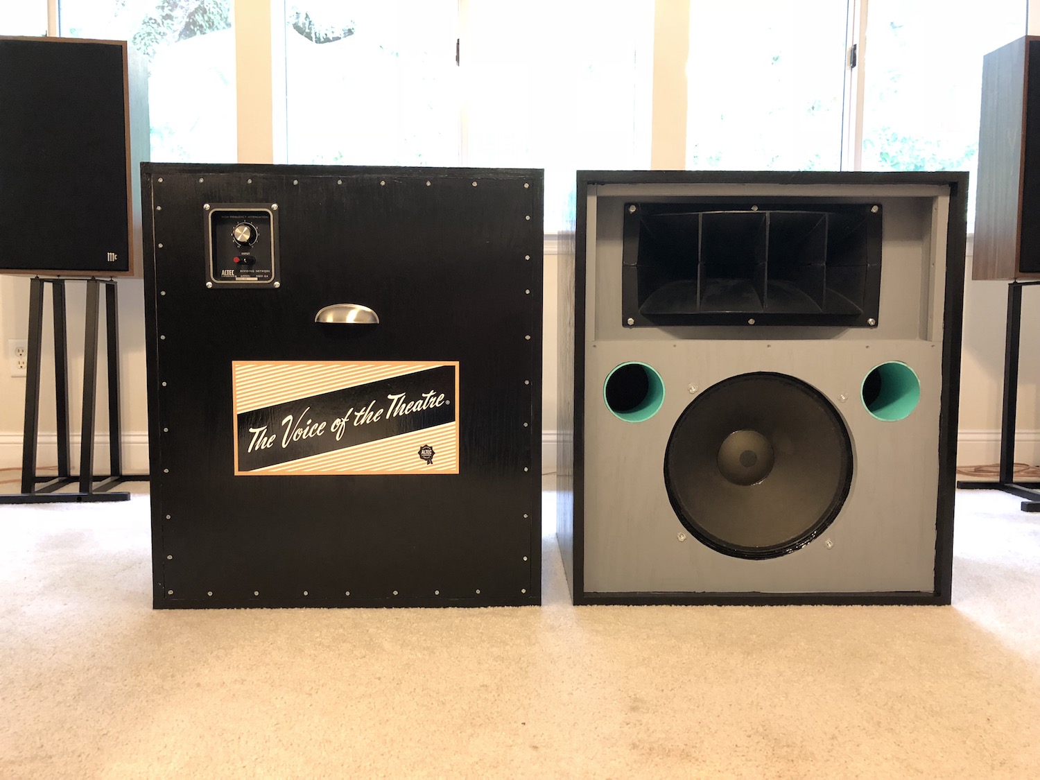

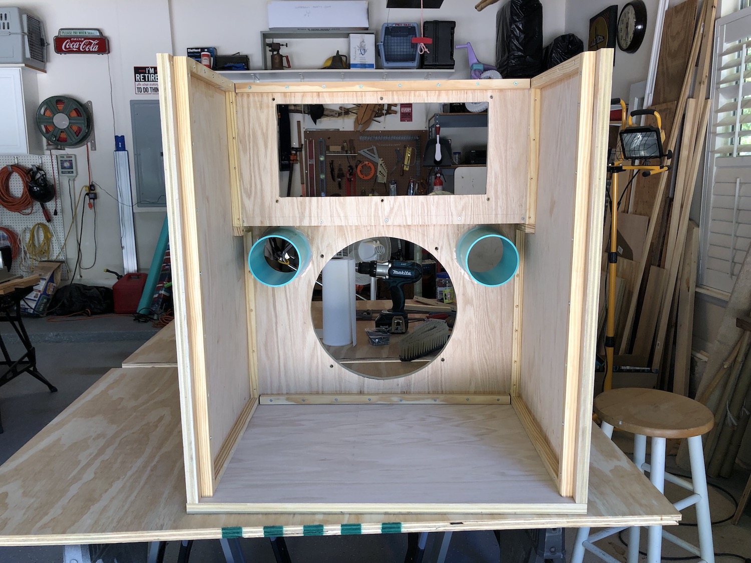

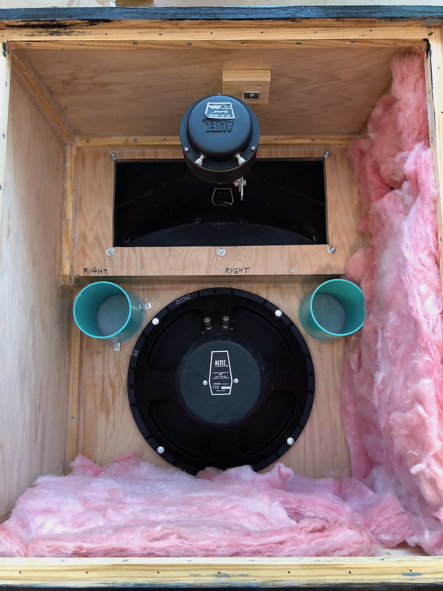

Finally finished up my Altec-Lansing Valencia wannabe cabinets. I made them from some nice red oak 3/4” plywood that I found at Home Depot. It seemed to be good quality with very little voids in the layers. Did the cuts with a circular saw using a Kreg Accu-Cut guide, which worked out really well. Nice straight edges and good square joints. I screwed & glued cleats throughout and just butt jointed the panels. I came back and sealed all of the seams with GE Iron Grip Silicone and then put 2 x 3 stiffeners on the back panels. The result is a really tight cabinet. I had some 4” PVC pipe leftover from another project that worked out perfectly for the ports. I painted them with a good high gloss enamel which turned out pretty well and then stretched some acoustically transparent material across 3/4 x 3/4 frames that fit into the setback.
I pulled the components out of my big A7 cabinets that I bought new in 1971. Everything was in great shape, but I went ahead and changed out the capacitors in the crossovers to a new set of Solen’s.
I drew up the plans for the boxes based on the Valencia specs in the Altec enclosure guide, but not exactly to the micron. I sized them so that the front of both drivers were in alignment without having to cut that hole in the back panel to accommodate the HF driver. I just guessed at cutting the port tubes at 6” in length. Without any further tuning or tweaking they sound great! Overall, I am pleased with the performance since I was worried they would lose a lot of bass without that big folded horn. These cabinets deliver plenty of rich bass and actually seems a bit tighter than in the A7 boxes. There is definitely loss of energy in the very low registers, but I have plans for subwoofer project that should fix that. The only objection I have at the moment is there seems to be a spike in the upper mid range that can be a little annoying on some music. This is not a cabinet issue since it’s all from the HF section of the system, so I will have see if I can work on that next. Any suggestions are welcomed.

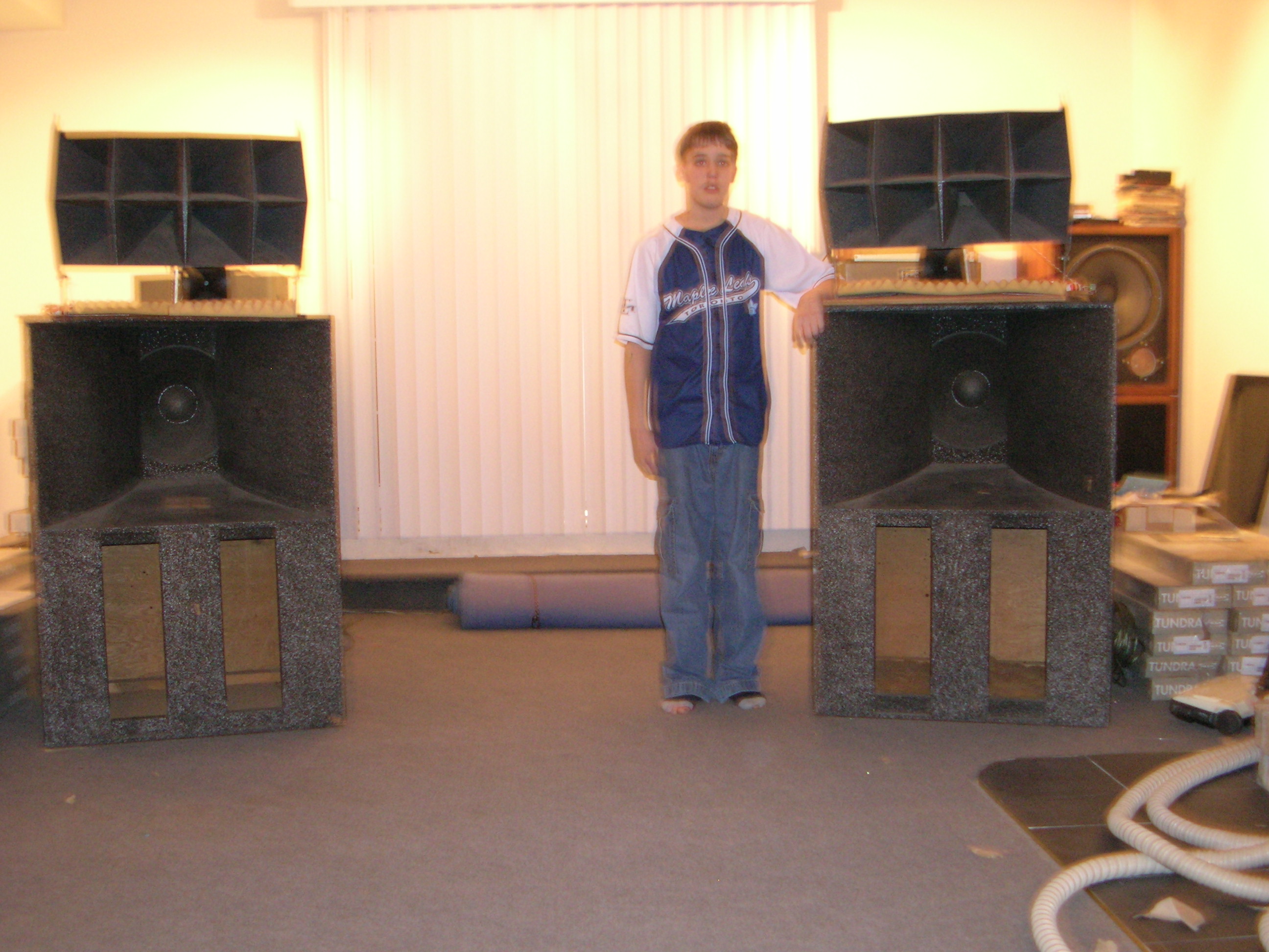

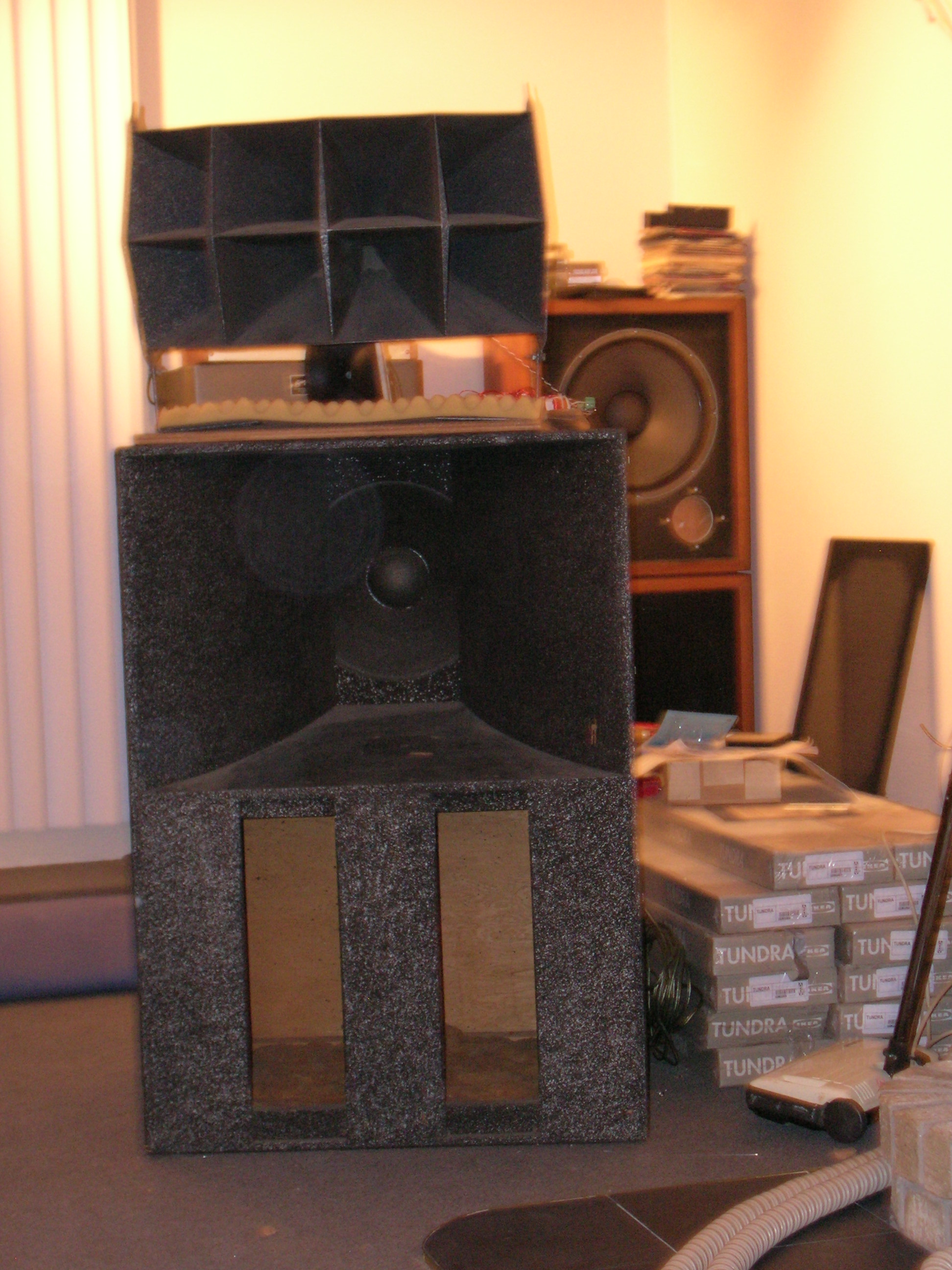

Back in the early 1990s sometime, I acquired most of the original IPC/Simplex/Altec sound system originally installed in the Bytowne Theatre in Ottawa, ON around 1950. 2 IPC amp racks, 5 Altec A5s, and a a pair of 604-8Gs in factory Altec oak cabinets. (There were more 604-8Gs, but I only got 2.) They wanted THX certification ;)
I sold the 604-8Gs to a friend who loved them, for the cost of reconing one of them. Duh. When you've got too much "stuff"... and WAF...
The A5s were loaded with original 515 (no letter suffix) 16 ohm woofers (the ones with the felt and phenolic-harp bolt-down spider), and had 805 multicells with 24 ohm 288B drivers. One had been factory-upgraded to a 16 ohm 288C. Two of them needed the 515s re-coned. These things sat behind a movie screen for 40+ years before I acquired them, so the black 825 cabs, and the original woofer cones, and the horns were all splattered with silver screen paint.
I picked 2 of the best original A5s for my basement "family room/man cave"-- a 16' x 26' x 9' slightly irregular room. Tweaked crossovers closely based on the Hiraga A5 crossover published in Sound Practices way back, by Jon Stronczer as I recall...added a pair of JBL 2404h tweeters above 10k... added a pair of sealed EVM15 woofers below 70Hz with a Linkwitz transform flat down to 20... drove the subs with a home-brew SS amp, drove the mains with a pair of the IPC AM1027 6L6 tube amps.
and we had... "The Arm".
"Don't go down there and start listening to music, you'd better be serious, The Arm'll get ya... resistance is futile". More times than I care to recall, an "early evening" of listening to some Steely Dan and Pink Floyd morphed into greeting the sunrise with Berlin Philharmonic Strauss Waltzes or the Telarc 1812 Overture...
We could do real live-concert levels in that room, and when I put a scope on the AM1027 outputs and monitored power levels to the A5s, we might have hit occasional peaks of 4 watts per channel :)
Long story shortened...10 years ago I sold that house, moved to a place with smaller rooms, and the A5s got bartered away. I still have the IPC racks and amps- 6 AM1027s, 1 AM1026 (plus all the iron to build a twin for it), and an AM1029 SE projection booth monitor amp.
I'll never forget the sound of those Altecs. I'll soon have a new listening room, smaller (12' x 20') with WAF in full play, figuring out how to best apply a pair of JBL 2204, a pair of 2426, and a pair of Hartley 18" woofers (those get IB'd from the attic :) )
I've followed just about everything Earl Geddes, Wayne Parham, and Evan (Zilch) Flavell have opined on over the past decade or so... I guess I'm moving into 3-PI territory. but I'm still jonesing for Altec multicells.
Here's a couple pics from the old place- sorry my old Nikon 5100 refused to auto-focus properly in that room- I almost believe the Altec multicells screwed with the ultrasonic AF... That's my son standing between the speakers in the middle pic :)
Cheers, Altec afficionados!

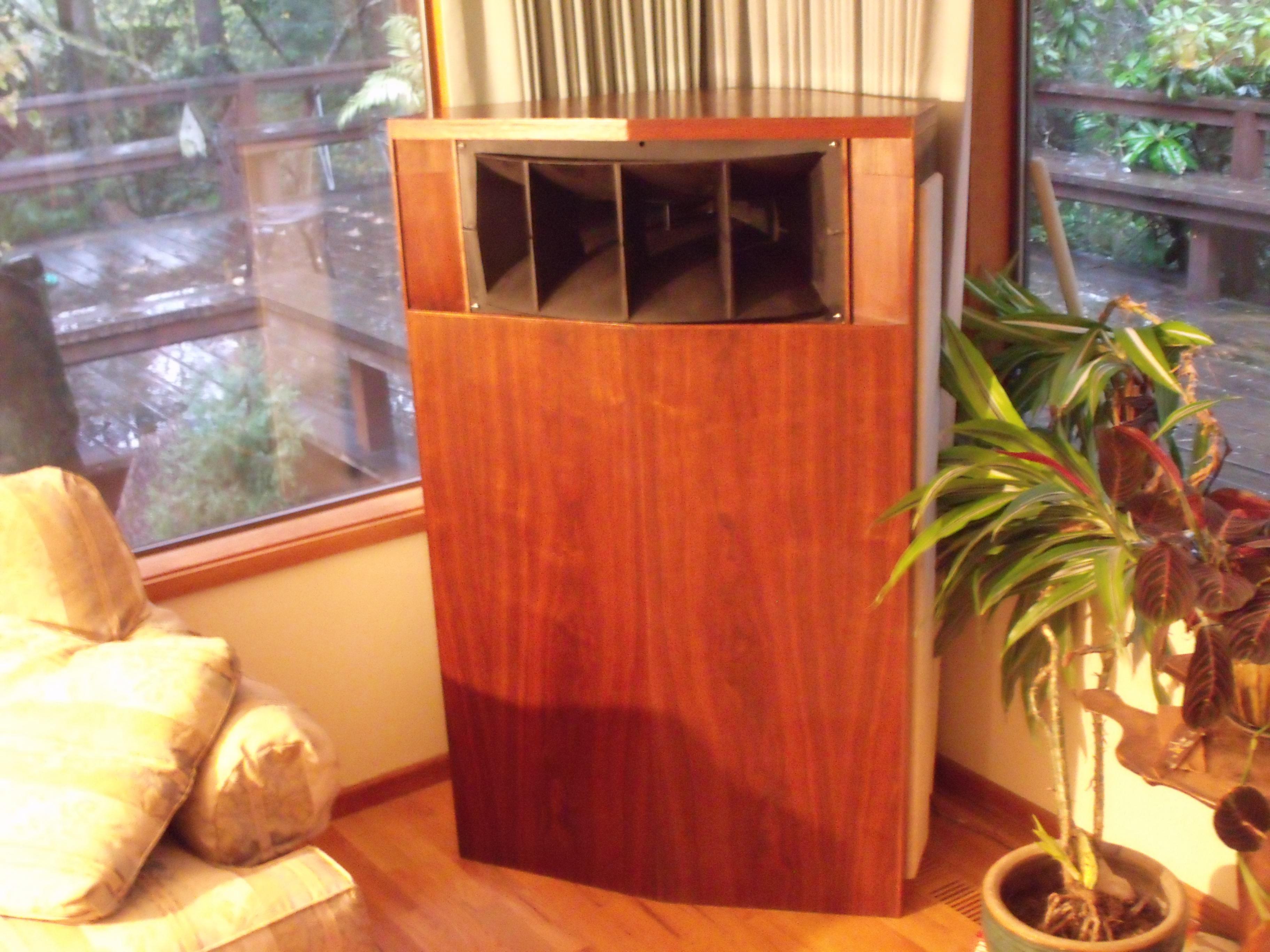

I think I've posted this somewhere other than the altec thread. This is my home made k horn = a pair. (actually electro voice georgean from their plans) speakers are altec vott== 15" bass and 511 horn. Outer cabinet is walnut plywood
Due to the many compound cuts, and many pieces, I would not recommend actually building these- unless you have a lot of time to spend= and lots of room in your house. I drive these with a home brew amp each channel p=p 6l6. Just barely crack the gain control!
