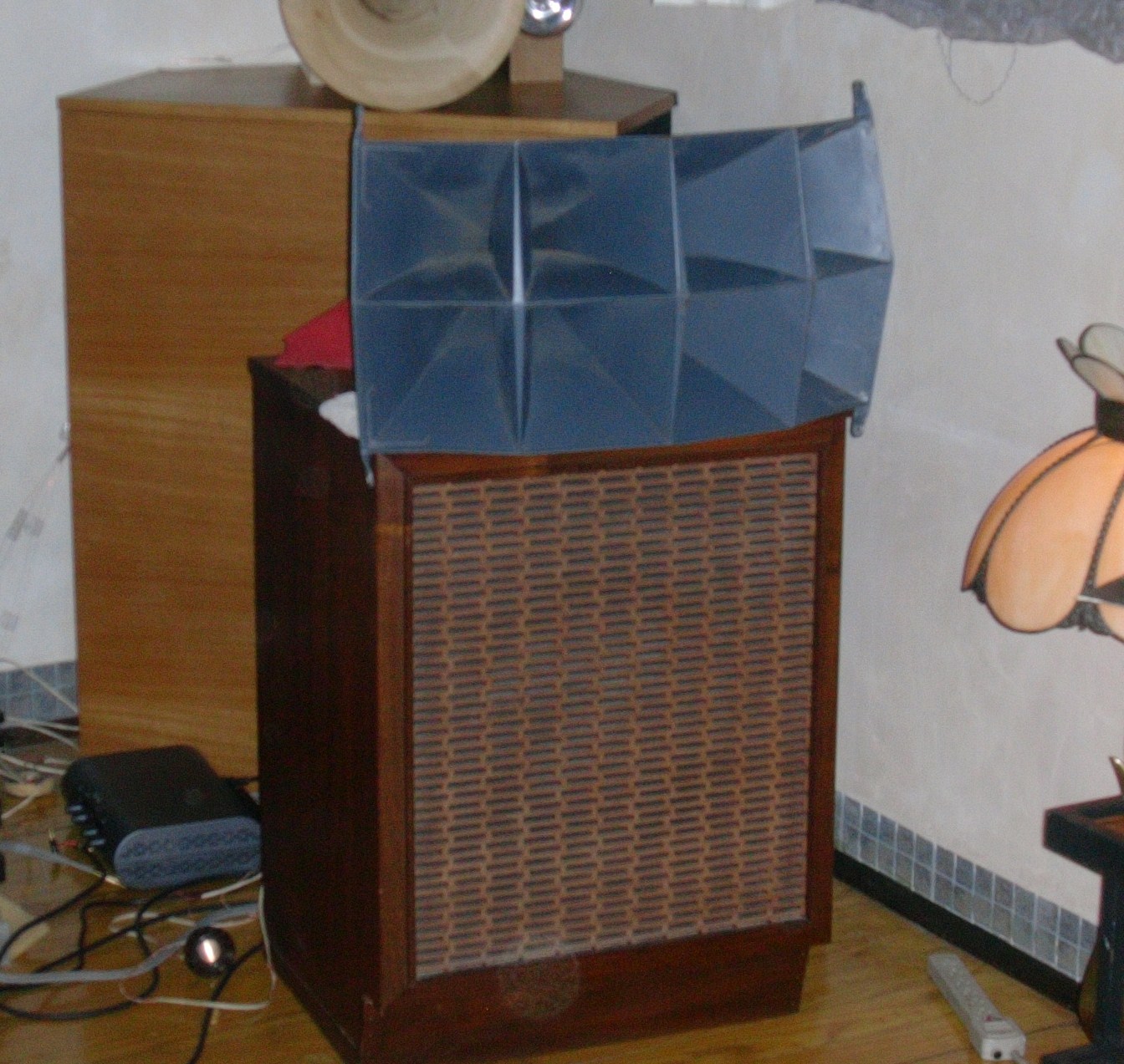

I've got 805B horns and those are really pretty. They do sound a lot "lighter"and more open even without messing up with crossover (except L-pad) which is 800 hz 12dB on woofer and 6dB on tweeter with 90354 altec EQ . I will try Hiraga EQ tomorrow.Boom (60hz) on bass is an issue but midrange is nice.Yeah, it was worth to try those horns. I'm "scheming" to buy and hoard them but $$$🙁. I wonder which woofer would do in 5 cu.ft, maybe 414-16B?
I have 511 with 802d and with altec EQ circuit they are more or less acceptable in my space but I wonder if 805 horn (288c driver)would work better in this particular sytuation where pin-point imaging is not a goal but wide distribution of sound is desirable.

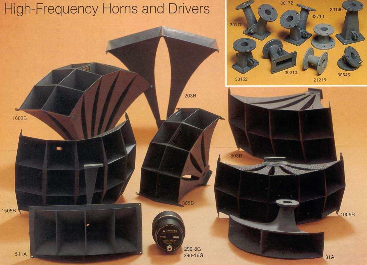

The 511 is a mini-805 in approximation, so the main difference is the 805's 'fuller' bottom end due to its larger driver/throat, mouth area and further 'throw' due to its greater axial length. The former limits its HF response and the latter works against it for typical HIFI/HT apps since its greater size means it has greater directivity over a wider BW than the 511, so actually has a slightly 'tighter' pattern.
Even the 511 is too long for most typical listening distances if mated to a point source since they will decay over short distances at different rates, though staggered XO points helps somewhat. From this we see that WRT coverage angle the 811 is the better choice in typical HIFI/HT apps and pure waveguides designed for the app is best.
FWIW, I found that stacked 511s with the upper driver rolled off yields a better '805' overall plus has more vertical directivity down low.
If you need a wider sound-stage than an 811 yields, then a > 90 deg horn such as a 1005 or even 1505 is required if you want Altec, but their HF response requires a super tweeter horn for best performance over typical HIFI/HT listening distances.
