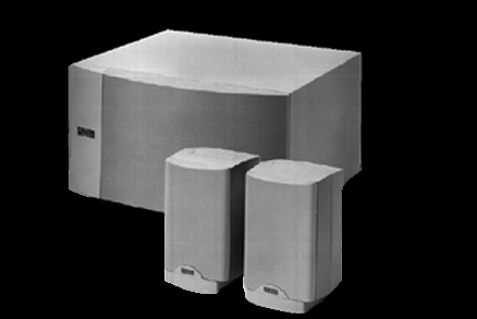

I know these speakers are pretty ancient, but I love my ACS48s. I mistakingly allowed my roommates to use them for our party last night and when I hooked them back up to my computer I noticed that I had no midrange. I'm pretty much a total noob when it comes to this stuff, but obviously my midrange drivers must blown. The tweeters are fine and so is the sub, just nothing coming out of the midrange drivers. Does anyone have any suggestions as to replacement drivers or is it just not worth it to fix? If the latter is true, any suggestions as to what speakers I could buy that would be comparable to these? Also, I'm on a pretty tight budget as of now, so keeping that in mind, any ideas?

Take out the 3" drivers and replace them. Check the impedance
and the mounting style and get suitable replacement drivers. e.g.
http://www.partsexpress.com/pe/showdetl.cfm?&Partnumber=289-084
http://www.partsexpress.com/pe/showdetl.cfm?&Partnumber=297-427
http://www.partsexpress.com/pe/showdetl.cfm?&Partnumber=297-428
http://www.mcmelectronics.com/product/LS00119
If they do not fit possibly 3.5" car speakers might fit.
If all else fails get two new passive satelliites for use with the sub.
/sreten.
Given your other post an upgrade may be possible with more details
of the driver to be replaced (pics) and details of the crossover (is it
more than a single capacitor on the tweeter ? not very likely though.)
/sreten.
