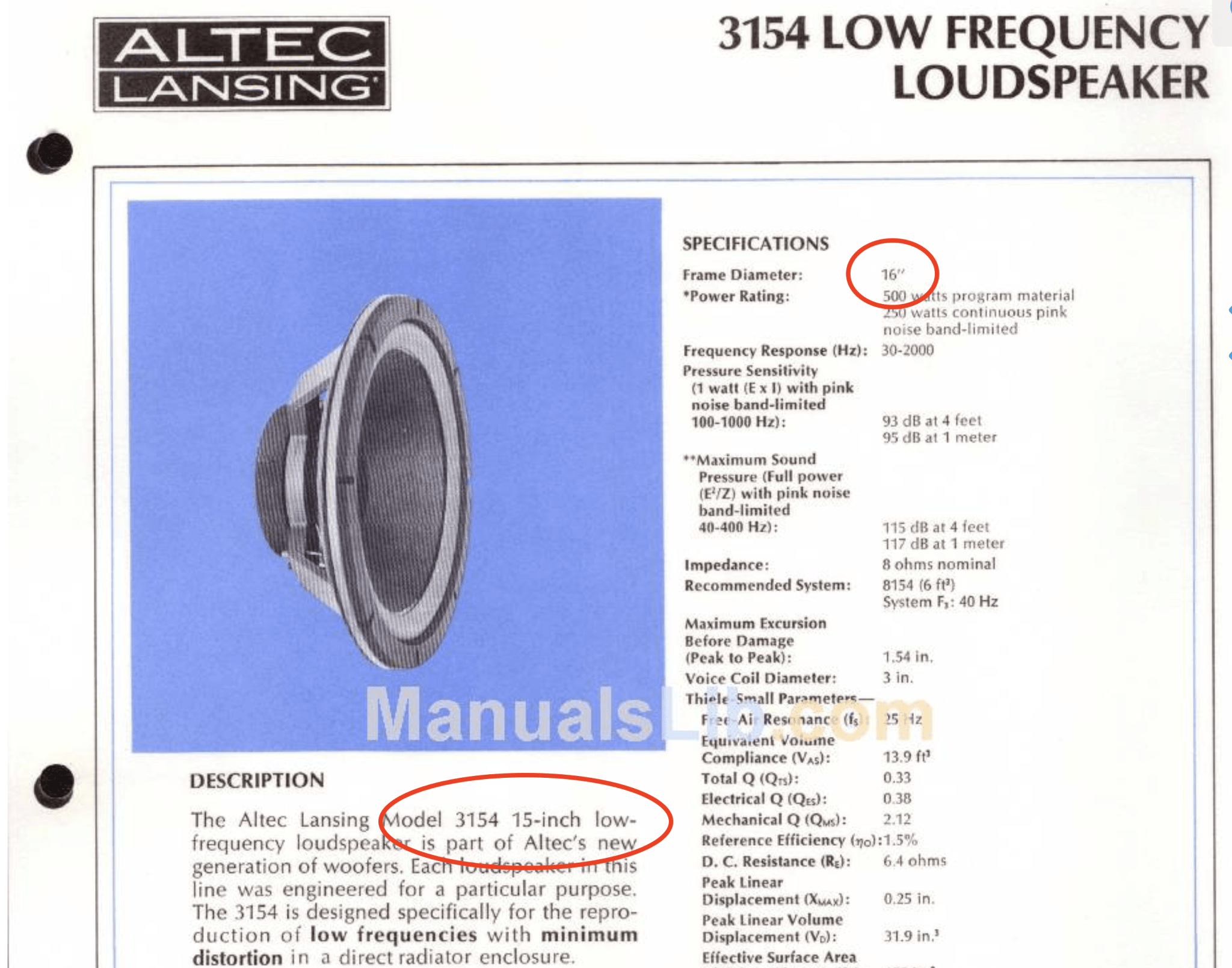

Thank you very much. Are there two sizes of 3154 woofer ? 15" and 16" ? The speakers are still working, behind the screen (in a cinema theatre), and not easy to access to.
As a quick solution and easy to find, what do you think of this one : JBL M115-8A ?
Yes. The Altec 16” is really a 15”. The cone is the same as other 15’s but the frame is a little larger. Altec’s own literature calls it a 15 and shows the frame as 16.

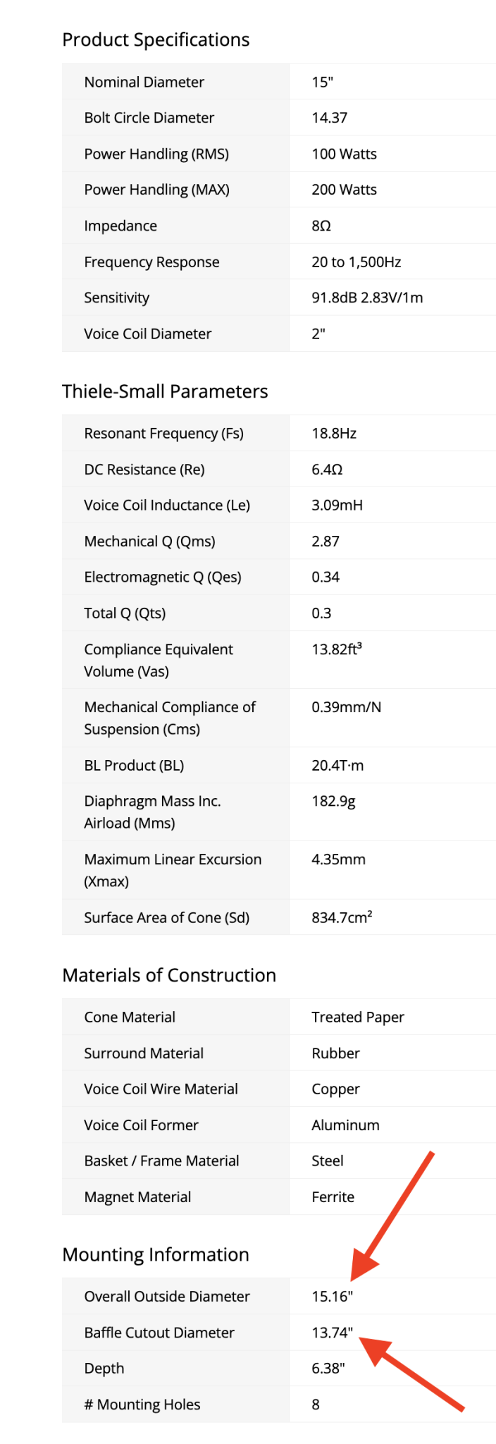

The Dayton DC 380- 8 Classic 15” woofer has good numbers as a replacement, but the baffle cut out is smaller than the Altec so you would likely have to angle the screws to get a decent bite and of course you would need a gasket.
Right, it's just the way you phrased it had me remembering the 16" frame's bolt holes are on 15" centers, so wondered if that was what you were referring to.
