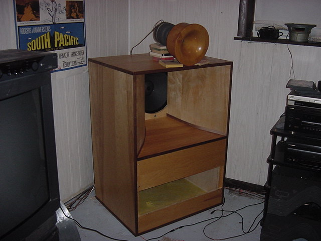

Preliminary Listening Report
Preliminary Listening Report!
Good!
Maybe even very good!
The rear panel isn't exactly solid on yet, since once on it won't come off due to the Mortite putty for sealing will hold it on very well once squished fully by the screws.
I have decided to build in "screw jacks" on the panels so that the panels can be pulled without screwdrivering the cabinet in futile attempts to get them off... insert 1/4-20 (US Coarse thread) bolts and tighten, it pushes the panel up and out...
Anyhow, the thing goes low now. Thank goodness!
After a minor adjustment to the secondary rolloff on the xover for this driver, it sounds very very nice indeed.
Measurements indicate the -3dB point with (gasp) 4 x 4"dia x 16"long ports to be smack dab on the predicted 30Hz. point.
The response seems nicely smooth, +/-3dB from 30Hz. up to the tarket freq of ~275Hz. whereupon it dives like a stone, as it should due to the very extreme xover slope.
Stanley Clarke sounds very articulate and solid. Warm without being heavy or thick. So far nothing has sounded bad or problematic. Which is a great relief actually. Drums sound fast and dynamic.
And, the cabinet panels are not fully screwed in and sealed, the ports are friction fit, some absorptive material is yet to be installed (about 10% worth), the flares are not yet stiffened and damped, and technically speaking the throat adapter plate is not sealed to the mounting surface either (although it is a dead flat fit now).
For the stiffening, after much thought and staring at the inside of the flares, I decided that the way to go was cast-in-place stiffening, which then gets glued in place, the edges finished after gluing with more cast-in-place compound. I went with a 4:1 mix of sand to "floor leveling" compound (which is a hard gypsum material I believe), water mix. Dries hard as a rock. Stiffness is my main criteria on these thin plywood flares. After they are stiff, damping is simple, if needed. I want the bass energy going out the port and out the front, not modulating the walls of anything, or leaking out gaps.
The foam surrounds on these woofers have been doped with professional compound made for foam. I may have some available... fyi. Check my website soon, or email me.
So I can safely expect only improvement. <sigh of relief>
This is a night & day change from the stock unit.
The client will be happy...

Several years ago I had new 825s built by a pal who is a cabinetmaker. They were built with high grade 3/4" plywood with extra bracing for solidity.
They were built with substantial braces between the horn flares and the sidewalls.
They were loaded with 515B woofers. I never worrried about bass response because I valued VOTs for their reproduction of 100-10,000hz, below 100hz i simply augmented them with a pair of JBL Pro bassbins.
In my experience the 511 horns are amply damped by application of non-hardening modeling clay to the lips.

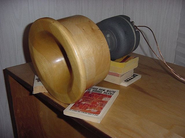

Tom, your picture shows a small wooden HF horn. What is it and where do you set your crossover at?Tom Brennan said:They were loaded with 515B woofers. I never worrried about bass response because I valued VOTs for their reproduction of 100-10,000hz, below 100hz i simply augmented them with a pair of JBL Pro bassbins.
That's a Bruce Edgar tractrix "saladbowl" horn. I used them with JBL 2420 drivers and crossed around 700hz. Very nice sound.
I used various top ends with those bassbins, IMO the best was Altec 288K drivers on old tar filled 1005 multicell horns.
That “salad bowl” horn looks rather small compare to Altec’s 811B horn which is designed for 800 Hz at the lowest. I just didn’t expect it to play down to 700 Hz. Just wondering, is output level consistent across the driver’s range with that horn?Tom Brennan said:
Even----That's a 550hz horn. But with tractri you should crossover higher than the theoretical cutoff so I did 700hz.
The horn with the 2420s had even response and with it's narrowing dispersion with increasing frequency had pretty extended highs, measured flat out to 16khz as I recall.
They can be quite natural sounding horns, depending on the things that must be depended on.

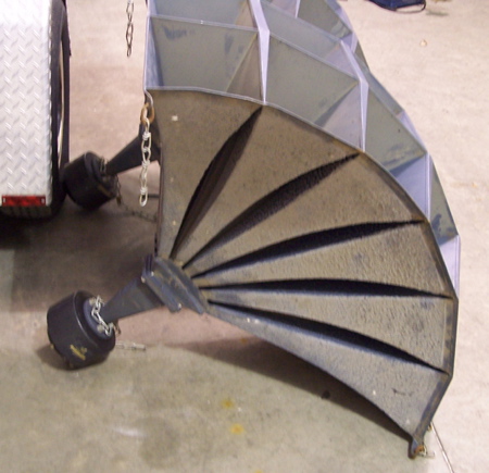

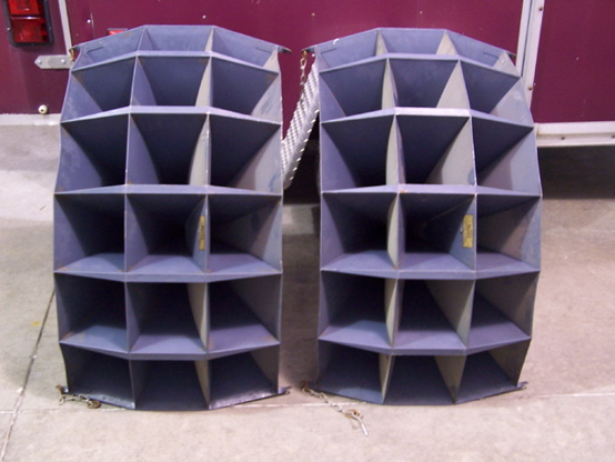

I am hoping to receive a set of 1803 horns with 288 drivers in a couple of weeks. If so, you might not see me for a while. I'll be out in the shop just staring at them. 🙂
Cal Weldon said:I am hoping to receive a set of 1803 horns with 288)
Ow! Ow! You're killing me, Cal! The 1803s rule.
I hope you have help to move those mosters around.
Fun times in Canadaland!
Some people think those are the best sounding horns Altec ever made. I love the 1505s and got to hear the 1803 only a couple of times. Was very impressed.
So you already have the 288s, or are they coming with?
It would be great fun to try other drivers on those horns. The 1808s will not be the limiting factor, the driver will. Could be very informative. I may want to come up to Canada and play in your garage some day. Some summer day. 😉
