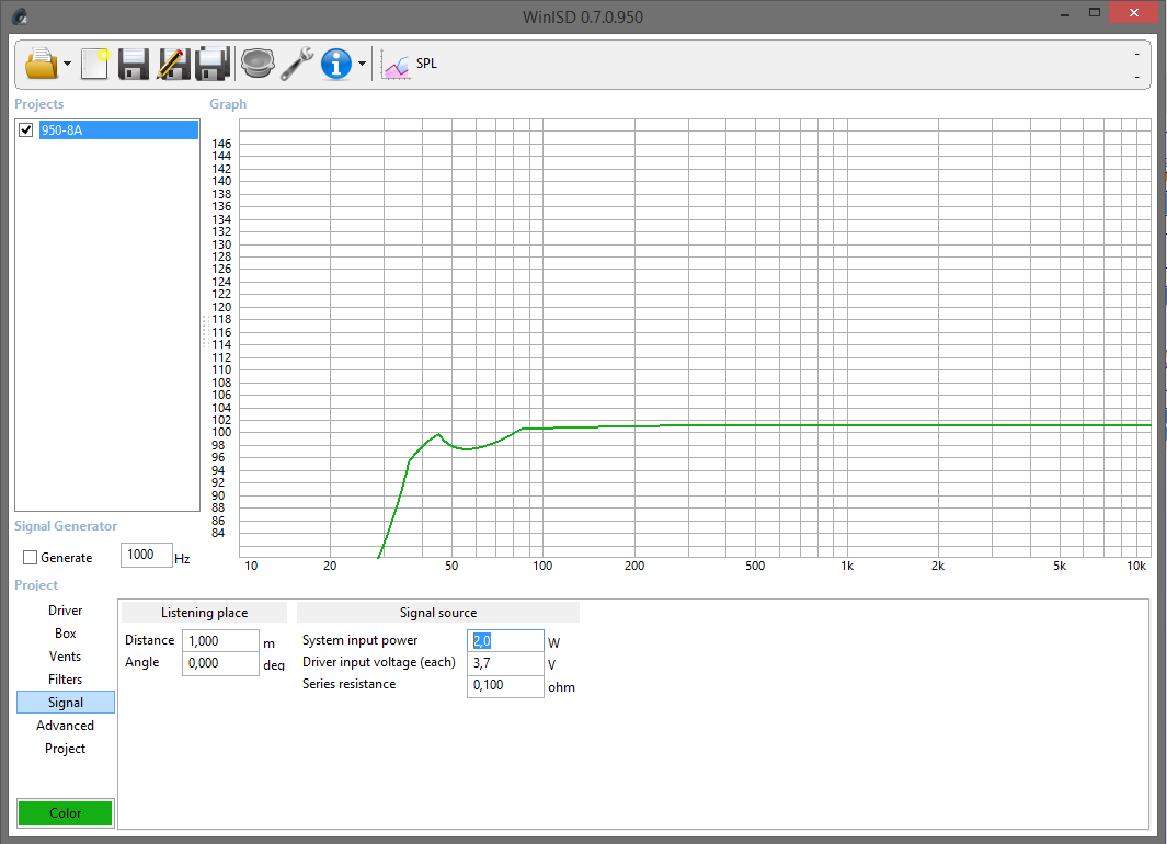

I was lucky to get my hands on a pair of Altec PS-95 speakers. These cabinets use the 15 inch Altec 950-8A coaxial drivers.

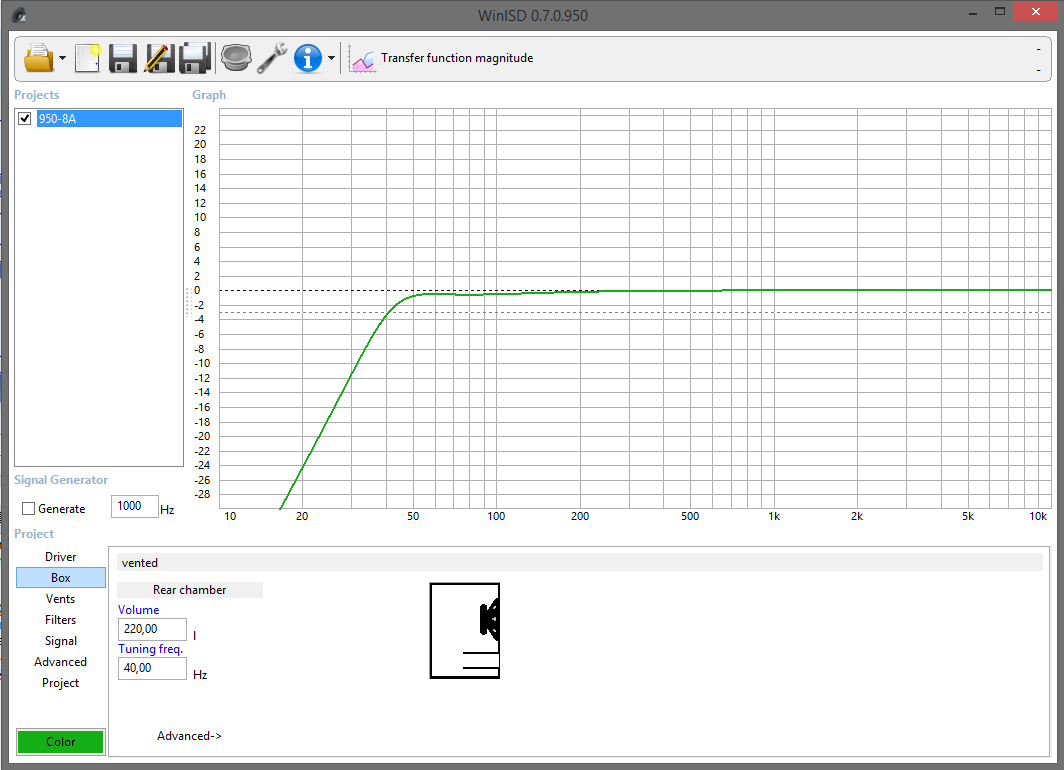

I have tried to add the parameters of the Altec 950-8a to WinISD but I am not sure if what I did was correct and if WinISD is the right program for this. Can somebody please confirm that a 300 liter cabinet like WinISD seems to suggest may result in a better extended bass or are is there anything in the parameters that suggests that it's not a good idea to try to go so low with these coaxials?

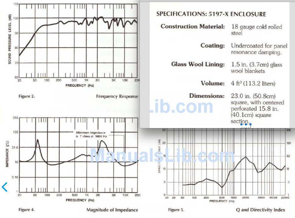

I ask this because the folder says that this coaxial speaker is specifically designed to work in a 4 cubic feet cabinet. Does that mean that it is not possible to get more bass out of these drivers although WinISD suggests otherwise? Any other cabinet idea's for these drivers? I also loooked at the Altec Milestone 950 cabinets.
Any help is very much appreciated!

1) In these closed cabinets there is not much bass below 100Hz and I would like to build a bigger cabinet for them to improve that.
2)Can somebody please confirm that a 300 liter cabinet like WinISD seems to suggest may result in a better extended bass or are is there anything in the parameters that suggests that it's not a good idea to try to go so low with these coaxials?
3)I ask this because the folder says that this coaxial speaker is specifically designed to work in a 4 cubic feet cabinet. Does that mean that it is not possible to get more bass out of these drivers although WinISD suggests otherwise?
1) The specifications for the 4 cubic foot 5197-X indicate it is ported, not sealed. A sealed cabinet of that size will definitely roll off bass.
2) For a low tuning, that size seems reasonable.
3) A 4 cubic foot cabinet with a tuning (Fb) of around 55 Hz from the perforated 15.8 square inch perforated port results in a fairly flat alignment to 70 Hz, rolling off below. You could use a lower Fb (longer port) in a 4 cubic foot cabinet and extend low frequency response, though it will roll off steeper than the larger cabinet above Fb.

@ Weltersys: Thanks a lot for your help!
The closed PS-95 cabinets that I use right now are about the same size as the recommended 5197-X cabinets and they roll of bass for sure. As the 5197 cabinets are ported they might have a fairly alignment to 70Hz but i'd rather go even lower then that because I don't want to add a subwoofer. The coaxials will be used for music only so if I can get the bass down to around 40Hz then that would be great.

Not to dissuade you from the larger cabinet, but it would be worth trying/modeling an external port with your present cabinet volume.
An Fb around 40 Hz would get you most of the output of what the larger cabinet would give, and only require installation of a chunk of PVC and an elbow on the back of the cabinet.

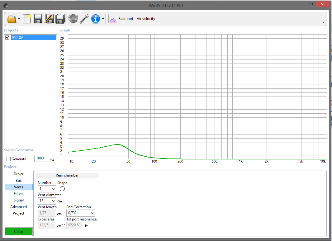

1)Your driver does not have huge displacement, so the port does not have to be super large to avoid chuffing (too much vent velocity), around 5" diameter duct would be OK. Port area as large as the cone area could be used, but would end up with a very long port.
The larger the port diameter, and the lower the tuning, the longer it needs to be.
For your small box, probably shoot for around 40 Hz Fb, much lower and the bass will roll off too much to be of much use.

This driver won't give much bass when you give it more than a few watt as the xmax is very limited. But it's high efficient so that won't matter much in home use.
I come to a 220L cabinet with a 13cm diameter circular hole in the box (port of 18mm) when using 18mm wood. That gives a tuning to 40hz and is good for a response to that for maybe 3w with bass, after that it goes in overexcursion to much to give bass (and it will cut of). 2W gives already an SPL of 100dB per cabinet (103dB for a pair) wich should be more than you will use in an average home...

Sorry for my late reply. I have learned a lot here and I want to thank you all for your advise!
I think I will start with building 220L cabinets out of 12mm mdf sheets that I have laying around. This is for testing only of course as the end version will made out of 18mm birch multiplex. If I am not satisfied with the 220L test version I will still have enough MDF left for a 285L (Vas/1.44) test version. Can't wait to hear them in bigger cabinets to hear these Altec drivers in all their glory.

Due to work related stuff it took me a while to build the 220 liter cabinets. I am just about to finish them but haven't made the bass reflex port yet.
WinISD says that I should use one 13,4 cm port with a length of 22mm (I use 22MM MDF) but I think I would prefer multiple smaller ports as this sounds aesthetically more pleasing to me.
If I opt for three ports in WinISD it says I should use three ports of 5.6cm wide (22mm deep). Is there any reason not to go for the three port option? Would it make any difference soundwise? I know the Tannoy Arden uses three ports but it is a totally different driver and cabinet design so I am just curious if it would work in my case.
Hmm, assuming the 13.4 cm dia. vent is required to meet the < ~17 ms vent mach, then substituting multiple vents that equate to the same 22 mm vent length barely sum to over half the area [~141 cm^2 Vs 3x ~24.63 cm^2 = ~73.89 cm^2]!
We want the multiple vents to have at least as much summed cross sectional area [CSA] as the single vent. This of course means the vents must be a lot longer.
